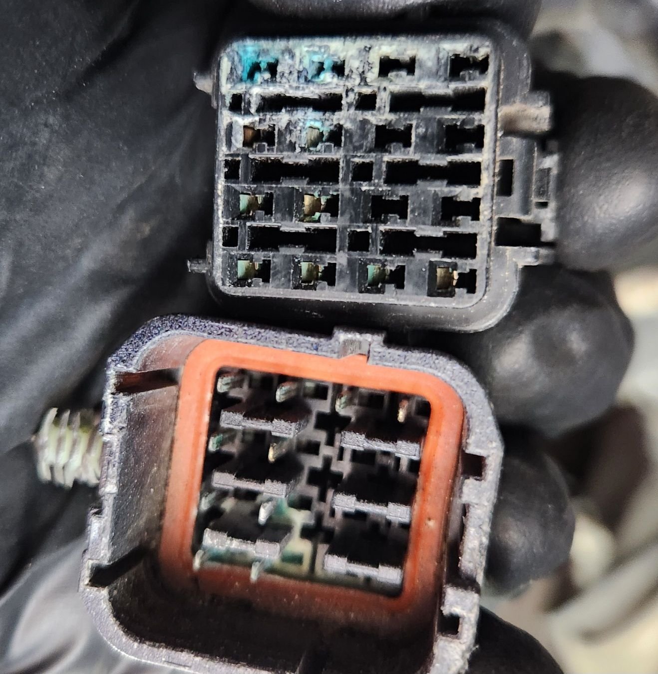

Default TPS Problem Resolved!
I want to thank everyone that contributed some ideas to the TPS problem of my 2015 XJL. Turns out it was not the TPS sensors in the tires or the modules that they connect to. It was an intermediate connector which had been compromised and was corroded. C11 is the connector which connects the front TPS receiver antennas to the front interface/ engine fuse box. It appears the connector was not fully seated and water had been seeping into it for some period of time. Once the contacts were scrubbed, sanded, scrapped clean, and sprayed with some contact cleaner and Deoxit, the warning has not appeared after a few days of driving! Not sure if there is a way to view any information relative to the state of the tire pressure in the instrument cluster but at least I don't have that same warning on the dash whenever I start the car.
I wanted to trace the antennas to where they connected to a termination location. Looking at the electrical diagram, I found the front antennas connected to the "Junction box-central" through the C11 connector. (This connector also joins the front parking assist sensors; the left one was not working on my car as well.) The connector is supposed to be affixed to the back of the front bumper but it was not; just hanging free in the cavity behind the bumper in the wheel arch. At some point,( before I owned this car), someone was fooling around under there and did not secure the connector into place and did not fully seat the connector. Water must have been seeping into there for a number of years I'd guess.
This kind of poor servicing is just not acceptable to me. Always make a quality repair and bring the car back to original condition if at all possible. This would have never happened if someone had merely seated the connector and secured it as manufactured. OK, off the soapbox. Good night!
Diagram attached under the photo.
