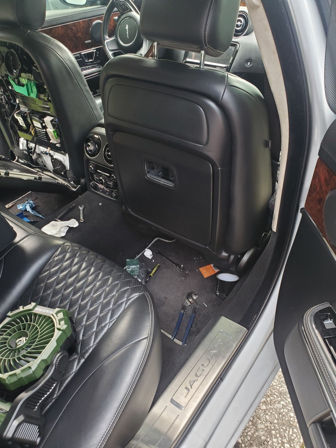

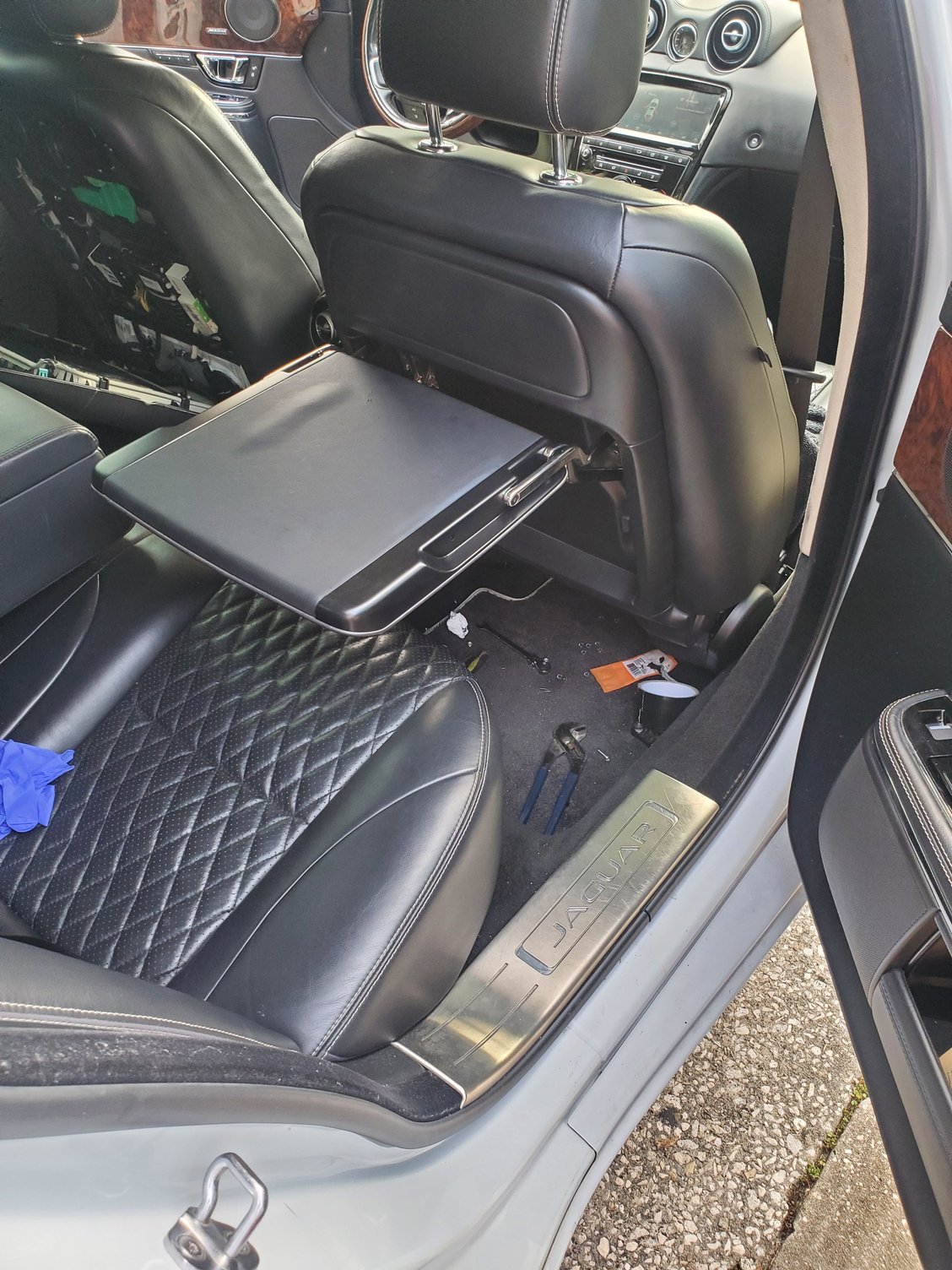

Finished one side 90% today. Just waiting for the paint on the handles to cure.
I'm super happy with the results. All the bolts/holes lined up perfectly..and threaded in with no effort. It pays to measure 2x minimum. Cause I love when everything goes as planned.
My new drill tap should be here tomorrow, and I can finish up the driver side.
What I did to get the holes marked. I temporarily mounted the brackets in place. Put clear tape over the cutouts in the back panel, then put the tray piece in the panel.
Used a qtip and a dap of red polish to mark where the holes are on the clear tape.
Removed the trays then put the back panel on the seats.
Using a small drill bit...I went through the red marks on the tape...just enough to make an indentation into the metal.
Took everything out..the drilled/tapped the holes.

Funny you say that... the wood style trays are what I had originally. I like them as well. Had them in my sister's storage and she accidentally tossed them 🤦🏾‍♂️
Thank you... just finished them today... gotta clean the inside and I'll snap a pic
