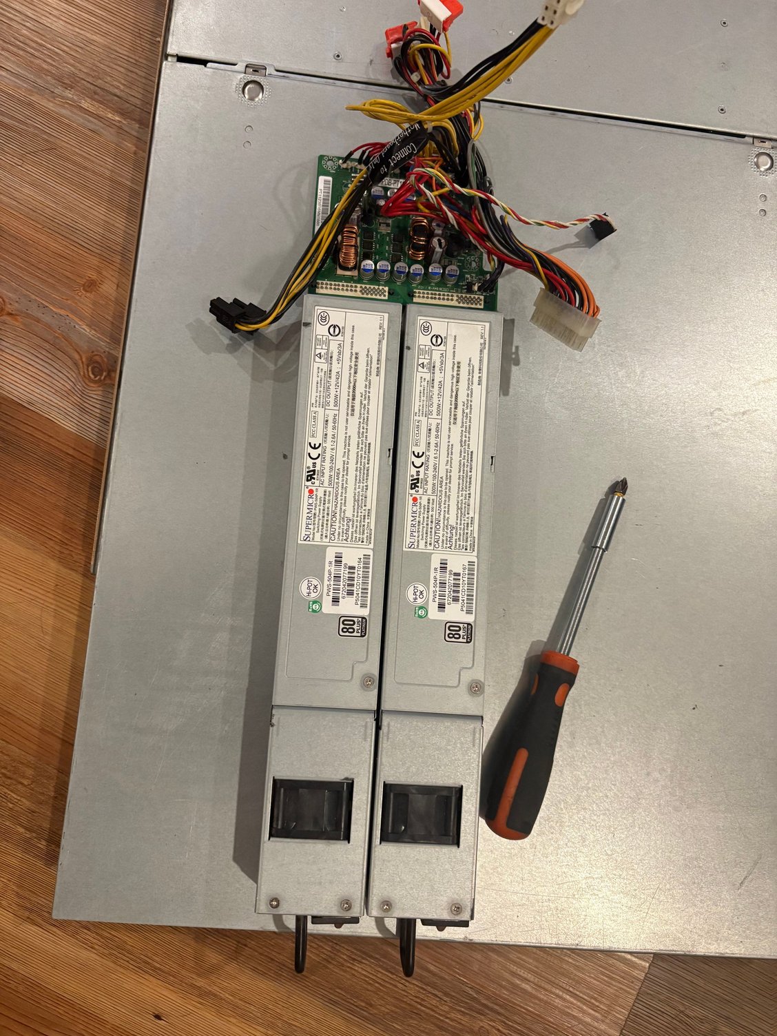

I did some digging around my shop and found a bigger switching power supply. It’s capable of 12V 1000W 84A pulled from an old server.

So I got my dedicated Laptop with SDD Installed, a Bigger PSU rates 82A @12V, so all im waiting on now is the Keys to get delivered and the cable

Does that power supply have a ripple/noise rating? SDD wants <50mv rms ripple.
