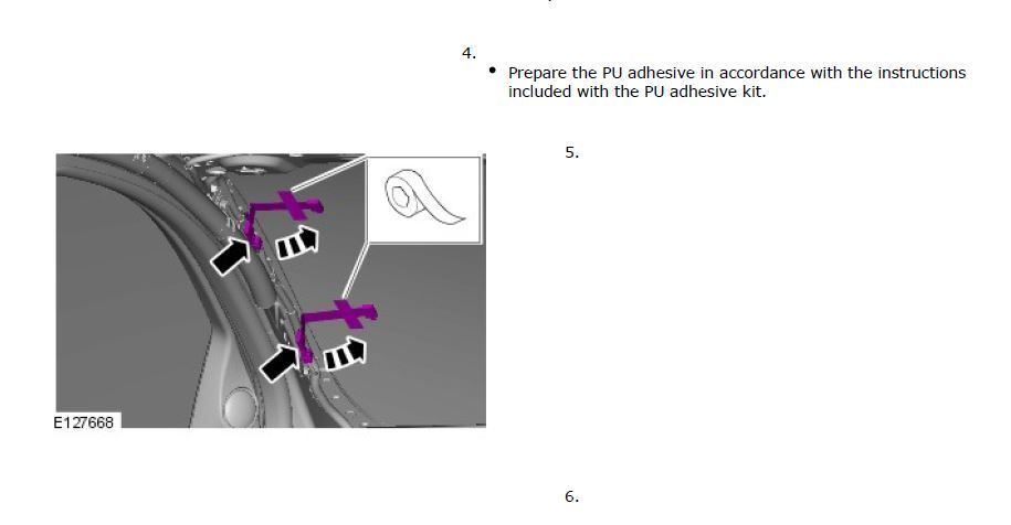

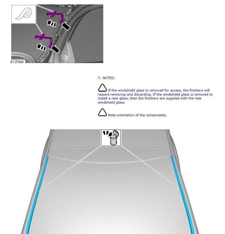

Sorry for no help but these came with the windshield when I had mine replaced on my 2014 XJR?
Safelite first brought out an aftermarket windshield and I was OK with that IF it fitted as factory. The installer was great and knew I was a car guy. But it came without those 2 side trim parts. He called Safelite and said we need an OEM windshield because of this. Too Safelite's credit there was no argument and a factory windshield was ordered and installed.
Here are a couple of pages from the shop manual. They don't offer any instructions except that the finishers come with the new glass?

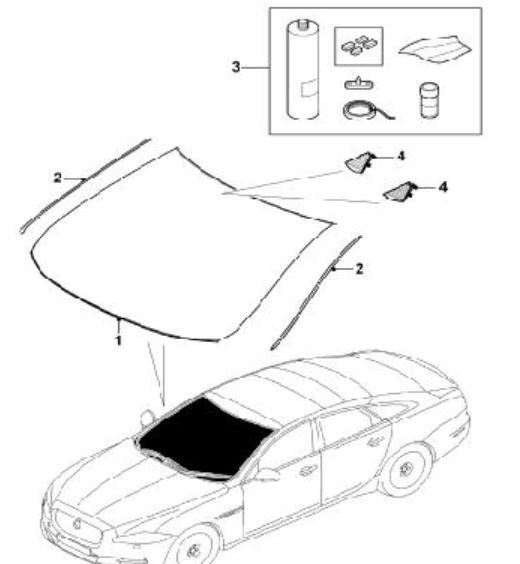

Here is a diagram from the JPART system and it shows item 3?
This looks to be the "PU Kit" mentioned in the above shop manual?
They have two different part numbers depending on your VIN (You did not post the last 6 digits of your VIN?).
The break over was at VIN V90930 which should be a very late produced XJ.
Jaguar C2D7026 and after that it's listed as C2D49241.
This kit is shown as item 3 in your link too. But do note the change with the VIN.

Thanks for this... well I assume because it says that if you remove the glass and reinstall that the trim pieces will have to be discarded, that you can reinstall new trim pieces? I'll have to ask my local dealership one of these days.

Yes that's the part I was never clear on? According to the glass installer they need to come installed with the windshield BUT I am not sure of this and did not witness him installing the windshield either? Jaguar does sell the trim separately so you must be able to replace it without replacing the windshield too?

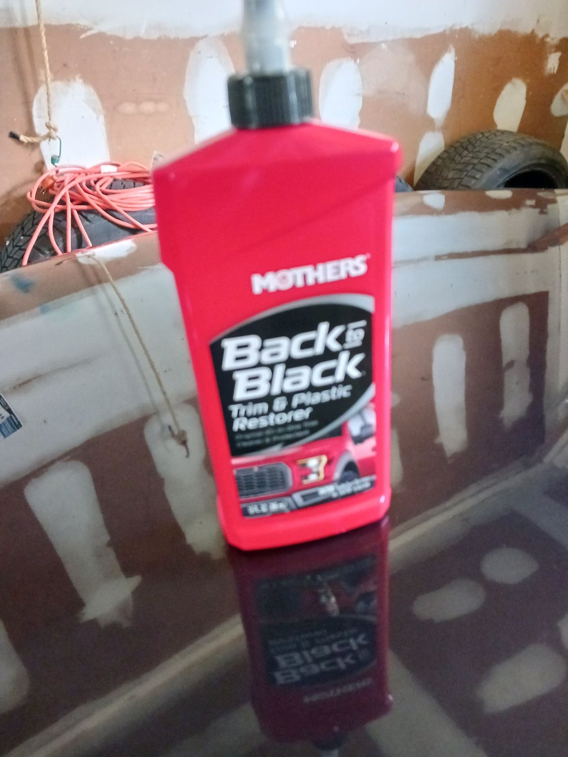

I used a product called Back To Black. Wonderful results!
