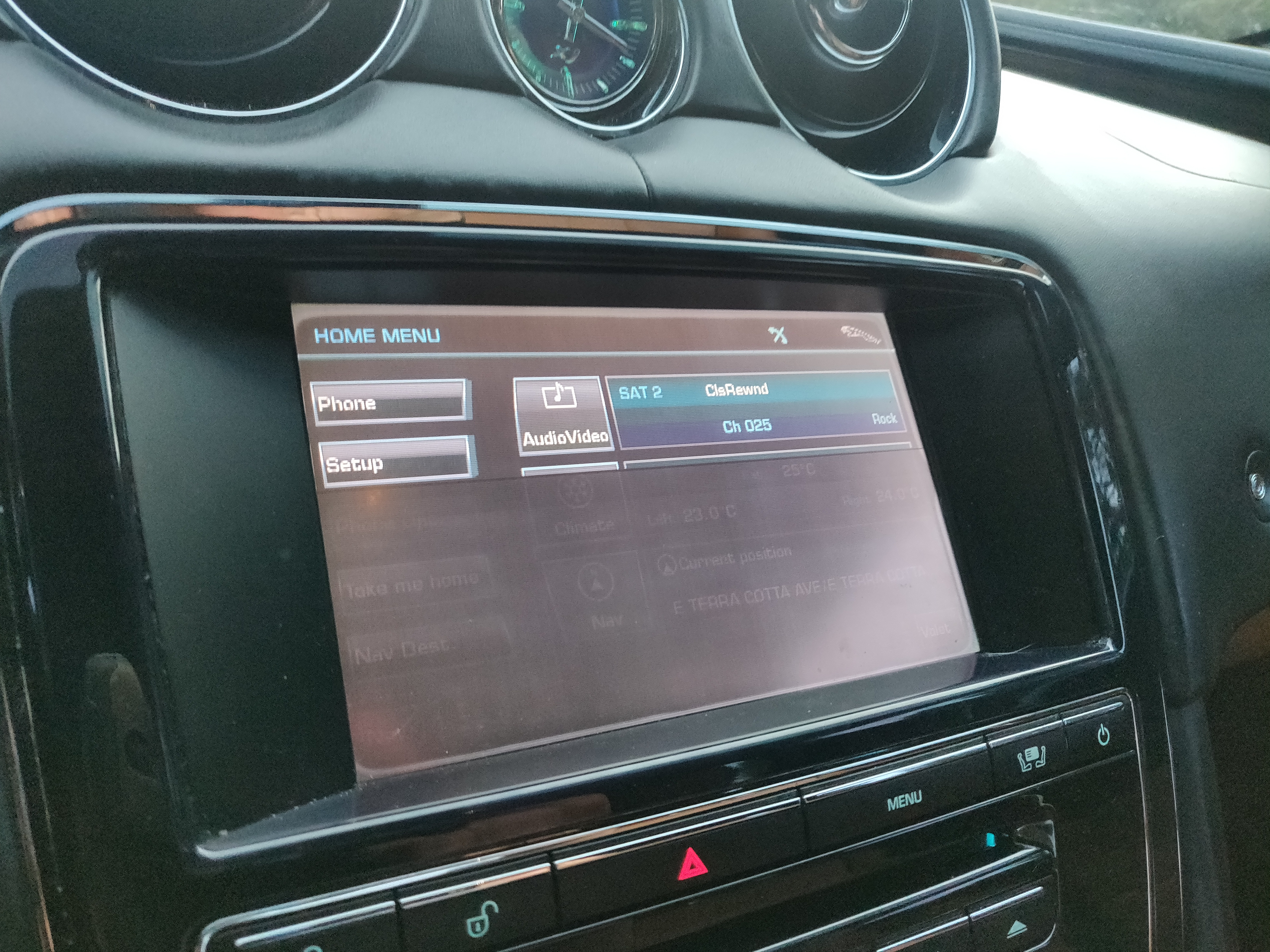

The first sign of issues, the infotainment system started cutting out and restarting while driving. Then, on the drive home, I start experiencing mass electrical problems. Revs drop to zero, transmission cutout, loss of all systems. Stopping and restarting the car would fix things for a bit.
I swapped the battery, and same issues. I did a vehicle reset with SDD, same issues.
The infotainment cutout issues happen even if the car is not on.
Any idea on where to start for this?

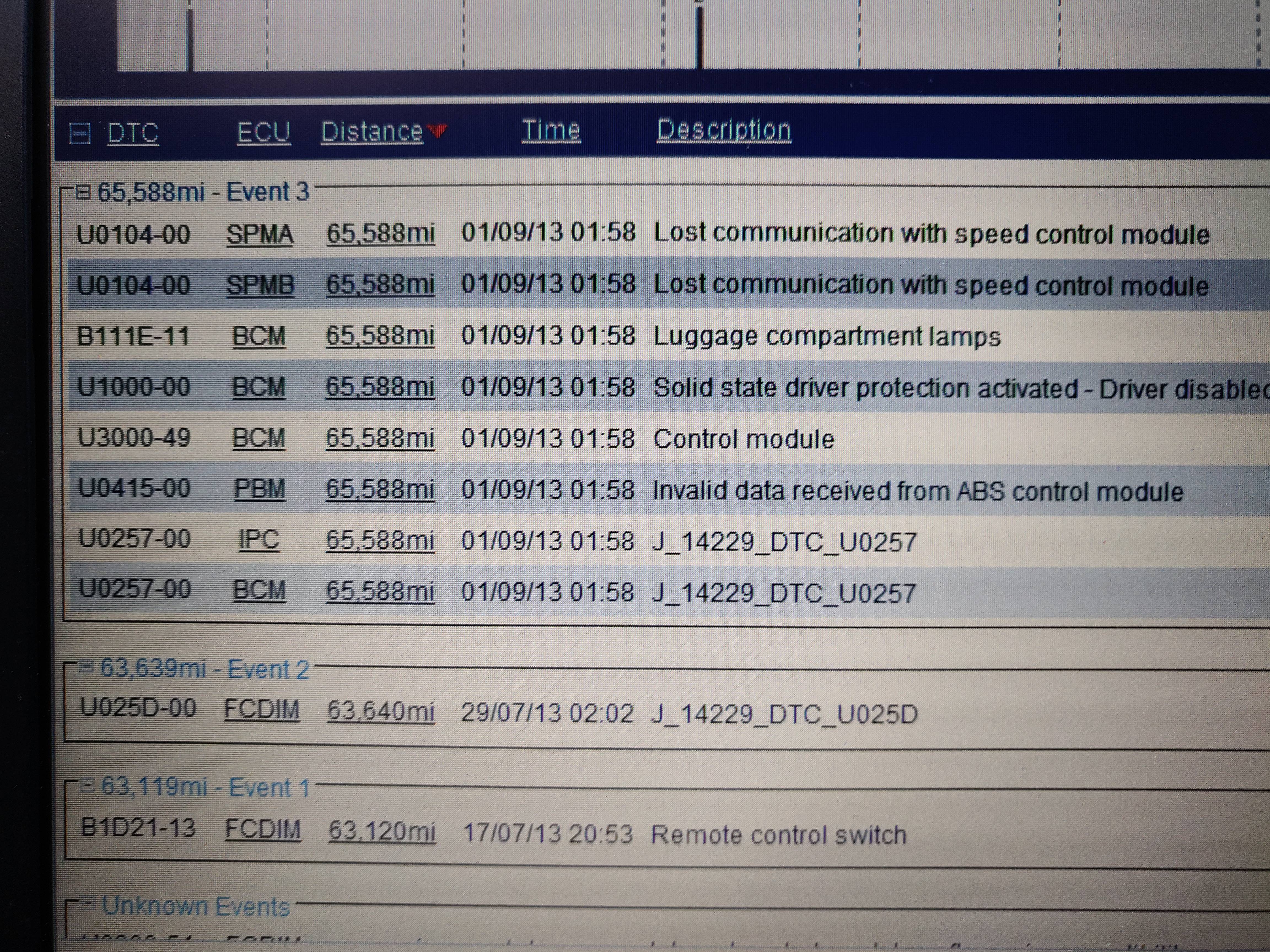

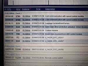

Some pics

Maybe? All the codes are U codes which are network codes. Those almost 100% of the time are related to electrical problems like the battery so yes the alternator could be causing it. But the alternator also has a bunch of codes and your not getting any alternator codes right now?
Have you cleared all codes and ran the SDD again?
Any chance you can try a new battery? I know you have a good one but we have seen mountains of problems solved with a battery replacement.

No alternator codes, and I did a full sdd reset with code clear. I have a battery charger that has an alternator test. It failed the alternator test, for whatever that's worth. So I have a new alternator on the way, to be sure.
