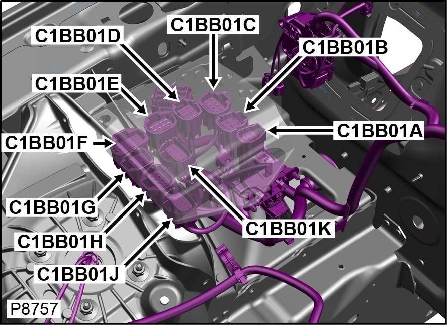

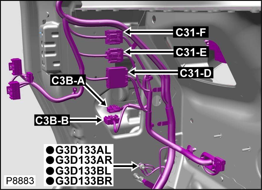

To test if it is a fault downstream from the windscreen you can just pop off the LH A pillar trim and check for voltage between the two connections on to the screen when the heaters should be on. The plastic cover near the top clips off to reveal a single Torx screw, and then it just pops off two clips and pulls upwards. I've had the LH side on my grey XJ fail due to an unlucky stone chip just above the VIN window.
The LH heater a 2010 X351 is connected:
- B+, A pillar to windscreen ribbon connector, C9RD03A, the lower connection
- GND, A pillar to the windscreen ribbon connector, C9RD03B, the upper connection
- C31-D/1, 24-way grey connector, LH lower A pillar
- C1BB01D/4, 4 way black engine harness to engine fuse box.
- Fuse 32 in the engine fuse box, 40A, and relay R3. R13 is for the RH side. I'm unsure if they are serviceable or PCB mounted.
