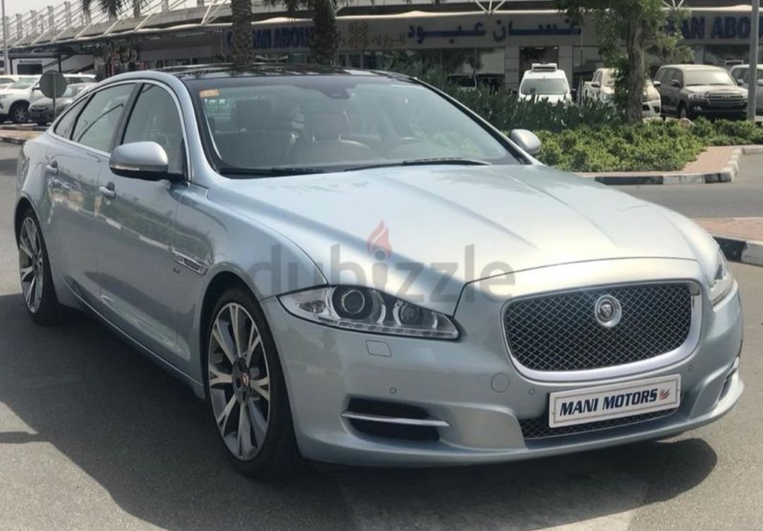

Hello jag enthusiasts! I know such questions were asked a lot but i wanna get more details on what im looking at specifically. So I'm currently looking for a jaguar xj 2014 or 2015 (or even a good deal on a 2016!) model years, 3.0L sc petrol preferably. I live in the UAE, DUBAI, weather gets pretty hot in summers. I'm looking at ones with full service history from the local dealer, and i am going to do full inspection for sure.
So my questions are:
1. what are specific things that i must ask for to get inspected?
2. Is 90k miles a lot on these cars?
3. The weather here gets really hot in summers, how could heat have affected the car over the course of its lifetime?
4. I am going to have the car as my daily driver, not long distances, mainly 20 minutes drive with a bit of traffic everyday back and forth to work. Will i be satisfied and have a reliable ride? Or i better look at something else?
5. What improvements has been made between the 2014 and 2015 model years?
6. Has anyone experienced the 2.0L 4 cyl petrol? There are lots of them here, i know they're rare in most countries
Im so in love with the xj, i looked at and drove other nice luxury cars, like a mercedes cls and audi a7, but i keep on coming back and drooling over the jag, especially the one that i drove with the stratus grey metallic color and grey 19" 10 double spoke wheels (pictures attached) 🥵
All opinions regarding any aspect will be really appreciated ✌🏻
Thanks!
