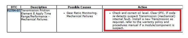

The 2010 Workshop Manual confirms your understanding of P2704-07 and the recommended action:
However, it does NOT list either P0729-07 or U0402-92 as Jaguar defined codes for your model year so I would be cautious about the total compatabilty of the diagnostics tool used.
Typically, when DTC's are cleared without fixing the underlying cause of the fault, they will return after a pre-defined number of 'trips' and not immediately the vehicle is started again.
