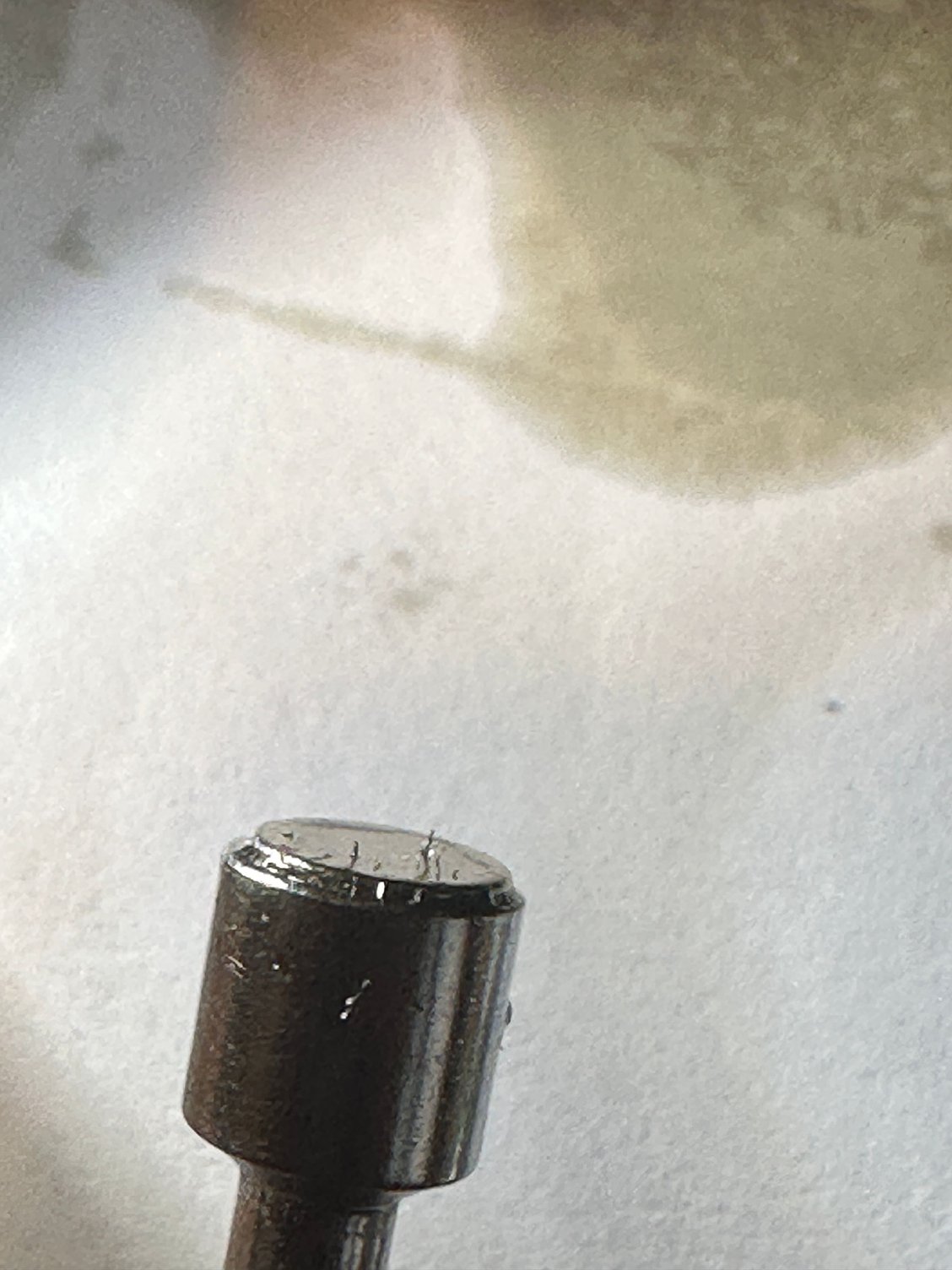

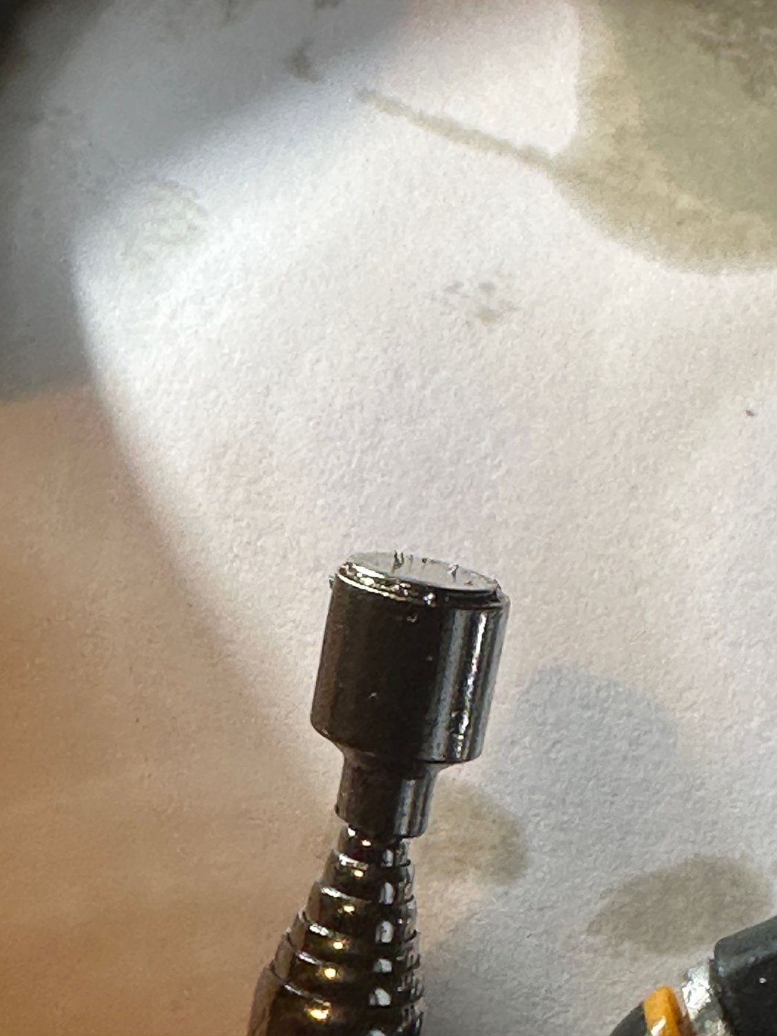

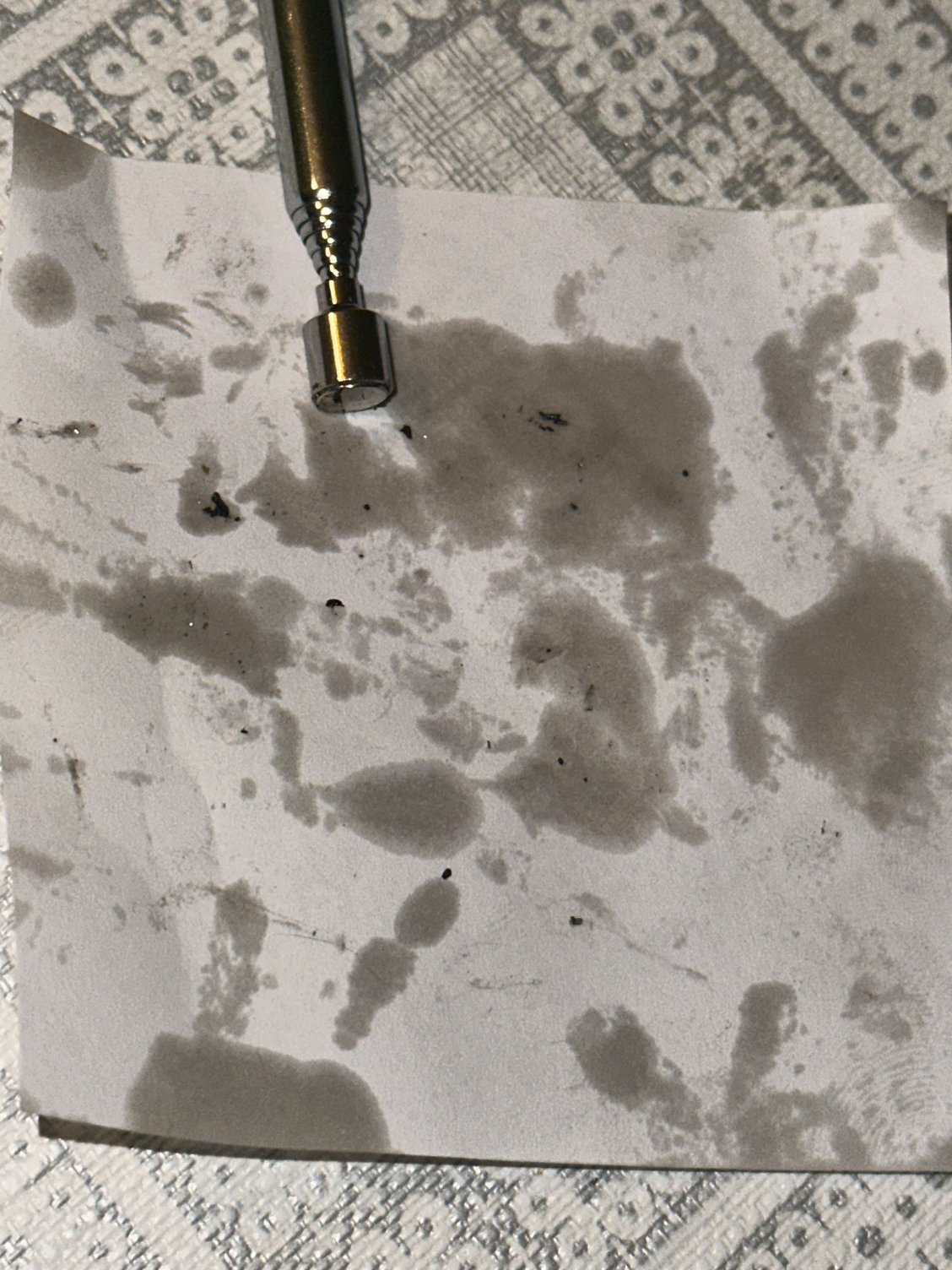

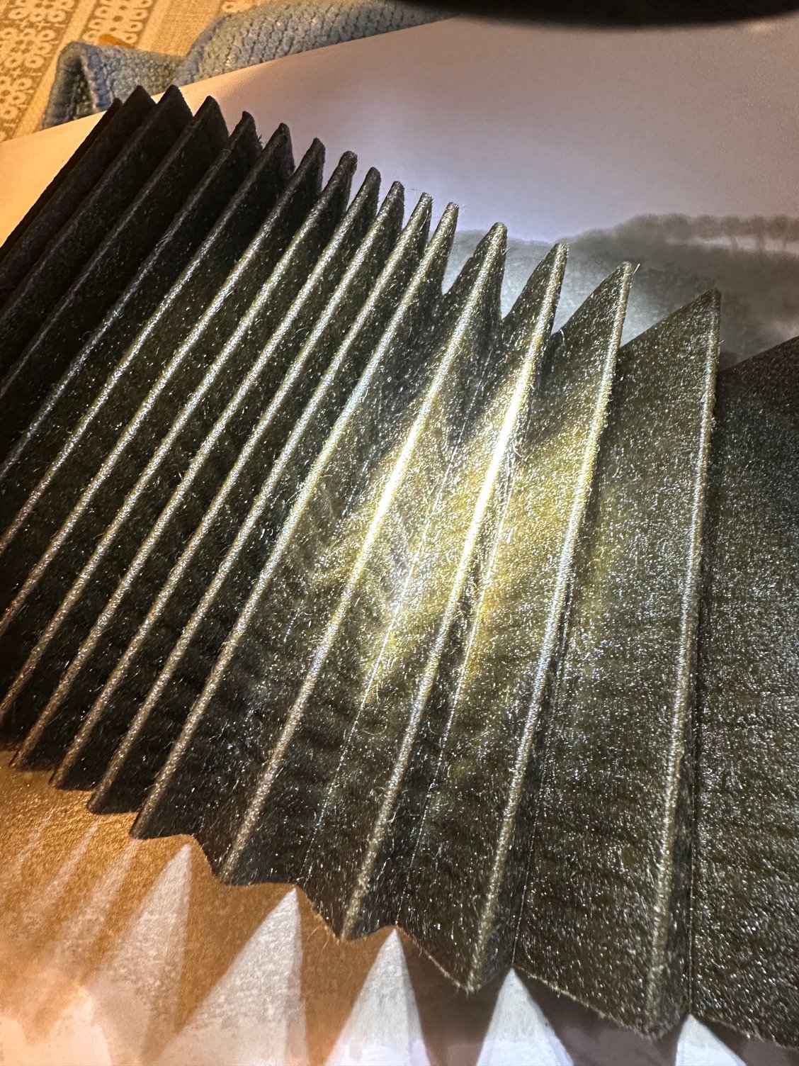

Hi guys. Follow up. Like I told you I changed the crankshaft and piston arm bearings about 6 months ago. Done something like 1500 km. The job was done with engine down and crank out through the bottom. No top engine disassemble. Pistons didn'tleft the engine.
km Mostly in town, but some 130 km highway short 10 km trips. I was really curious about whats in the oil filter. So…. Here are some pics.

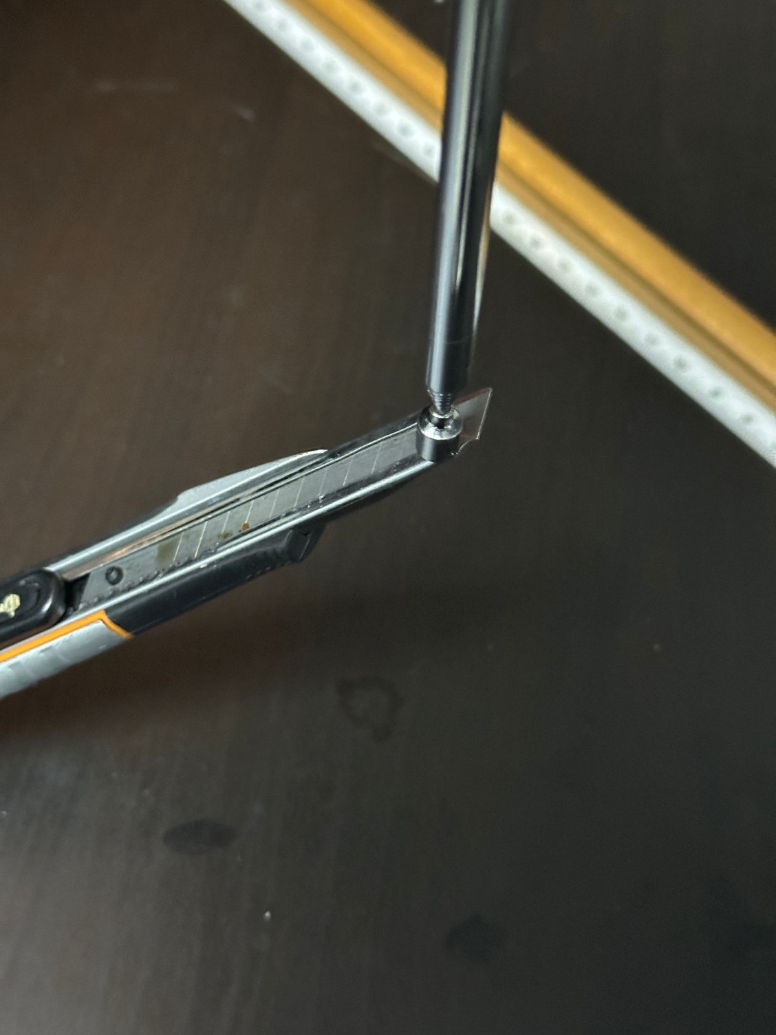

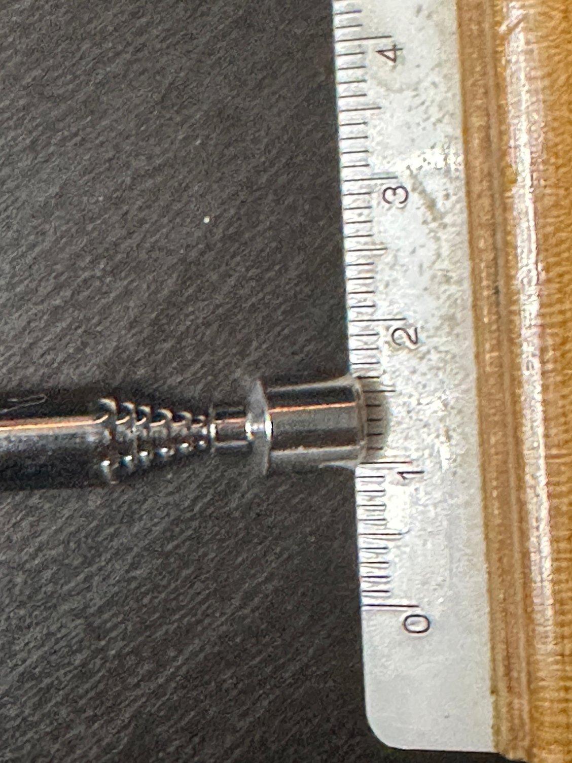

Tool to pick up metal. Magnet for picking up bolts droped.
Strong enough to pick up a cutter. Used to cut the filter
The filter. Bear in mind that the engine was not fully rebuilt. But had before bearings, new rockers installed. And front and Back distribution.
So, engine was not fully dismantled and cleaned. Like in a full rebuilt. Actually, it stayed in the large service shop hall with other cars worked on around. So no exactly clean environment.
The result.
about 15-20 micro shards. Metal… as u can see.
1-2 pieces of ald bearings layers, brown grey with reddish colour and verry thin. Not metallicCouple of pieces of carbonization. Hardened…. But disintegrated on the finger.
I literally scraped in the deepest part fold of the filter to get what you see on the magnet. Scraped until I got any bling out. Used a flashlight To hunt them. About 30-50 ultra micro specs of shine, not sure of metal, they adhere to the oil and to the magnet by scraping and the oil on the magnet
Hope youubderstand the procedure.
Just by calmly sliding the magnet through the crease/fold, the result was only those micro shards..15 ish. From them…. Like 7 you can see clearly… the rest my iPhone pro couldn't zoom and clarify enough.
So…. My opinion. These seem to be residue from the old parts, ware and Tare on a normal 200.000 km engine. Micro shards might be from anyware in the engine since it wasn't cleaned and rebuilt in a dust environment perfect air room. Like it should. Might me even residue of opened and closed bolts all over the engine. From different moments of the job. Actually, oil pan at one moment was on a table and could of collected debris. From air or other works around. Crankshaft was 2 days on a box on a table in the shop openly…. So…. In general, impossible to keep all things perfect clean.
Didnt found any real sparkle hard metal. Except those ultra micro shards that sit on the top of the magnet. And that was after scraping the oil filter to get anything loose from the crease.
So guys…. Opinions?
In this pic, you can see couple of shiny spots, that I had to rub the magnet on the paper, otherwise wont pick them up. Some black carbonization.… not metallic(had to play again billiard again woththem to be able to take them off the paper because would not stick to magnet.
About 3-5 shine pieces….. Are so small and so tiny….. As u can see.
Replaced the oil filter, and after some time another checking. Hope I am correct and it was debris and dirt from the engine.… stored in the MIDLLE of the crease. That's how small they ware. You can see in the third pic………..i really had to hunt for them

Quite normal after engine rebuild. Like you wrote: Most likely from screws / washers etc and new parts "run-in" wear.
Add new oil filter and drive another 1500km and check again. You should not found same amount anymore.
