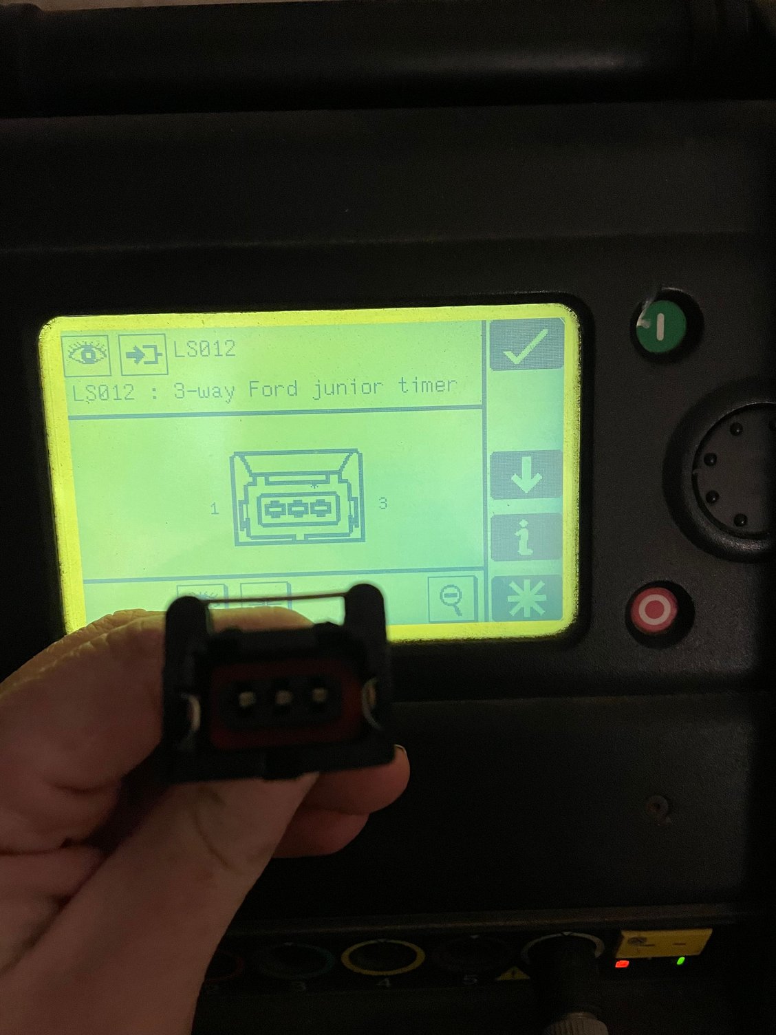

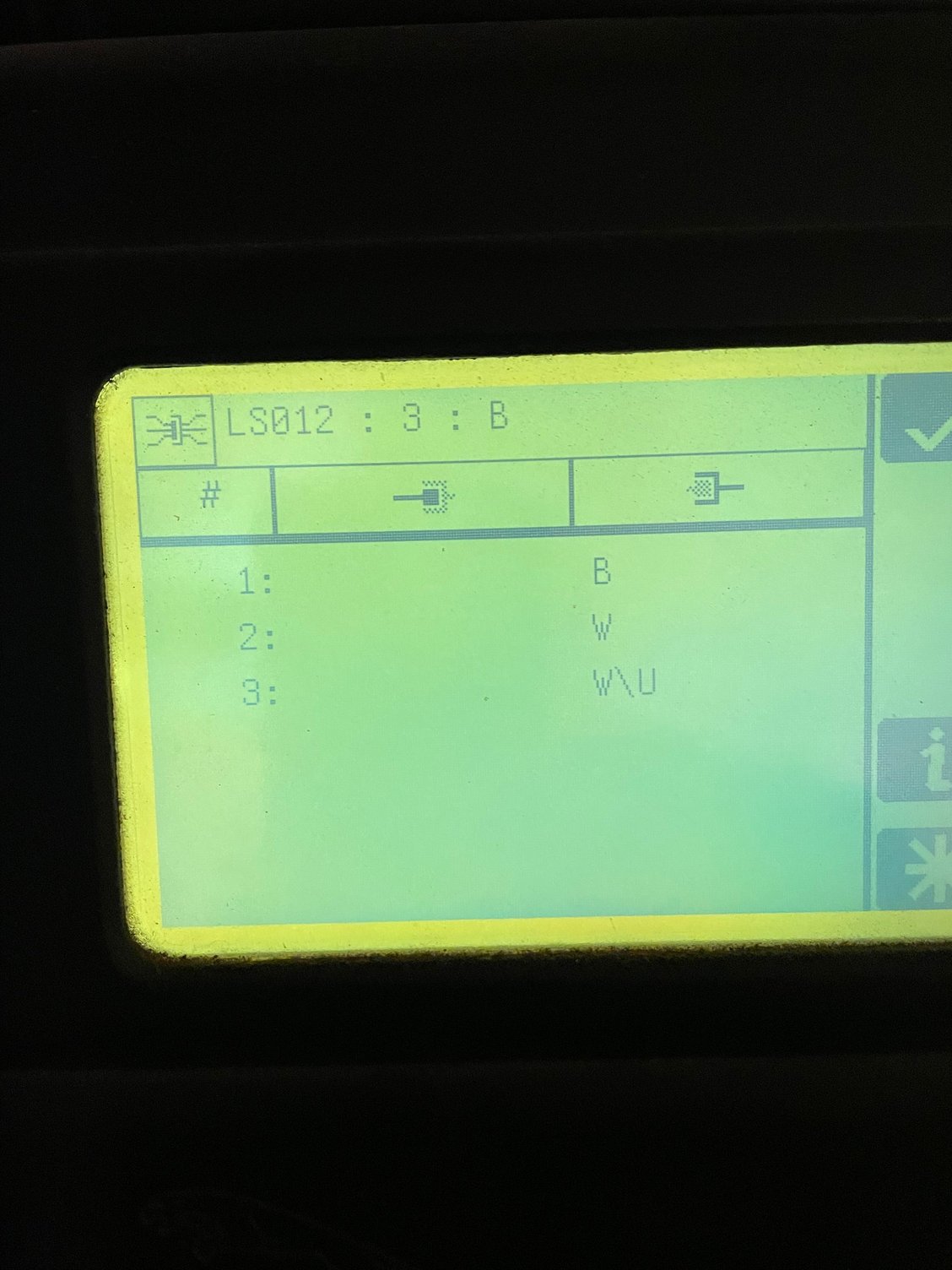

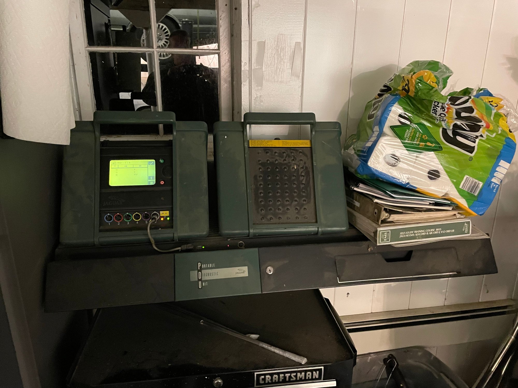

Just sharing a small victory. I have a PDU and it’s been pretty useless as a diagnostic tool. But it does have a neat connector pin out lookup! The radiator fan temp sensor has a three wire plug. One wire was broken off so I cut off the pig tail and ordered a new one. Then I lost the old one and no longer knew which wire went where in the connector. With the PDU I was able to look this up!
