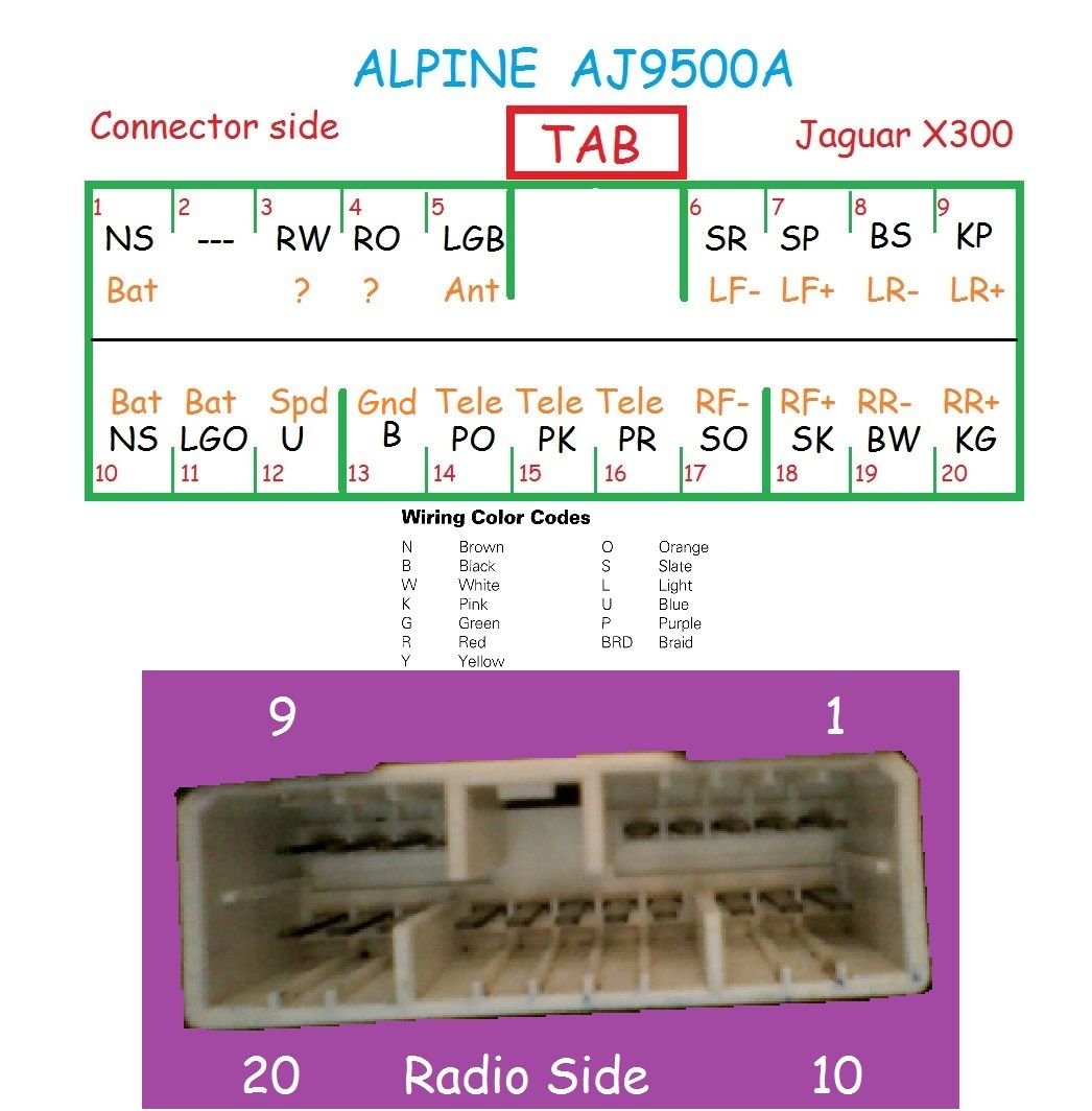

There is some traffic in the X300 area on the details to installing the aftermarket stereo heads
Do you currently have a in the trunk power amplifier and a CD changer in the trunk' ?
The same Jaguar / Alpine AL9500A stereo head will run the standard Jaguar factory wiring where the speaker wires come from the head as in the pic above . Or the factory premium option where the speaker wires come from the trunk located power amplifier ( so may be a matter of having to run new speaker wires )
To make a trunk amplifier work there is an 8 pin DIN cable that runs under the center consol
In some cases this cable is already there to use otherwise not ( extra ) used in the standard setup
To know if you have this tan colored round 8 din cable already installed it will run under the center console ashtray along with a black round antenna cable , no stereo head removal needed to get into that area behind it
