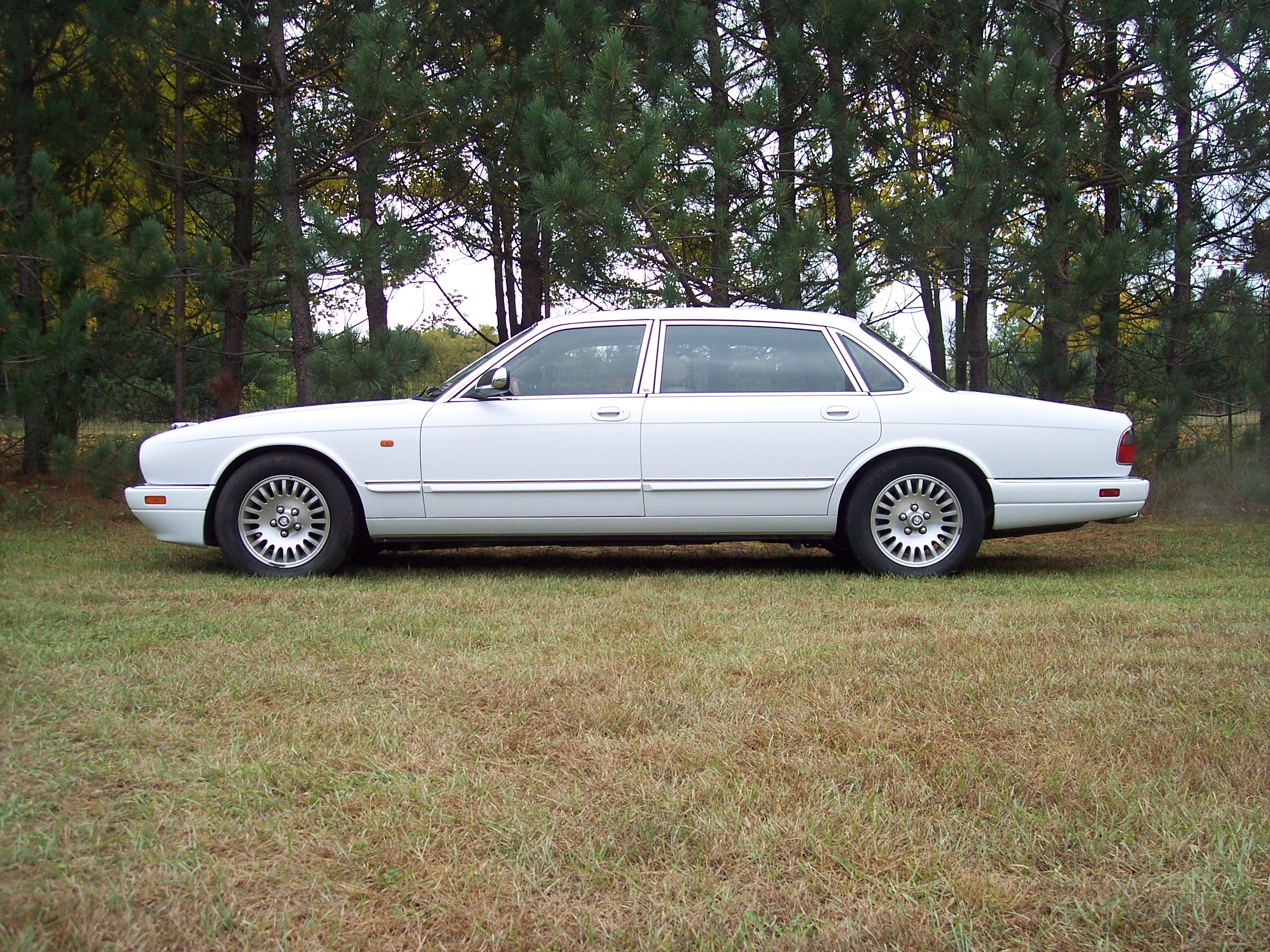

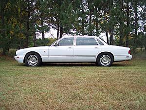

I have a '96 XJ12, 89,000 miles ready to go that I have been showing at local shows. Not currently listed anywhere but soon will be. I spect Wisconsin is a bit of a stretch though to travel for most from the west coast.

Long time lurker, first time poster. I'd be interested in your XJ12. Please PM me!

Unable to PM indicates not allowed to receive. Maybe because of being new to the forum?? PM me and then I can respond. Might be a slight delay in my response as we are currently out of town fishing will be back in a couple days.
