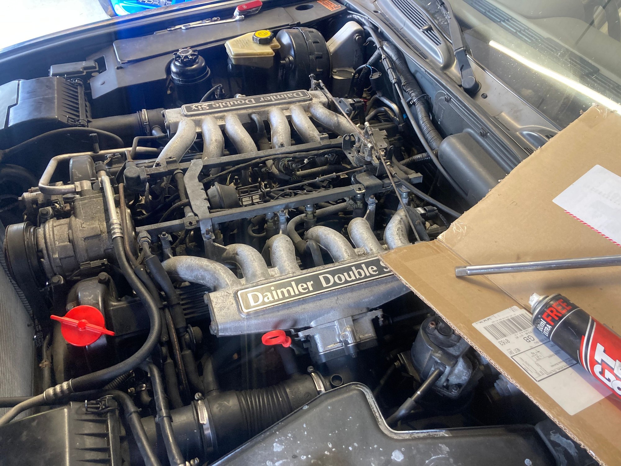

Spark plugs changed. That was a fun job 🤔 Any one know the torque settings ?

17NM! I went slightly beyond that but you should be okay around that mark.

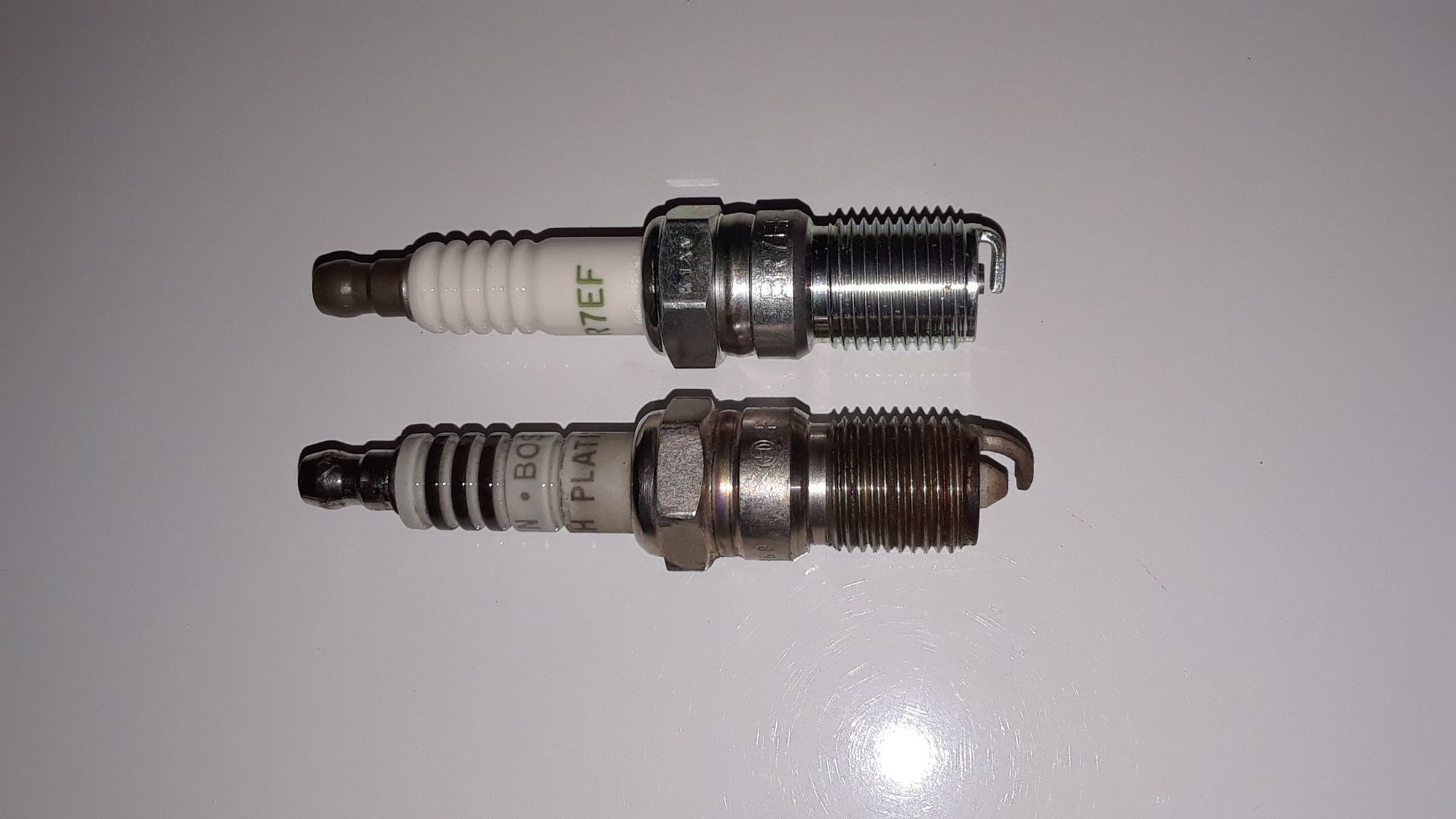

I've had a box (+2) of new spark plugs for a couple of years now, original NGKs. Checking the records last year, I found out the last time I changed the plugs was in 2011, 40,000 miles ago! The car continues to run so well (touch wood)! You could never get away with that in an AJ16. I have had Bosch Platinums in it for this duration. Apparently a very good plug for this engine. Good thing because I remember it was a "fun" job back then!
Last year upon inspecting one old plug from the engine, I could see a major difference in the insulator protrusion. I don't suppose that would make any difference? The Bosch was still in amazing condition so I lowered the priority of this chore. Again.
