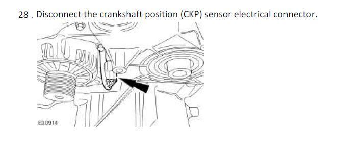

The crankshaft position sensor (CKPS) is mounted on the timing cover on the front of the engine, down near the crankshaft pulley. I don't have a photo but here's the illustration from the Workshop Manual:

Hi Don thanks for the information.the connector is just laying there. I didn't take it off must of knocked it off while taking off fan & shoud or drive belt.I thought it was for headlight washer option that I don't have. Couldn't this being off make it crank slow like out of time or something like that. Thanks for all ur help. Cheers ( see ya) chris
Hi Chris,
I doubt the CKPS being disconnected was the cause of your slow cranking - that was probably due to your battery voltage declining from trying the start the car. But if the CKPS is disconnect the car will not start because the ECM cannot determine the engine speed or ignition timing without it.
