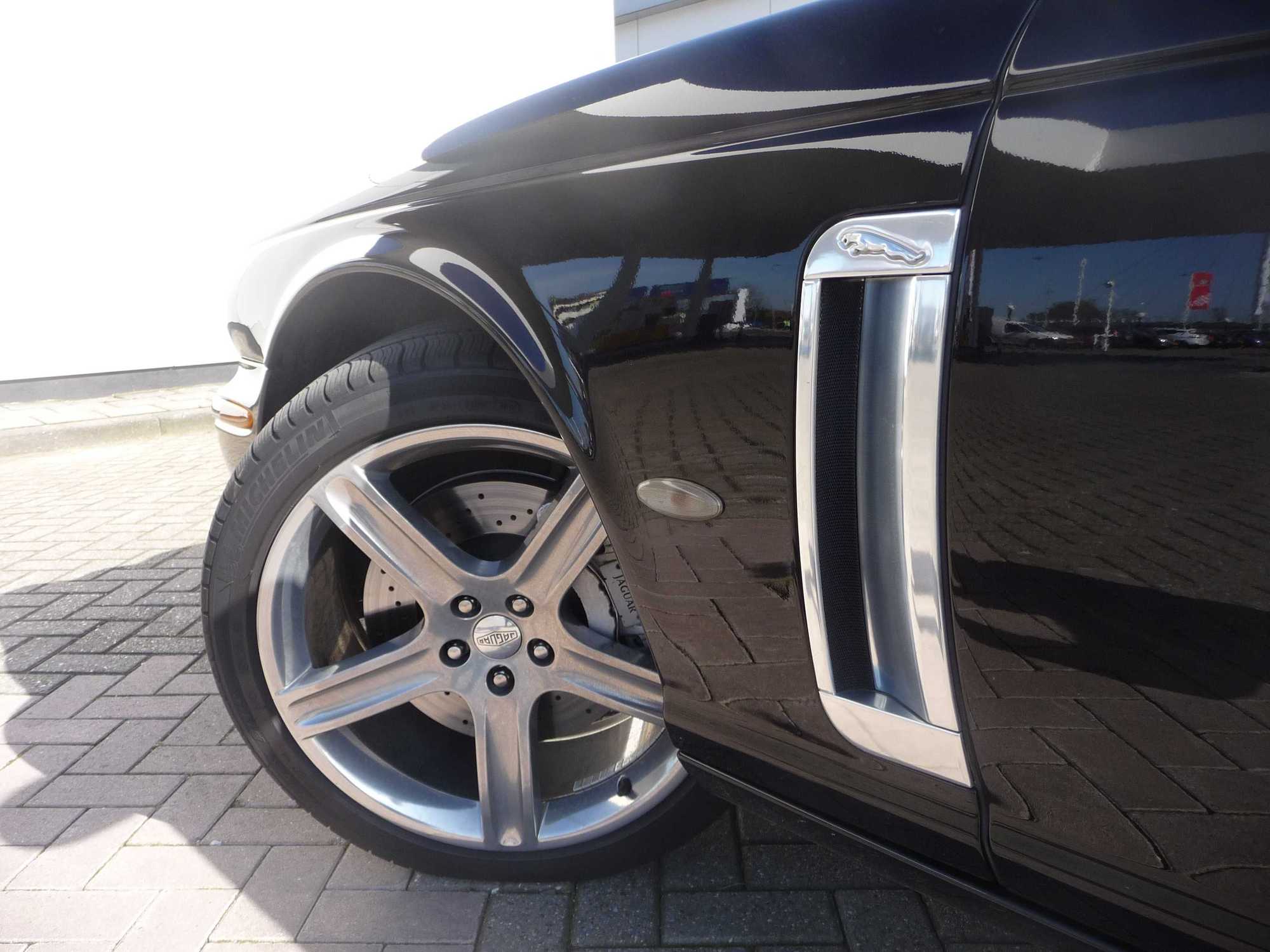

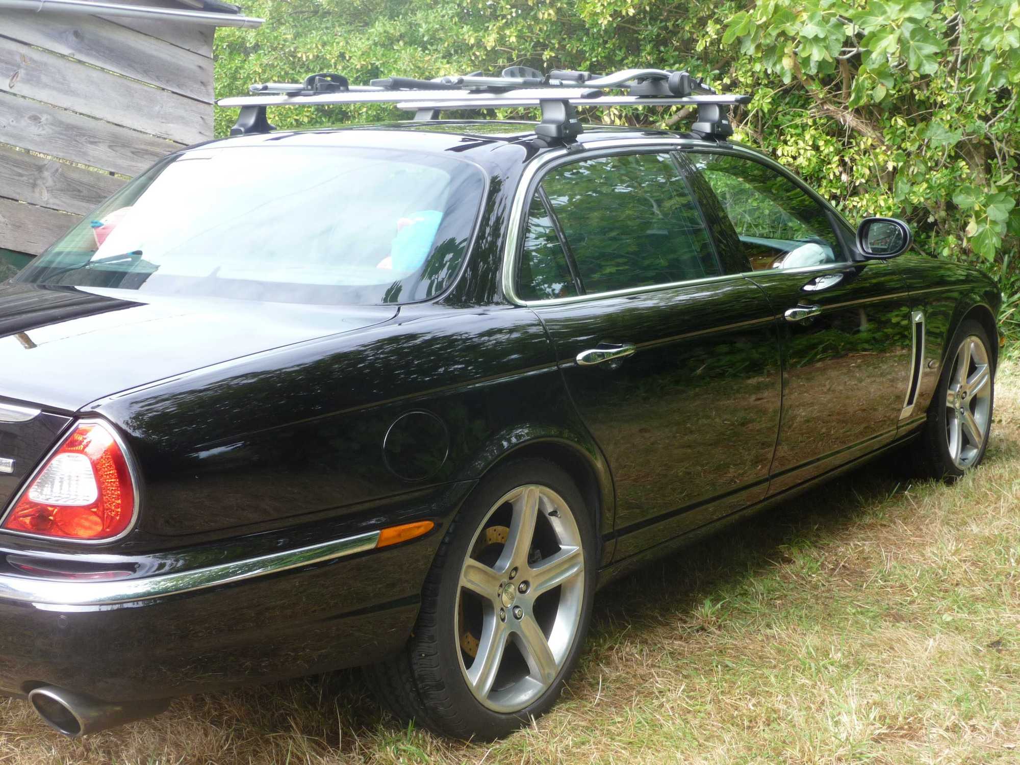

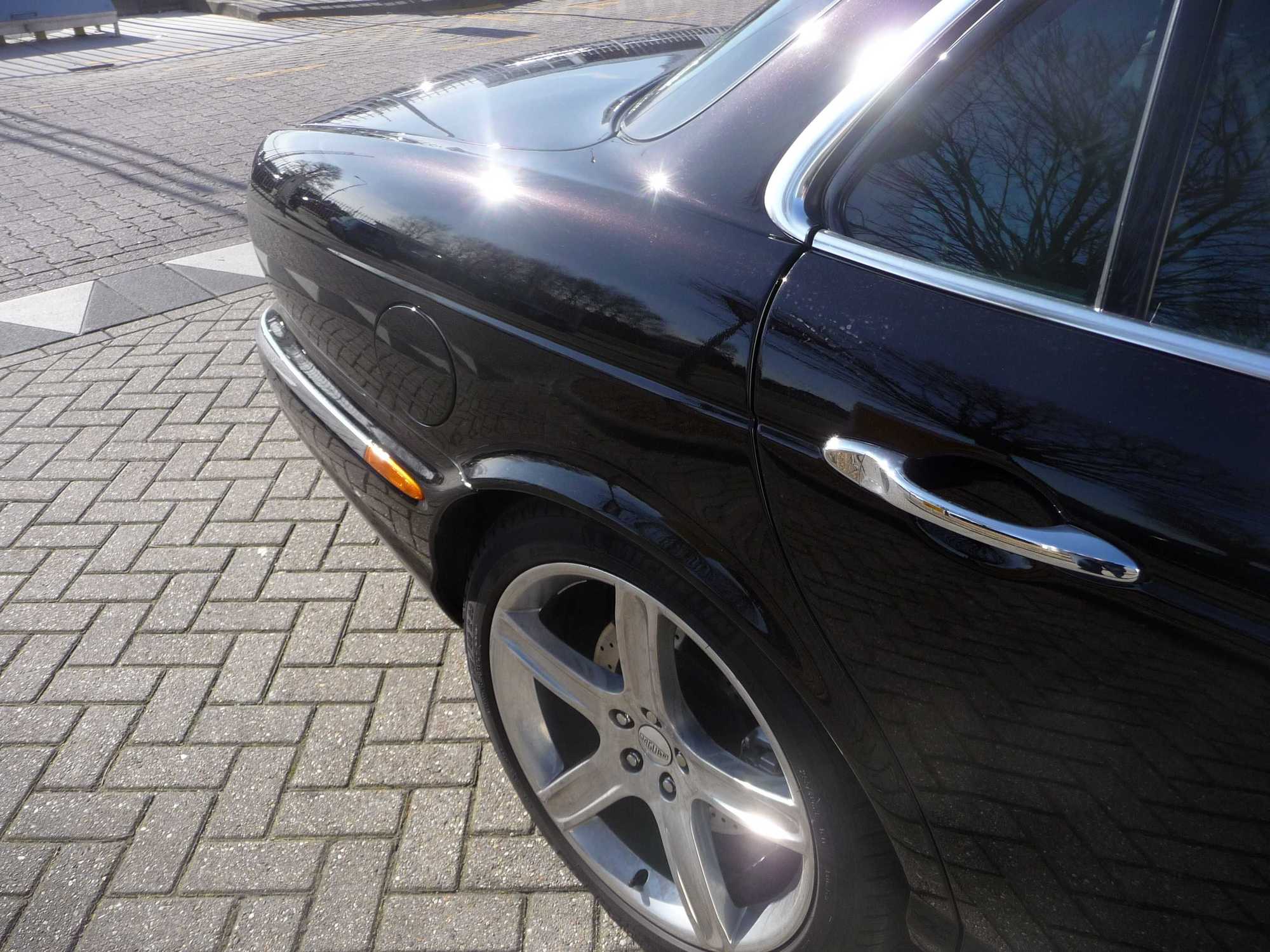

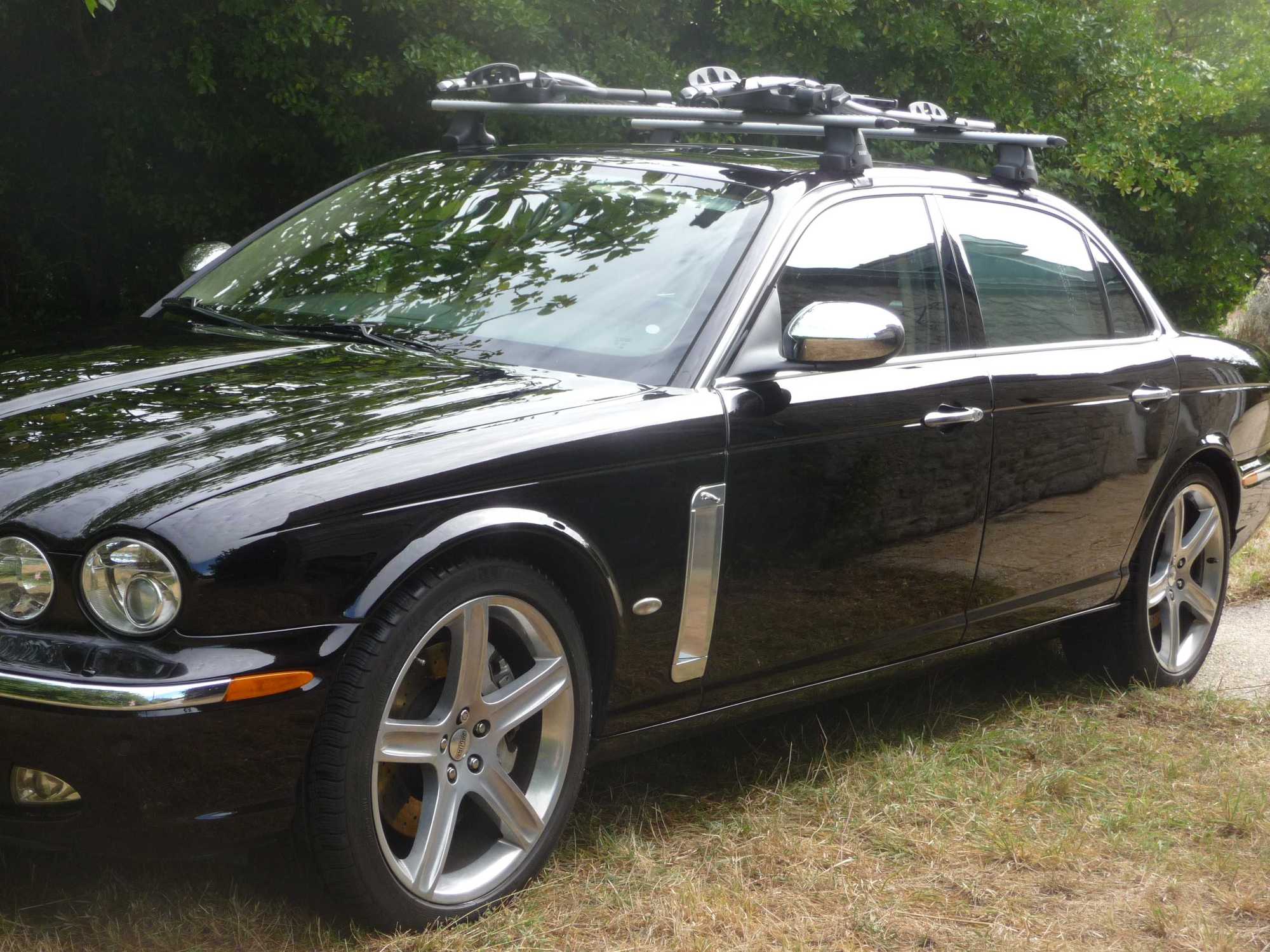

Could you possibly post up a pic of the car with those tyres? My car had 245/40-20 tyres on my Callistos when I got it so replaced them with the correct size, but I would be interested in the size change if it helps on our rough roads.

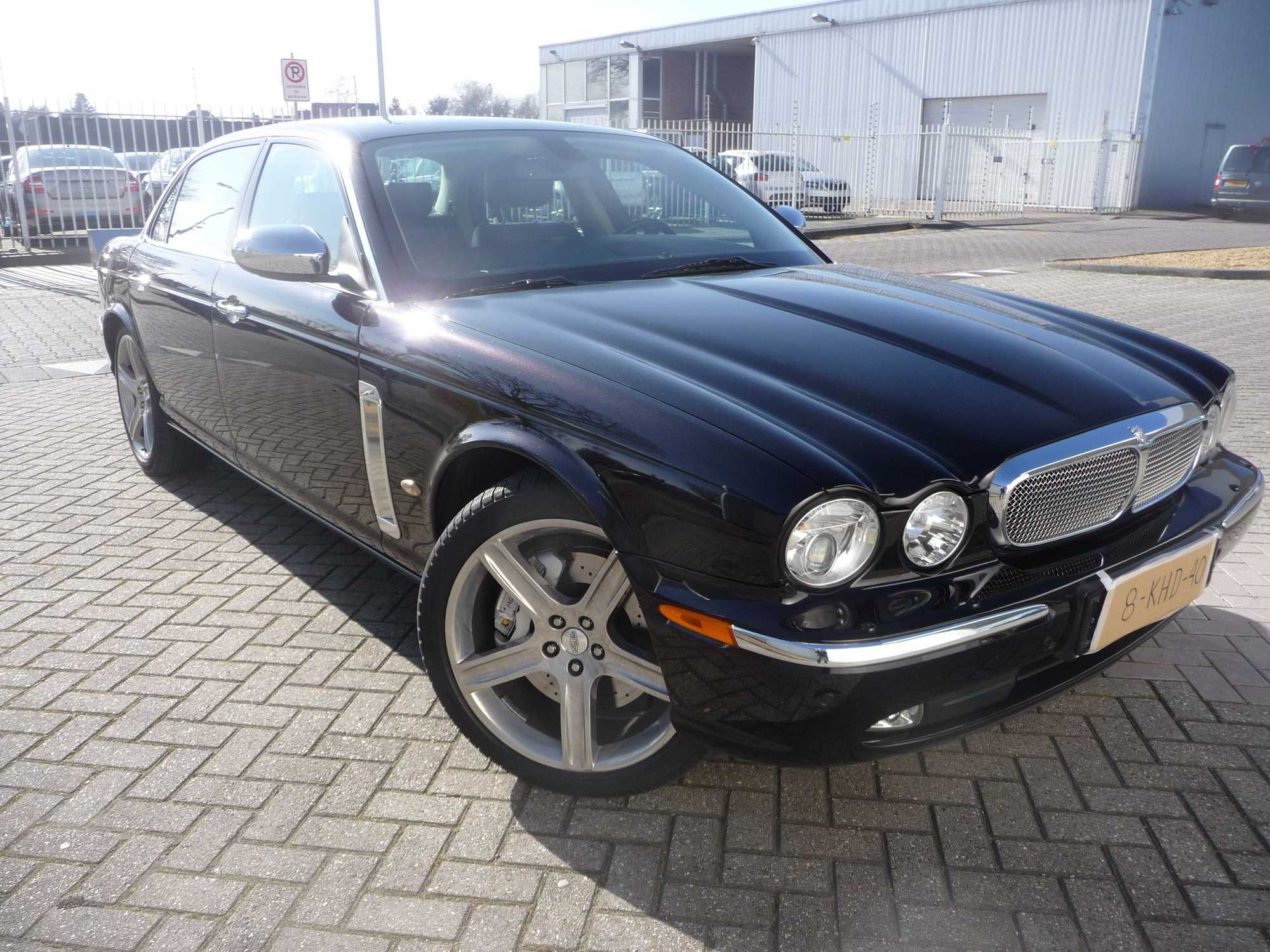

Pics with 255/40 R20 on the 9" Callisto

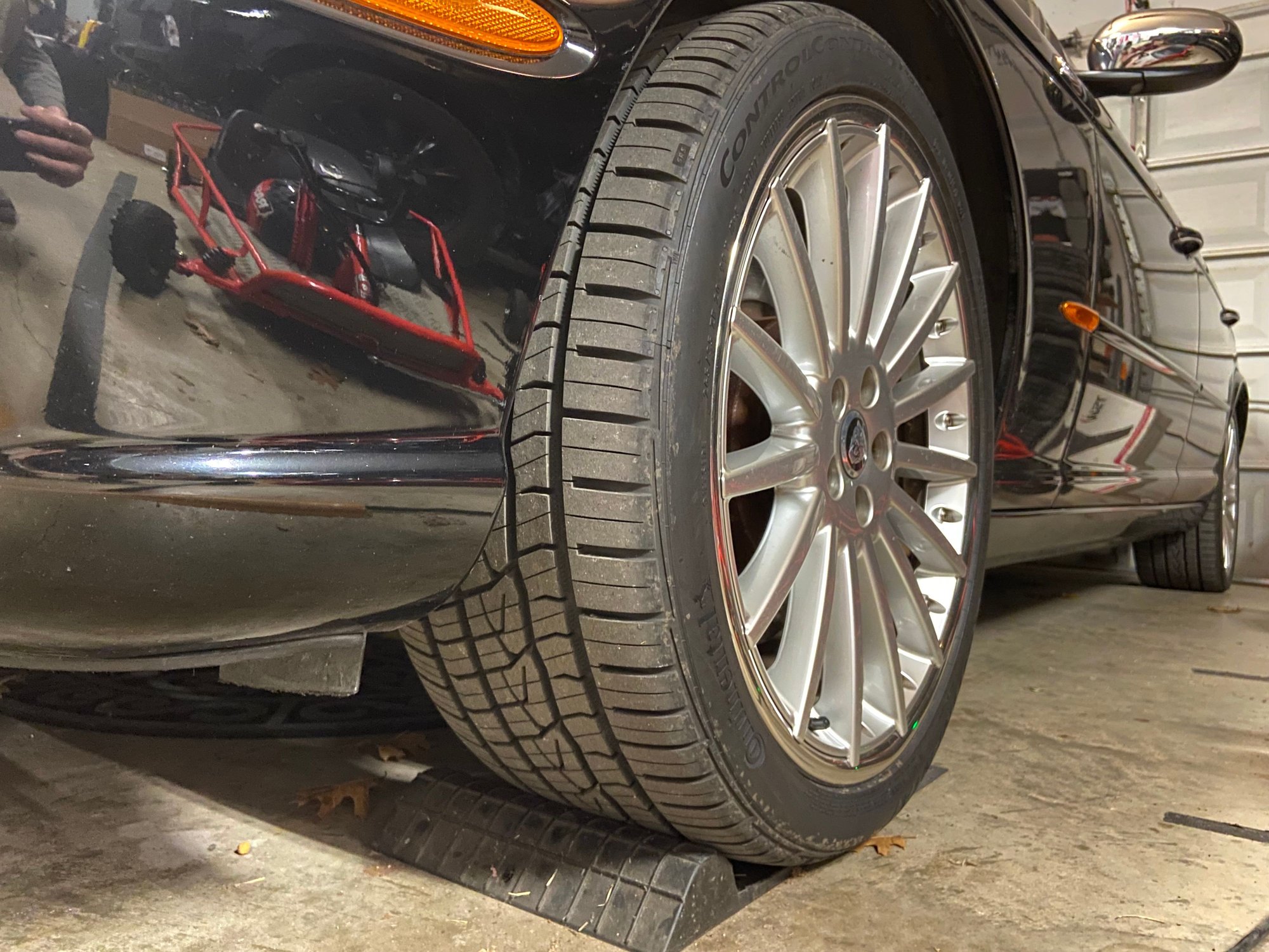

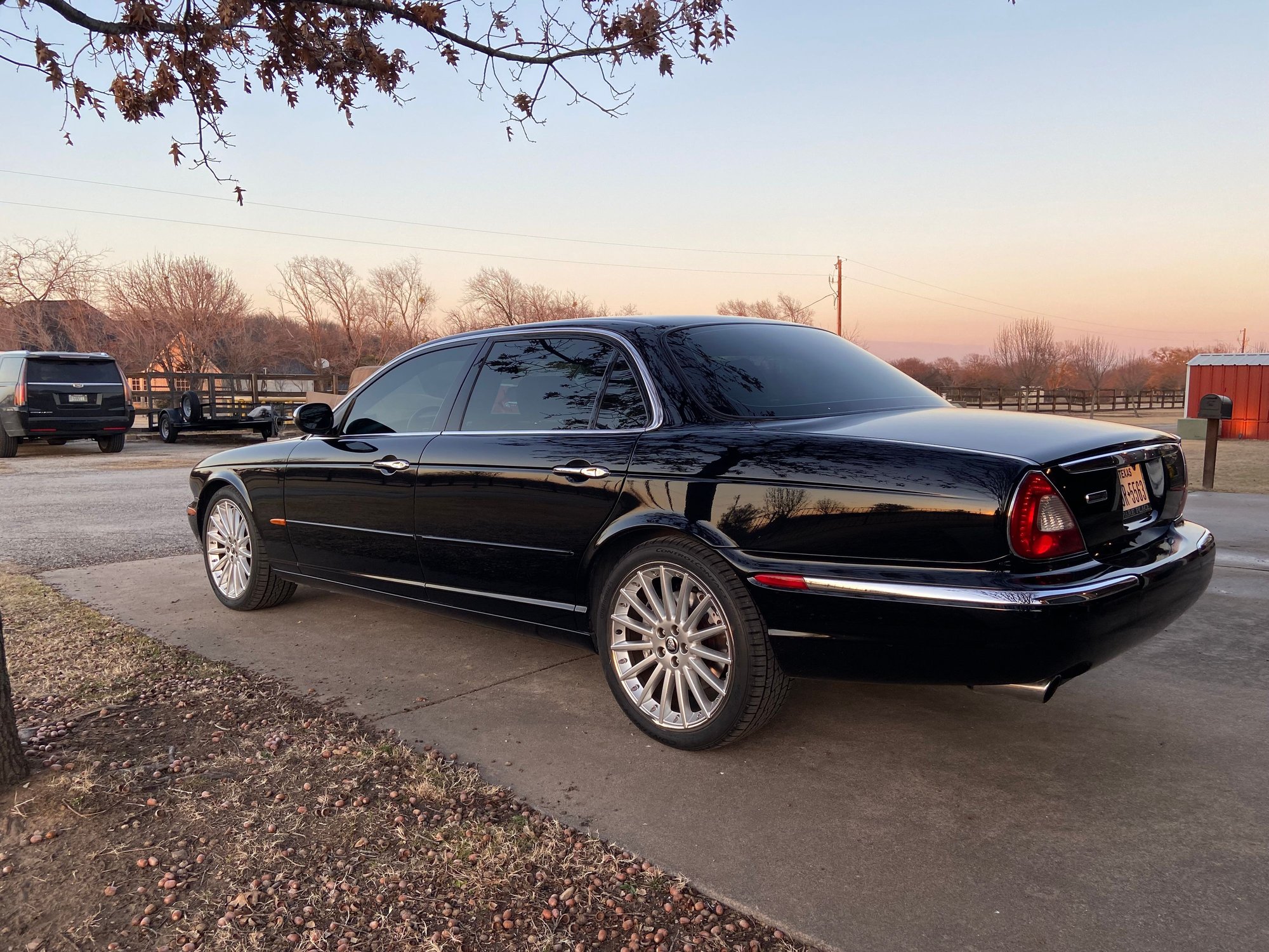

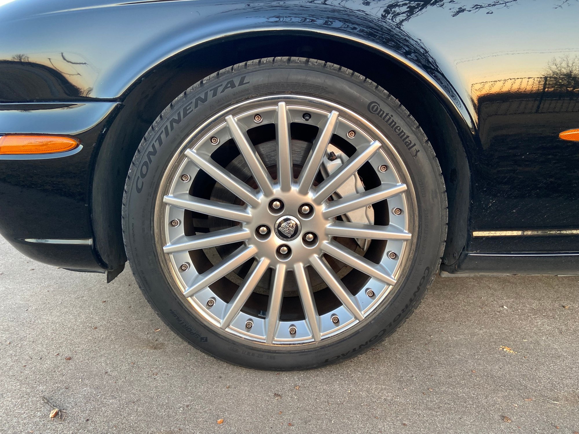

I ordered a set of Continental Sport Contact SRS all-seasons in 265/35-20 and am having them mounted tomorrow. I think I'll be happy with this setup, but TBA. Considering how the X350 factory OE size for the 20s is 255/35-20, I hardly see this as not sufficient and should be a net improvement in lip protection and width. Roads around me are pretty smooth and this isn't a daily driver for me.

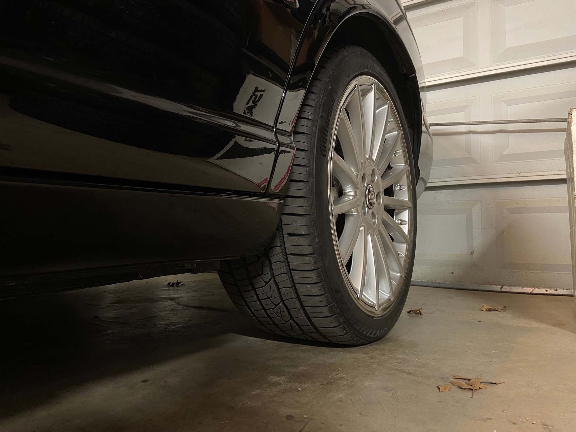

This is complete. Mounted. Happy. Over 100 mi. driving them so far since Friday morning. Perfectly barely-over-flush width that should have been this way as OE. Stay tuned for pics.
Old Feb 15, 2022 | 11:52 PM
Sentinelist's Avatar
Joined: Dec 2012
Posts: 896
Likes: 156
From: North Texas
For once in a very long time, I'm probably going to pass on the spacers. This is pretty much perfect for me. I'm going to pour another drink and go stare at it in the garage again before bed.
P.s.: don't trust your life to Chinese tires

Hi Sentinelist,
Those look really great. Thanks for showing what the 265 width looks like on 9" rims. I got the standard 255 width (to remain standard) and they look a bit narrow. Next set I get will be 265.
Here in New Zealand (next to Australia) they charge for one of those Continentals over NZ$1000. I really like good tires, and my V12 has Pirelli P400, but $4000 for a set was out of my price range. I haven't had any issues at all with the Triangle tires I got, even in the pouring rain on 300Km of winding hilly road in the middle of the North Island. Perhaps for my next set I will be able to afford something else.
