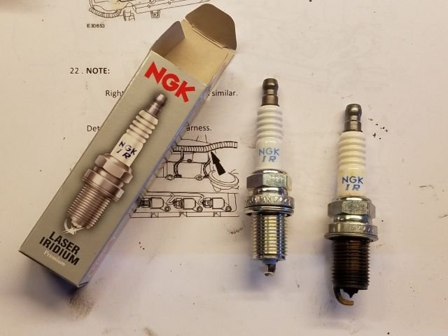

For my 2007 XJ8 is used NGK IFR5N10
Changed at 98K miles while attending to slight oil leak at cam covers - I think this was the first time they had been replaced. The ones I removed looked fine.
I think the recommended interval is 100K miles
http://www.dbug.co.uk/1/2004MYMaintenanceCheckSheet.pdf
Helpful hints:
16 ft-lbs
https://www.jaguarforums.com/forum/x...gs-how-104935/
https://www.jaguarforums.com/forum/x...89/#post984896
old and new
HTH, Dave
