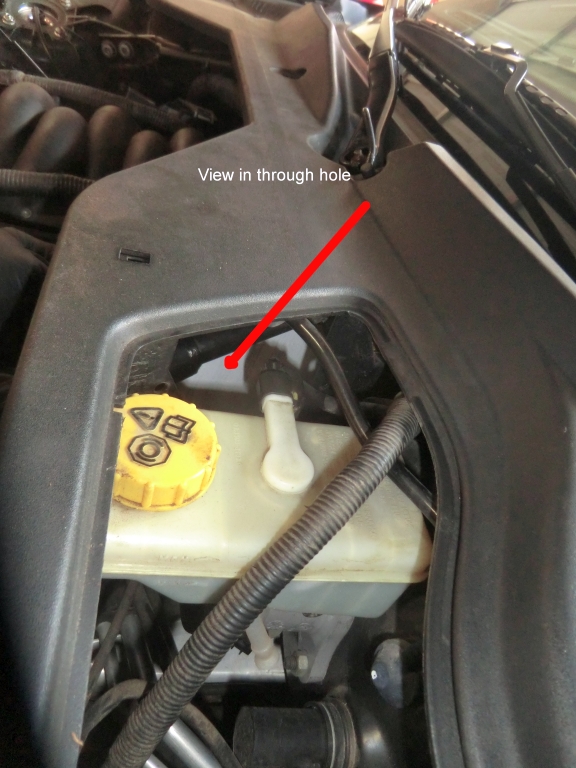

2. Looking to the rear right there is a small plastic cover that allows access to the Cylinder No#8 through the brake reservoir well. Remove the clips holding this cover in place and pull it out. I had to remove the sound proofing at this time because it was in tatters and was sound proofing nothing, You probably will not have to remove it.
3. Here is the view through the hole looking at Cylinder no#8. I placed some paper there so you can see through.

5. Now you can see my hand has access through the well to the coil pack and spark plug.
6. Right Bank Now... Once this prep work was completed, I then had access to all of the cylinders pretty much unaided. I removed all of the Coil pack cabling and then removed all of the bolts holding the coil packs in situ. One at a time I started removing the coil packs and the spark plugs.
