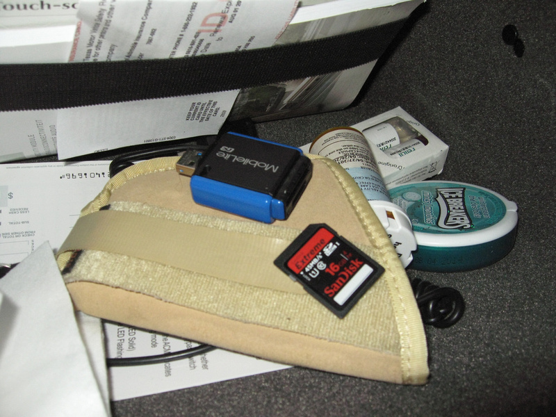

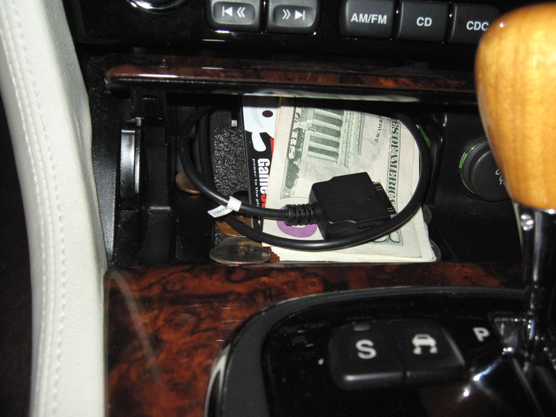

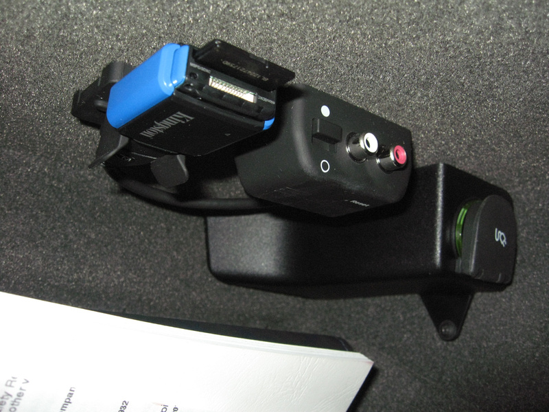

The ACM works the same in an 06 as it does in your current 04. Its a dealer add-on, it would be hit and miss finding one that has it already installed.
The package ACM bundle includes this module that gets plugged into the back of the head unit. There are other cables that get plugged into that module, and one cable is the ipod connector (seen here where my ashtray used to be)
the second cable goes to an RCA input 'box', and the other is a USB port. You can mount them anywhere you want, most do it in the center console, but since I have the rear A/C, my center console is only an inch deep, so I put mine in the glovebox...cables provided are long enough. Here is a pic of the USB and the RCA 'box'.
This is the SD card reader that i leave plugged into the USB port w/ a 16GB card...containing all 2000+ of my mp3s recorded at 320 kbps, the best quality for mp3.
The dealer will install this for you, but it will be pricey...expect that. Any competent audio installer could do this easily also, especially since its all plug n play OEM parts. I would guess $200 in labor from a local shop.
