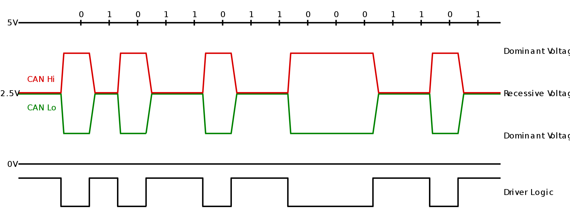

Quick update here... In the process of diagnosing the transmission / instrument cluster CAN network fault P1798 I've taken some interesting measurements. What I'm finding is that when I measure resistance between the CAN network pins on the female J-Gate module connector I can see the 120 Ohm terminal resistor in the air suspension module referenced on the right hand side of the diagram below. What is interesting is that when I measure resistance on the two pins representing the left hand side of the circuit diagram... I see nearly 1000 ohms, way more than the 120 Ohm terminal resistor in the ECM. Essentially at any point in the network if I break the "rails" I should see 120 Ohms on both sides. That implies that, at least from the J-Gate's perspective, the 120 Ohm terminal resistor in the ECM is hiding behind some larger inline resistance (likely a bad connection.) None of the terminals are shorted to ground or power. My meter does measure a dead short to ground if the meter polarity is reversed on some of these network pins but that implies that the ICs communicating on the network act like a diode when measuring resistance, not a surprise.
When I unplugged the dynamic stability (DSC / ABS) module connector under the hood last night, it felt loose. I'm starting to suspect that the DSC module pins aren't making good contact. Tonight I'll measure pin resistance there and see if I can find 120 Ohms on the ECM side of that connector. Then I'll put the connector back together and open inline connector IP55, check resistance there. If I'm losing my 120 Ohm terminal resistor between the DSC female connector EC30 and the left half (as diagrammed below) of IP55, I think it is a safe bet that the problem lies in the DSC module pin connection. I remembered a TSB https://f01.justanswer.com/crzydrvr0...J413-02am2.pdf which references problems with the DSC module pin connections specifically for the CAN network. Perhaps I am on to something here. Hopefully this is my problem. Time got away from me last night and I had to get enough sleep to hold it together for my day job today
For those who are unfamiliar with the CAN bus architecture. I've pasted an image below from the Wikipedia article showing the "typical" structure of the CAN network. Signal structure dictates that both "rails" or wires float above ground. Rail to rail resistance is 60 ohms with everything connected which is created by closing the rails at each end with a 120 ohm resistor. Two 120 ohm resistors in parallel = 60 ohms total resistance. You can see that our X350 CAN bus looks just like the example on the Wikipedia page.

Sounds like you're on the right track with a bad connection. With all of the water leaking in, and the high resistance, I would suspect corrosion at a terminal somewhere along the bus. Given the low voltage of network communications, it doesn't take much to get in the way of things.
Dave
