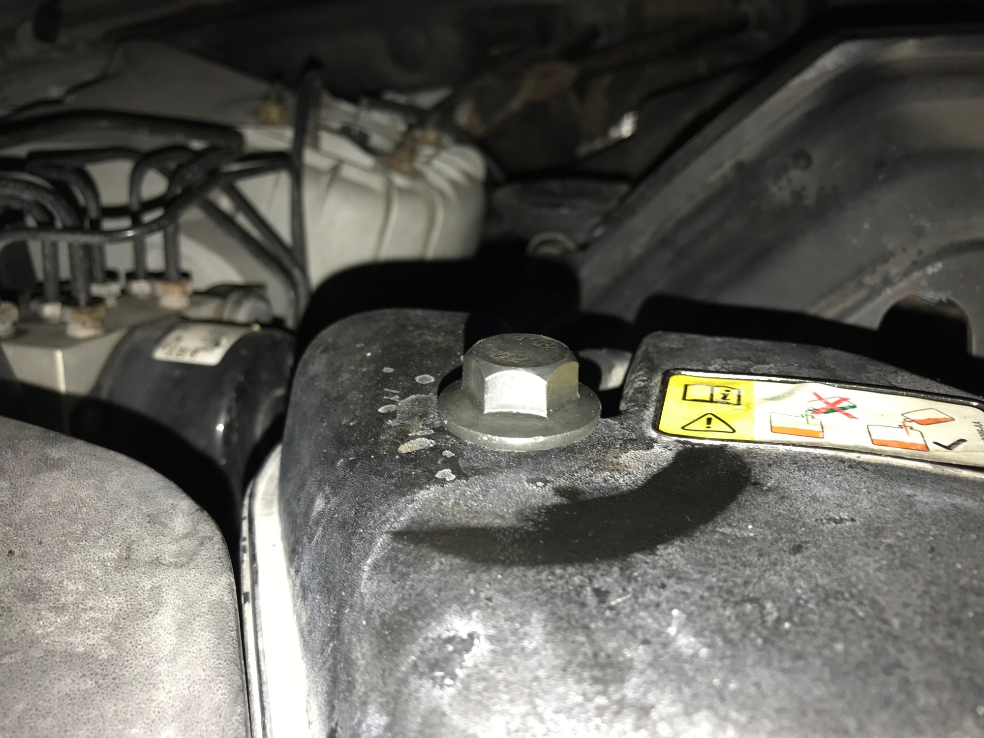

Thought I'd briefly revisit this old thread, as it saved me today. The bleeder screw on the car failed, so I topped off from the jug in the trunk and got home, post-haste. A new reservoir and vent hose are now on their way, but both won't make it here until the weekend.
For those who end up having to do this in the future, be it to buy some time or in the field on an emergency basis, the length of the bleeder screw/needed length to cut the M14 bolt is 15mm. My local Lowe's store didn't stock any kind of a 14mm bolt, but the local Menards (central US home improvement chain) had choices. I went with a flange headed bolt, used a small cut-off wheel to get the length I needed, applied Teflon tape and appropriate o-ring and installed. It all went together nicely.
