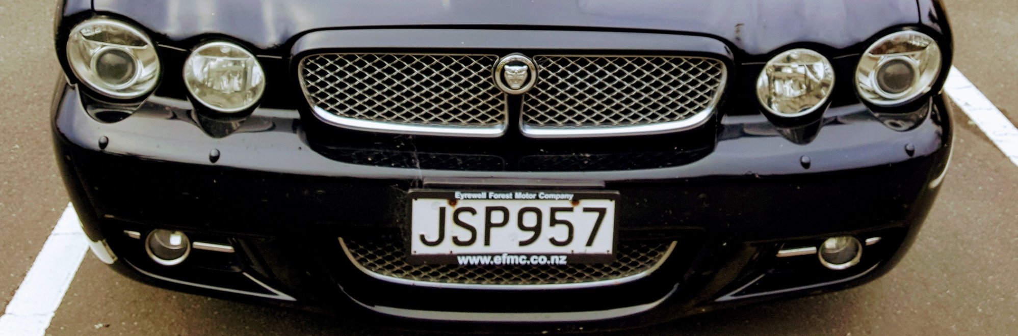

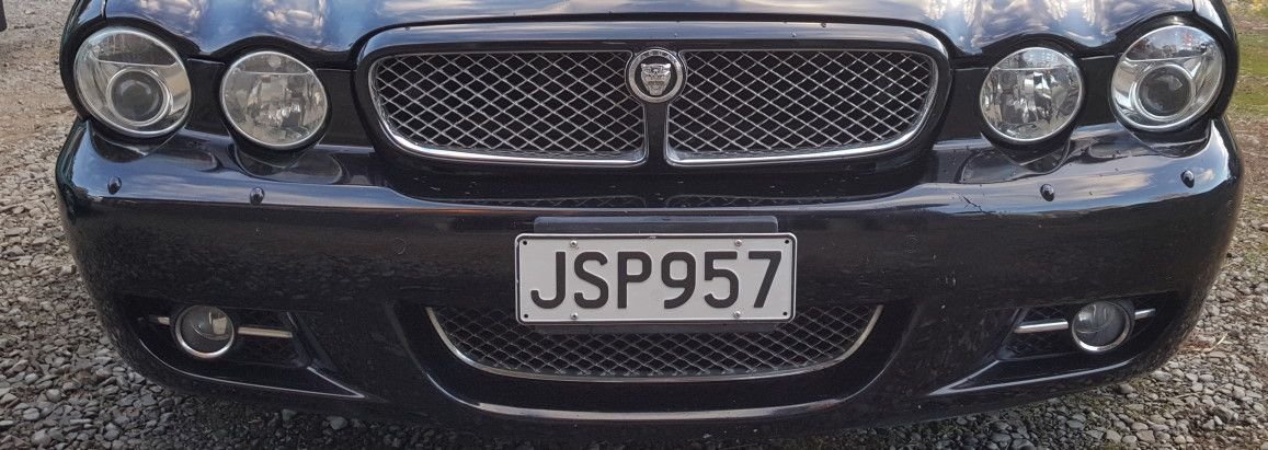

Here in New Zealand we are required to have front tags or license plates, but we call them number plates, even though they have letters on as well. When I got my car the front plate, which is not the same size as US, Japan, UK, was mounted with horrible unsightly screws. The plastic plinth or mount had also pulled the aluminium / aluminum rivets through the thin skin of the front bumper.
I used 4mm alloy rivnuts in the bumper. That gave good support for the plinth, and I was then able to secure the front plate with better looking screws.
Looking a bit tidier and more secure
Mmm, rust stains, ugly screws, loose fitment.
