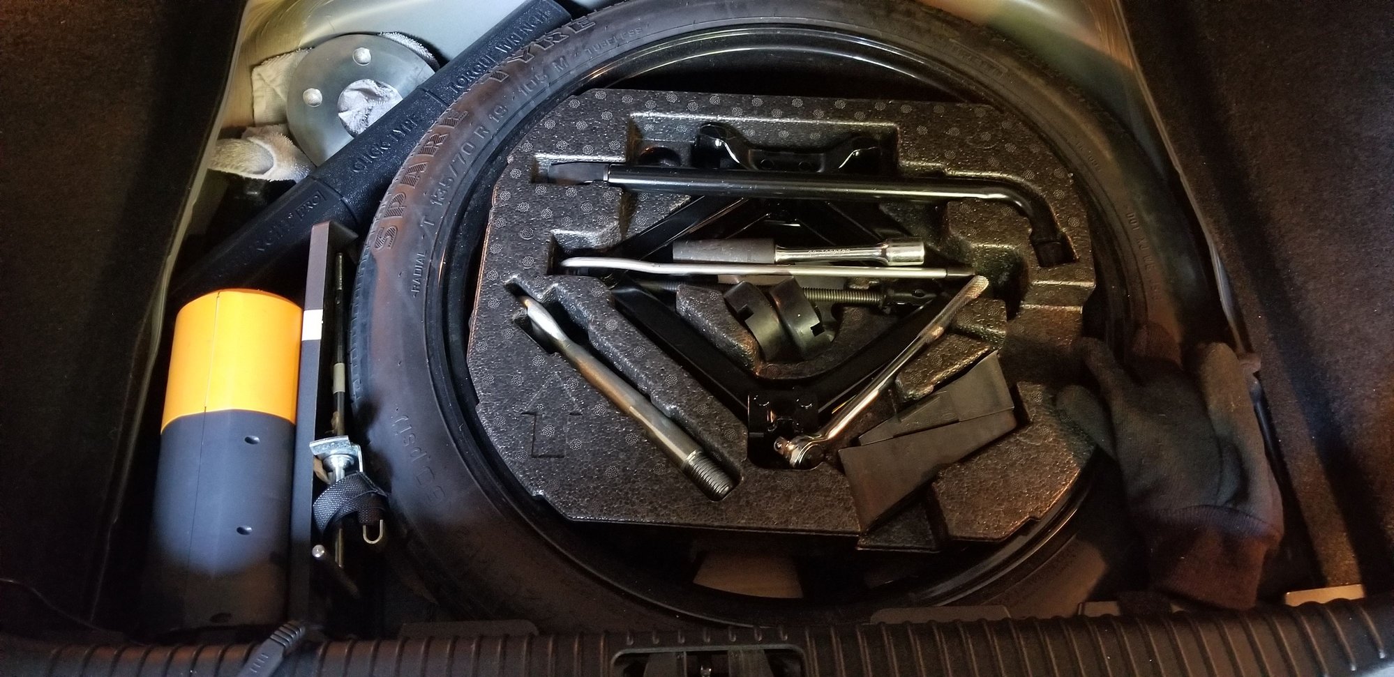

After a lot of digging before I bought my car I found a thread that talks about what size tire fits in the spare area that also works with these bigger breaks, but I can't find it now.
Anyone have the info on what I need to get?

The regular size non-donut spare I got with my 2010 fits fine over the big XKR brakes, but since you have Alcons, they are slightly larger but should still fit. I have 20" wheels on mine, but 19s will fit.
You ARE looking to get a full-size spare, Right???
Do you have the boot 'Spare and Jack Holder' foam, right? Or are you starting from scratch? Entire units sometimes show up on eBay.

I started that thread. Here's the link: https://www.jaguarforums.com/forum/x...-brakes-67260/
My car came from the factory with a molded carpet liner in the well. It had to be removed for the spare to fit - and it's a tight fit. Here's how everything fits in the trunk. The long black plastic case in the top left corner is my torque wrench, and the spacer is above it. That's the 12v inflator with the orange band.The spare fits the front without any mods, but you'll need a spacer for the spare to clear the rear caliper. Everything's explained in the above link.

Cee Jay,
Alcon brake XKRs were fitted with a 12v tire inflator and a spray can of sealant similar to Fix-A-Flat. Since it didn't have a spare, there was no jack or any other tools or the foam holder. Before I put all the pieces together, I kept a Bible in the trunk and prayed that I wouldn't get a flat.

I'm not sure if a full-size will fit, but it's worth a try.

Been there, done that. And the front tire will not fit.
But what's the point really?? Pray that the flat only happens on the front as opposed to the rear on our staggered stance?
On the two occasions I suffered a flat this car, the flat bed was less than an hour away. Three hours later the car was good to go.

I mis-spoke...... not FULL size, but full diameter. Some spares are smaller diameter and mess **** up. I'd never think that a full-WIDTH wheel would fit below the deck.

My OEM Selena wheels are 20" staggered and my spare tire is a 19" donut. That spare uses a taller profile tire that is approximately the same diameter as my 20" tire. As a result, there shouldn't be an ABS warning light. I'm not positive because I haven't needed to use the spare.
