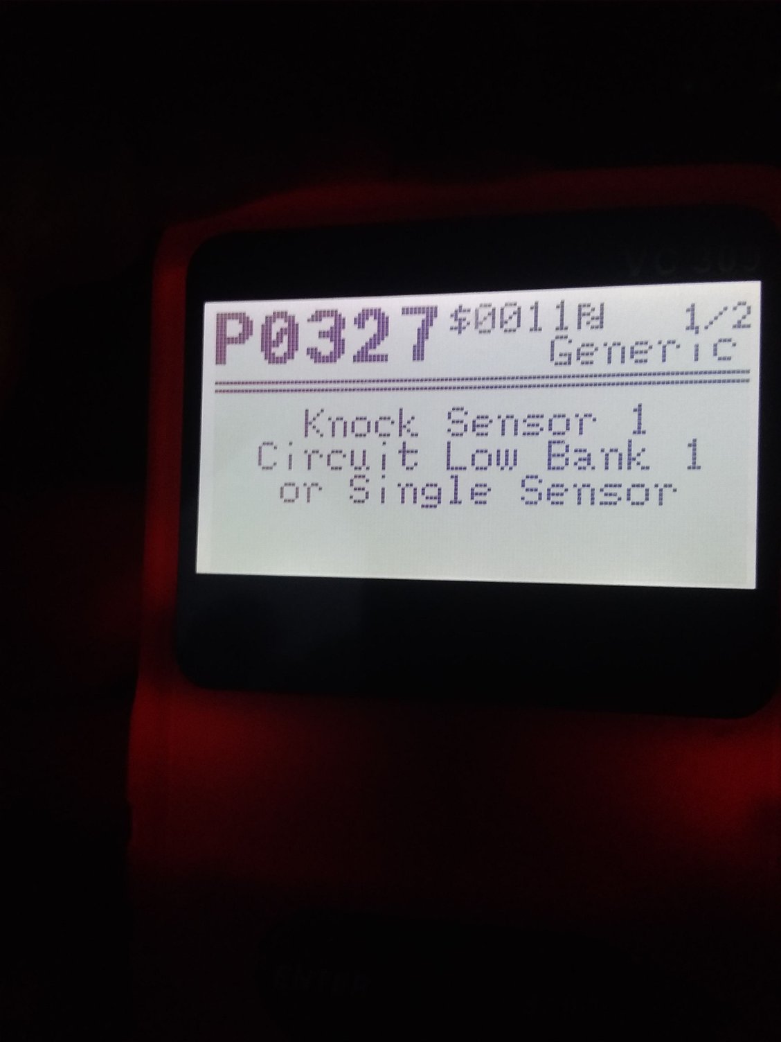

I'm getting code P0327 on my 05 XJ8 which is the "Restricted Performance" knock sensor bank 1.
I have searched for the location for the x350 but cannot find any information to its location (bank 1) and how to remove it. I can only find the location for the X308.
Any help will be much appreciated. Also, any recommendations for possible other issues that will throw the code. Someone has said old fuel could be the issue????
Any education appreciated, but really need the location & how to remove it.
PS The car runs perfectly except for the code.
Thanks!
Richard

Knowing where the connectors were (thanks to Bill's photos), I tested my knock sensors today. The ohms should be around 200 constantly by simply touching the 2 prongs in the connector with a voltage tester. My sensors were fine! I filled up the tank with fresh 94 octane gas and a bottle of Techron fuel additive. I drove the car 100 miles today with the CEL NOT coming on again (restricted performance). It had been coming on a few seconds after clearing the code. I will now also add Stabil to the tank to keep the gas fresh!
Hope this thread will help others now/future!
Richard
