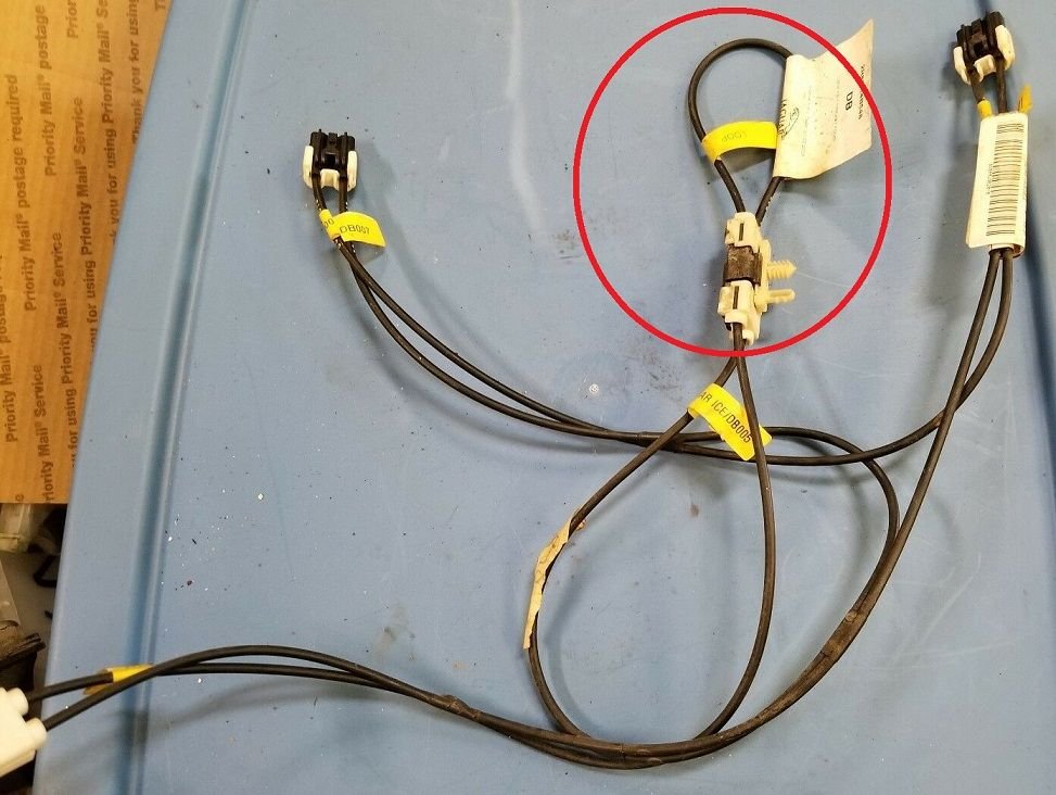

I think you need a Jaguar D2B optic bypass loop to troubleshoot the D2B optic ring. These are common and very useful because you can bypass each different component separately in the D2B ring to quickly isolate which one is bad. Note the components MUST be connected in the order shown in the attached document. So don't get them confused. The good thing is Jaguar does label these different cables pretty well.
Sorry I don't have the JLR part number for the bypass/jumper.
I circled it in red below.
Be sure and note the part number matrix in Karl's document. In case you do want to make changes it requires a unique cable.
It seems the MB/BMW also use the same type of optic ring. But do check your car matches the plugs shown in this ad.
Here is a pair of loops for $15.
Fiber Optic Bypass Loop
Here is a great link about a home made bypass and the optic network.
DIY Optic Bypass
