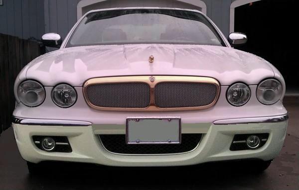

Attempted a little "cut & paste" to view what mine would look like. Except for the color differences, I like it.
