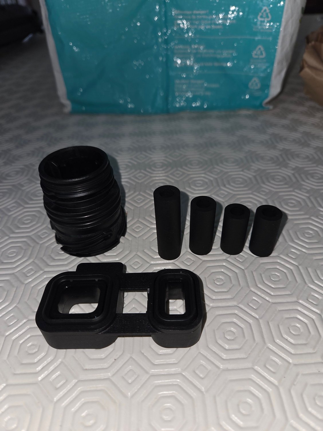

Generally speaking... those tranny can last a very long time but not 20 years and 250k miles with the same oil.
the xj6 I bought may 24 is a 2003 and it only had barely 85k m8les on it. Drve the car just around the block and tranny was lousy.
so I got myself a zf6hp26 oilchange kit and some rubberparts for inside and it helped enormously.
My xj8 4.2 na 2003 that I sold has now 230k miles and still the original tranny ( had an oilchange at 80k and one at 200k .
old oil, and llow evel of oil (mostly seeping at the electrical connector sleeve and sometimes the original pan )are mostly the reason for trouble .the torque converter rarely goes bad. The other thing is - the rear wheelspeed sensors and their reluctor rings being a major factor in input for speed ,abs dsc ,cruisecontrol and tranny
- bad ignition coils on the sparkplugs
If you would just give it a try if an oilchange can make a difference.

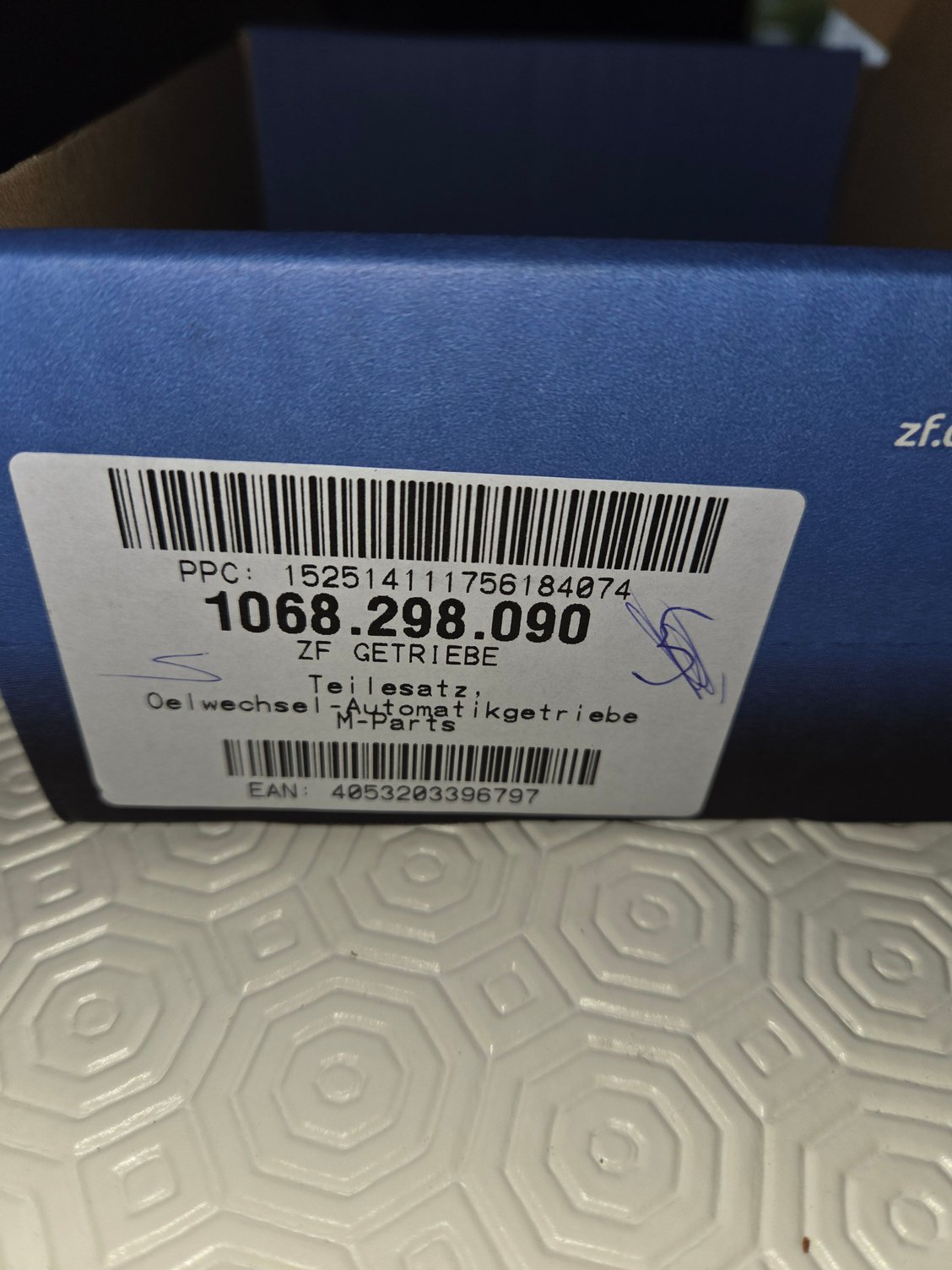

these zf rubber parts just cost like 25€
Especially on early x350 they deteriorated because of the contac5 with the oil and could even get fissures and let the oil pressure capacity drop dramaticly

Posts: 306
Likes: 60
From: germany
Just ordered 1068.298.090 to be prepared on my next tranny oil change. Thanks for sharing.
