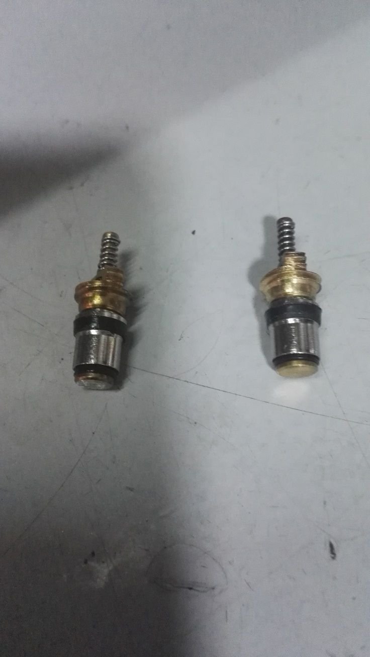

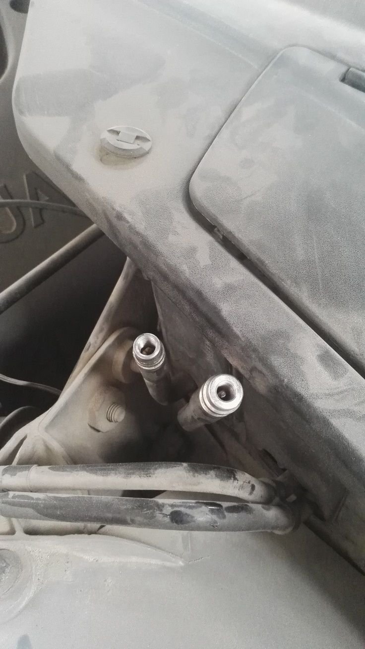

4- Charging Valve: The charging valve was leaking, I fit commercial part but it only lasts 3 to 4 month before leaking again as the original valve is not available in Bahrain. I found the original part in UK (C2S5664) at around 24 GPB (commercial part cost only 3 GPB), but as I said it does not stay long and it is costly to replace the Freon gas every time. Please note that there are two valves (see picture). The part suppliers in UK will confused for the second valve part number. Actually, both valves are identical (see picture). Just order 2 of C2S5664.
