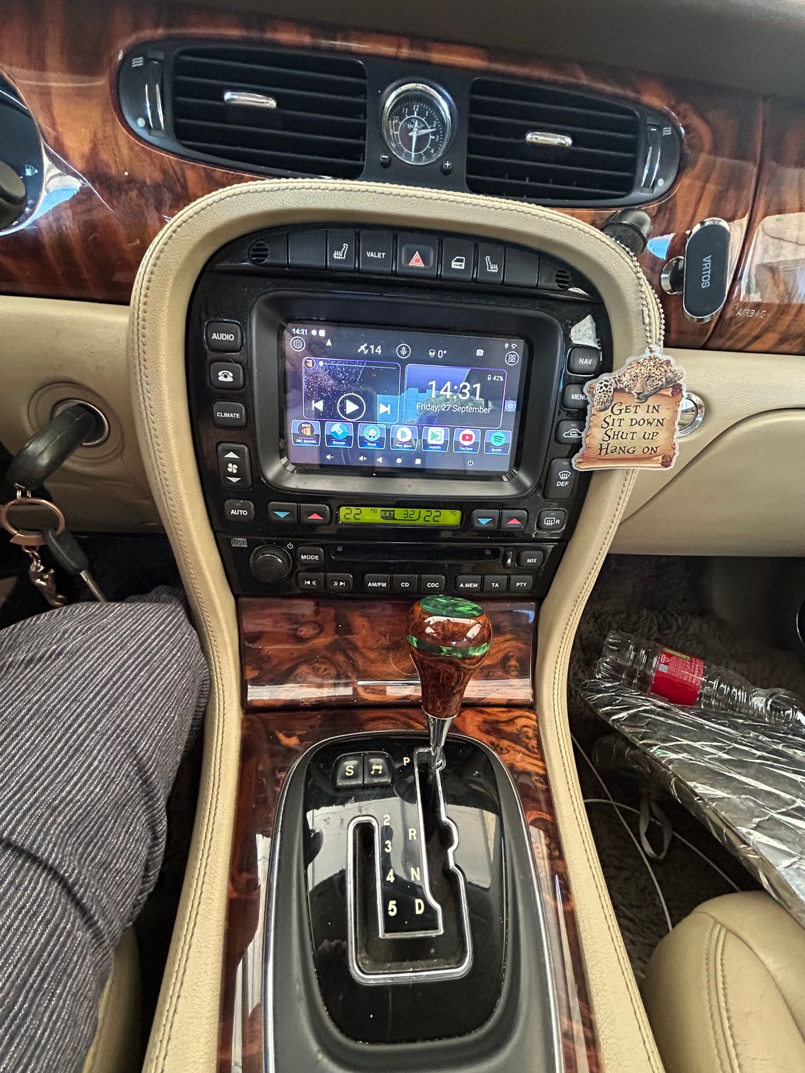

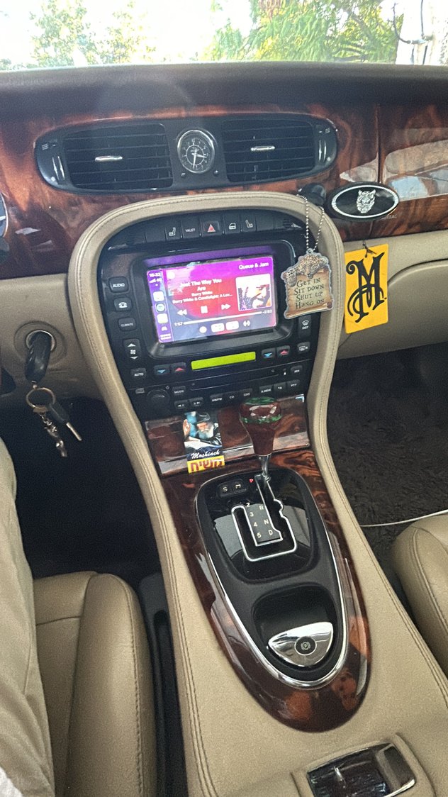

I have done the full jagdroid conversion
very happy with it now despite some initial running problems
great after service and there is a face book group for assistance
it allows you to keep old system with the new one and the unit looks identical.
i did it from abroad and had no problems.
