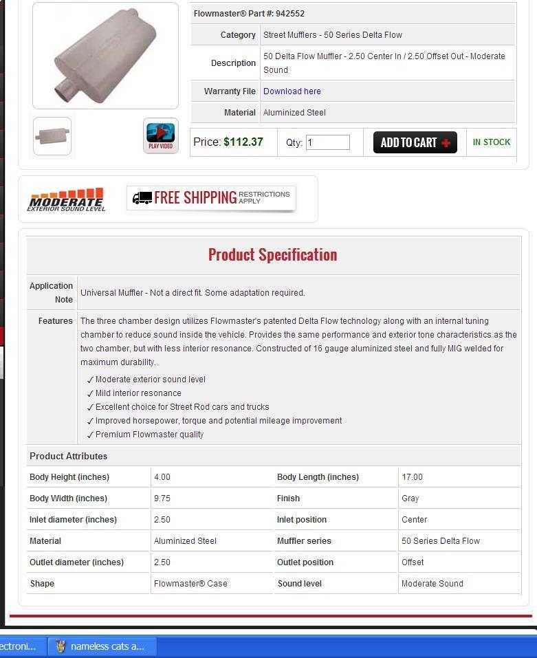

Magnaflow Muffler 6" Round 14" Body 2.5" C/C 14616
And X pipe SS 2.5"
So now I just need to know what size the pipe is and the offset.
MoscowLeaper- "Muffler inlet is 2.25", outlet is 2.25" too, but with an extension for a stock tip."
Does anyone know the stock dimensions for the XJR mufflers? Don't want to buy something too wide.

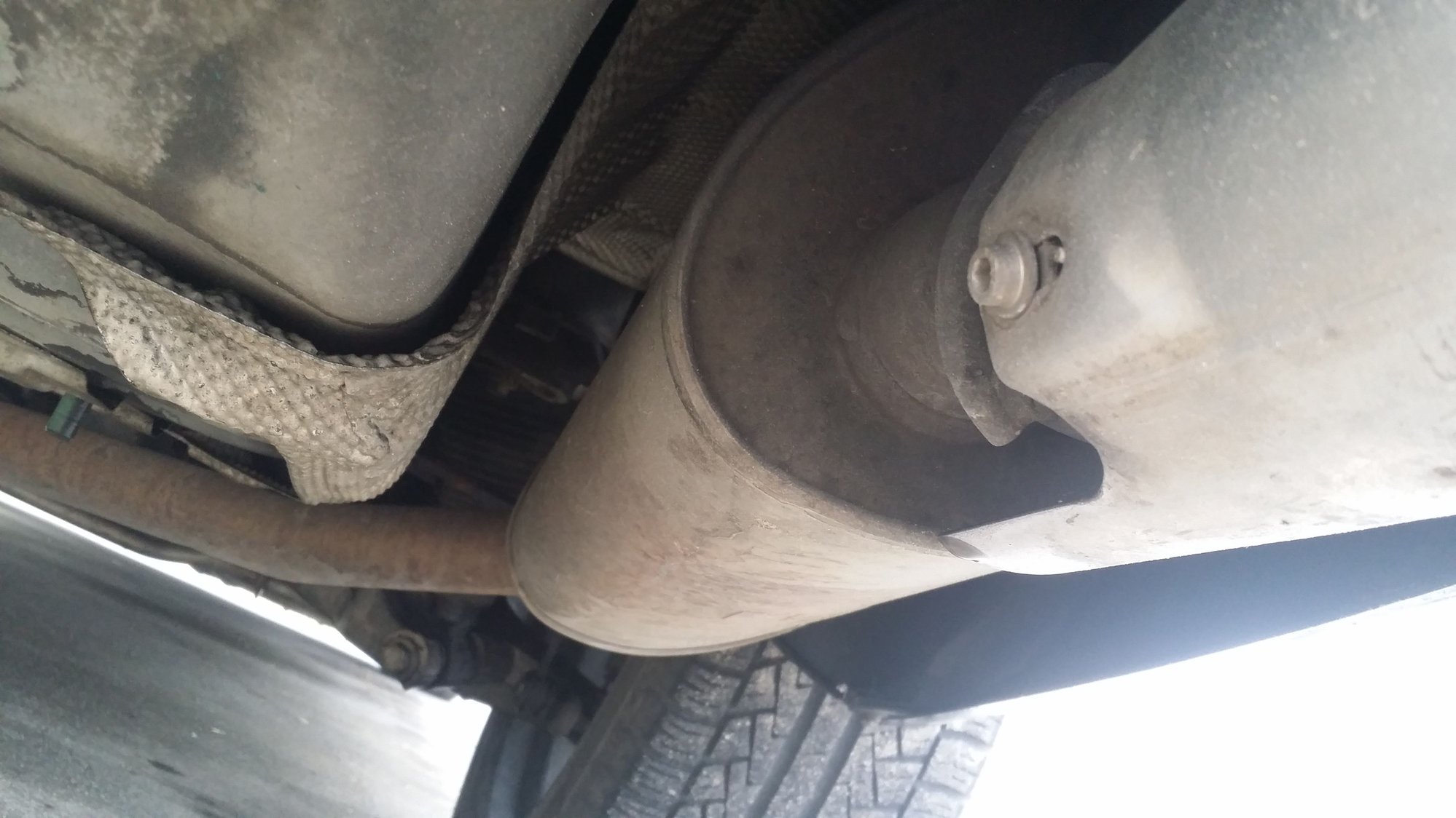

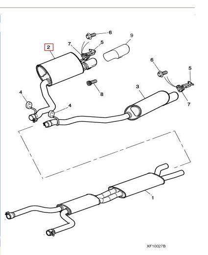

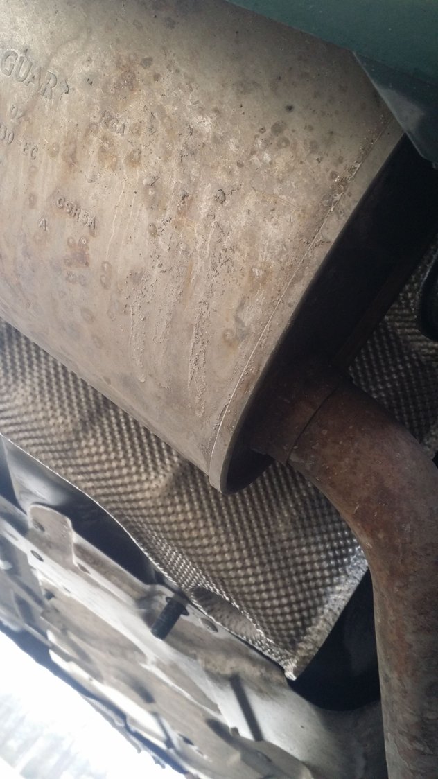

Cambo, Yes I was referring to the rear mufflers. Just pulled a tape on them, looking at ROUGHLY 7"x11"x17"
I was under the impression that they were offset/offset. But from the Diagram, and these photos, it look like they are both offset on the same side, with the outlet being slightly more center.
IN
OUT
You are saying go with center/offset Cambo???

Rear mufflers are best centre mount no need to go oval the mufflers on the cars are huge to say the least and heavy
Just makes sure the guys fitting them centre them nothing worse than tailpipes at different angles
