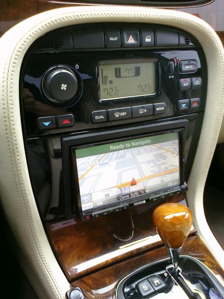

I have a 2004 XJ8 without navigation. Initially I only wanted XM radio capability. I started with a wireless FM transmitter which left a lot to be desired in the sound quality department. I progressed to a wired transmitter which improved the music quality but never really approached the sound quality of my other cars that had direct digital connections. I then tried the Jaguar ACM module. This was fairly satisfactory in sound quality. I then wanted to integrate bluetooth. I checked out my options with the factory OEM stuff, and found out that it would be enormously expensive to go this route. Finally, I decided to bite the bullet and I proceeded to investigate the possibility of an aftermarket system that woulld integrate digital satellite radio, bluetooth, and navigation. My research led me to the Kenwood DNX 9140. This system had Parrot bluetooth and Garmin Navigation which was my preference. I felt this unit would have the least difficulty pairing with a variety of phones, and I was already familiar with Garmin graphic user interface. The only real concern was that I wanted an install that would llook like factory. My local stereo shop did the install and it looks factory right down to the "piano black". They did a custom faceplate that was a perfect match. The system works perfectly and even has the ability to support a backup camera. The only catch is that one cannot acces the SD slot or the dvd slot withouth the transmision being in drive. This is due to the clearance needed for the screen to flip down. Otherwise, I am very happy with the double DIN install. My car now has the latest electronics without having to buy a new car. My shop even added connections so that my steering wheel controls function. My unit even has voice control. The phone book is also downloaded into the unit.
The whole system cost ~3 grand including installation. That's about 1/2 the cost of a OEM system and it functions a lot better. Hope this info is helpful.
I was afraid of that. Take note on this, but some units may have less 'travel' from the deck, so you may be able to find one that say...exits from the top of the unit for more clearance, I think Alpine does that.
How about a pic or two clee?

h20boy -here is a pic of my install. I went with the Kenwood unit because I wanted guarranteed I-Phone compatibility. The Alpine unit did not have this capability when I was looking 2 months ago. I eventually ended up with a Palm Pre and it works perfectly. The unit also has I-Pod connectivity support and USB connectivity. The SD card slot if for upgrading Garmin maps downloaded from their website. Note the black button switch in the lower left corner of the photo-press this button for voice activation of the system.

Wow, you installer did a great job on that faceplate. looks totally factory. Nice unit!

your NAV installation is very nice. Can you confirm a few details? Radio/NAV Unit? double DIN mount kit from where? wiring to steering column sound? using factory amp with wiring adapters? faceplate custom made by installer or purchased? any other details? thanks
