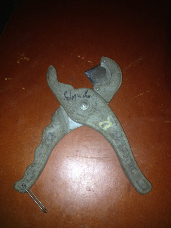

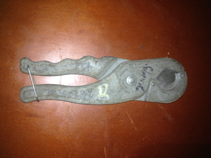

As you pointed out - any replacement of nuts/olives require 3mm to 5mm of the nylon line (.12" to .20") to be squarely cut before installing the nut then the olive with a "guillotine style tubing cutter" referenced in the Air Suspension Training Manual (Blue Point)
(I actually found a Blue Point cutter on eBay and I believe the seller has a few more spares available for sale - I'm waiting for him to get back to me..)
