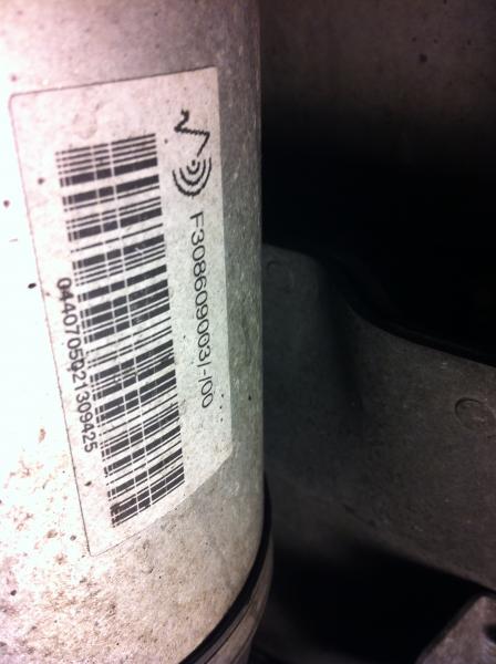

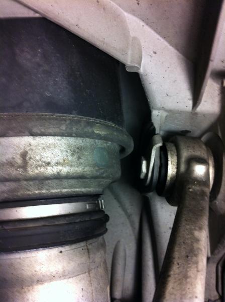

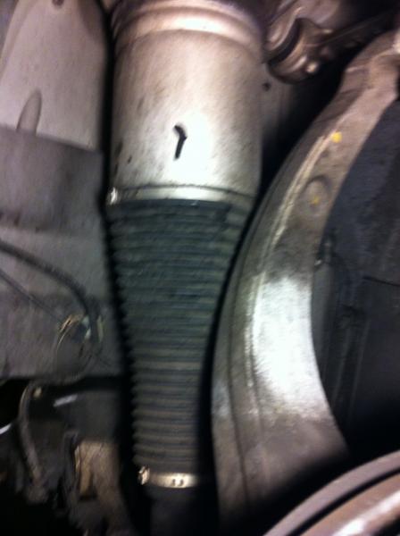

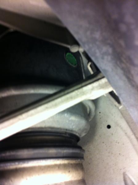

Here's some pics from when I pulled the wheels to verify sport (red dot) or comfort (green dot).
Note the bar code on the driver's shock-does this seem to be an OEM shock or has this one already been replaced? (aftermarket?)
Yes, this is the OEM shock. Good luck with the install. Here is a short video Arnott made on
