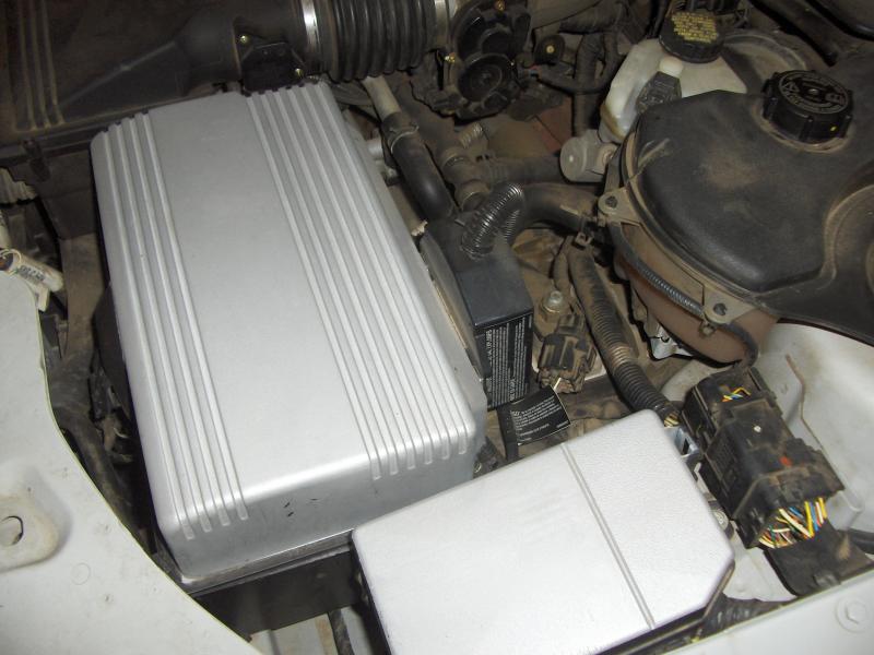

Its a bit different set up with my X-Type but I have my Schumacher tender hooked up to the battery terminals all the time and the unit itself bolted to the back of the battery box. When its parked I just run a cord up from underneath and plug it in. There is a real lack of space to do much else. Works like a charm.
Attached Thumbnails Best Application of Battery Trickle Chargers-tender-001.jpg   Best Application of Battery Trickle Chargers-tender-002.jpg
