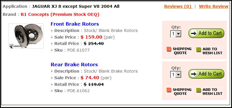

I would go with after market ceramics on the pads. No brake dust. I used Brake Pads:
Front: AKEBONO Part # EUR1065
Rear: AKEBONO Part # EUR806
Got them from www.RockAuto.com
Brake rotors:
Front Rotors: POEF06471 - 120.61077
Rear Rotors: POER06471 - 120.61062
From www.r1concepts.com
