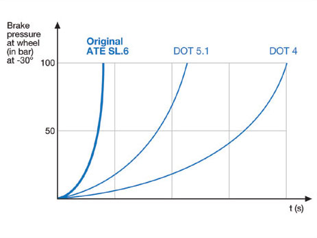

Quote:
I used Pentosin Super Dot 4.
I think if you look on the can it is Class 4. Same as all standard DOT4. You really want Class 6. Other automakers using this same system, like VW, BMW, etc... their owners also complain of strange performance issues when using not using the specified low-viscosity. Both ATE SL.6 and Pentosin LV are rated well, and meet the spec. I use the Pentosin LV myself, and bought a 5 liter jug.Originally Posted by XJ8JR
Yes, I did that a few weeks ago during my crusade against the squeal. Also rebuilt my front calipers at the same time, per your suggestion on the other thread.I used Pentosin Super Dot 4.
http://www.ate-na.com/www/ate_us_en/...bf_sl6_us.html
Quote:
There is a lot of things going on after a reset, and I cannot say this with assuredness, because I haven't tried it, but I would suspect until the relearn process happens, it may be in a default passive mode, until relearn. ECM plays a role. Next time you change fluid, I would highly recommend using Class 6. In fact, that is the specified fluid for this braking system.Originally Posted by XJ8JR
How would the type of brake fluid be affected by hard resets and MAF sensor changes though?

When you first started the thread about your brake squeal, I tried a couple of times to point you to the pads, even recommending original Jaguar parts. It appeared that you didn't want to hear those advising you about the importance. I then took the time to explain how noise is made in that area, and certainly recommended a complete approach, including proper service of the caliper, which should be part of every brake job, and the most ignored, and now we get to the fluid itself. I understand what you are doing, is grasping for straws, and may not understand the importance of the ABS system itself, or the features Jaguar has utilized in the operation. Originally Posted by XJ8JR
I've checked the fuel trims. Seems well within limits both at idle and at 2500 rpm. I've also gone over all the vacuum hoses, brake vacuum hose, and double-checked the torque on the intake manifold bolts. No leaks that I can find.I've also done the sinking-pedal test to see if the booster is working properly. I even did the dollar bill over the exhaust test to see if I had a burnt valve! Everything checks out.
Would back pressure from a partially clogged catalytic converter cause anything like this? Just grasping at straws.
I'm not sure what you are trying to fix, is actually broken, but I will say that not using the specified pads and fluid, does affect the overall performance.
Resetting the car, MAF, and all those other engine related changes are NOT affecting your braking. As you pointed out, if the engine is idling faster, it may feel like it is braking differently, but that is not a change in the braking, but rather a change in the power the engine is keeping on the wheels as you stop.

ESP and ABS is part of the Dynamic Stability Control. They do affect the booster and overall braking.Originally Posted by cjd
Resetting the car, MAF, and all those other engine related changes are NOT affecting your braking. As you pointed out, if the engine is idling faster, it may feel like it is braking differently, but that is not a change in the braking, but rather a change in the power the engine is keeping on the wheels as you stop.If you have doubts, try shifting to neutral and then compare the braking before and after a reset.
http://www.car-engineer.com/esp-elec...ility-program/

Why would you replace your brake fluid with class 6 , it was designed to aid in the ABS operation .
You are not activating the ABS under normal braking conditions .
