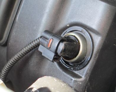

Hi Folks, after owning my car for a couple of weeks i am now working through some routine servicing and diagnosis of my P0171 and 174 codes. I have covered all the ground on the usual suspects of vac leaks and while doing so have come across a previous poor repair of the hard vac line going from under the throttle body to what i think is the evap control solenoid. The outlet from the solenoid has been broken and glued with epoxy, which has broken again.
Can the valve be bought by itself or does it come with the short of pipe going to the throttle body and the much longer length going around the engine bay?

I am unable to asnwer your questions on that piece of rigid plastic pipe, but I did notice in your second pic there is no seal on your VVT - unless you are in the process of replacing it? They are inexpensive and just press in after removing the old one, which has already been done in your picture.

Hi , thanks for the reply, the rubber seal that the VVT sits in is present in the picture or am i missing something?

On second look I can see a seal there but either the original ones were different or the rim of it is push in? Your seal isn't leaking as the solenoid is dry, so it should probably be left alone. I replaced mine for some seepage; they look more like this with a substantial rim around the outer edge.
