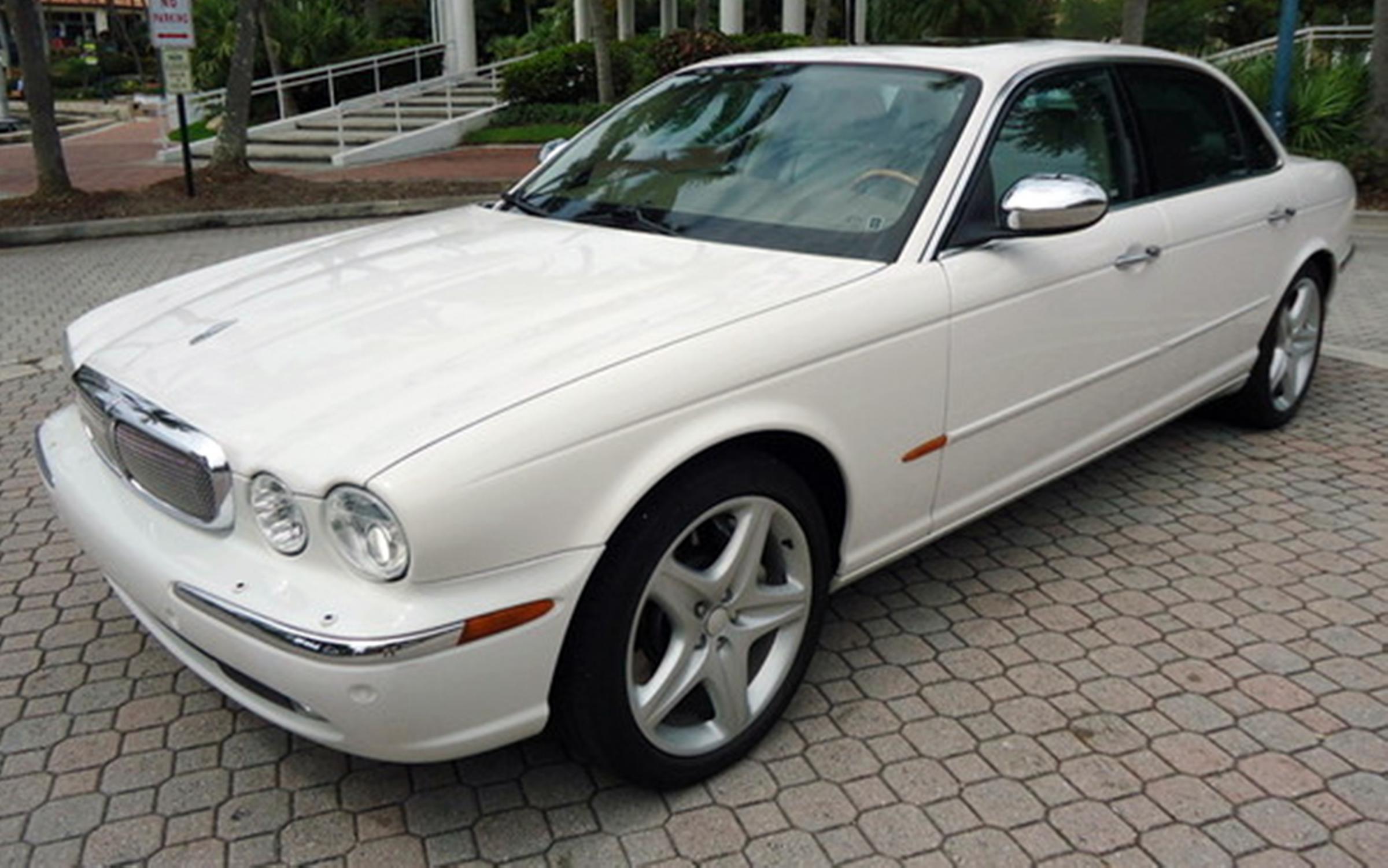

Ok, last minute jitters on a ncie 05 Super 8, 70k, 3 owners, ex-CPO car, seems well maintained but at a dealer so no history but cafax, needs front brakes and maybe rears in 10-12k, and also lower control arm bus now. $16.5, oem paint, non smoker and clean.
I'm aware of but maybe not prepared for the onslaught of maintenance so eyes are wider open(soon the wallet also).
Opinions? Always wanted one, been shopping 24 months and here's one 100 miles away for a decent $ I think.
