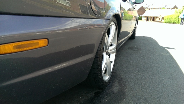

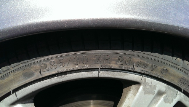

Hi all, just to let you know i fitted 285/30 20s Pirellis on the back of my x358 today on the stock Cremonas with absolutely no scrubing issues at all (my car runs 35mm lower on the back) no modifications made. Its tight but they go!
Fills out the arches nicely and the improved grip helps put the power where it belongs; on the road :-).
Ill post some pics up once ive cleaned the car, English summer, rain, rain and more rain!

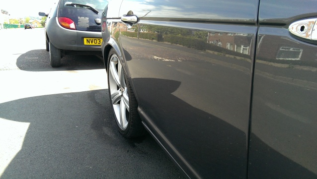

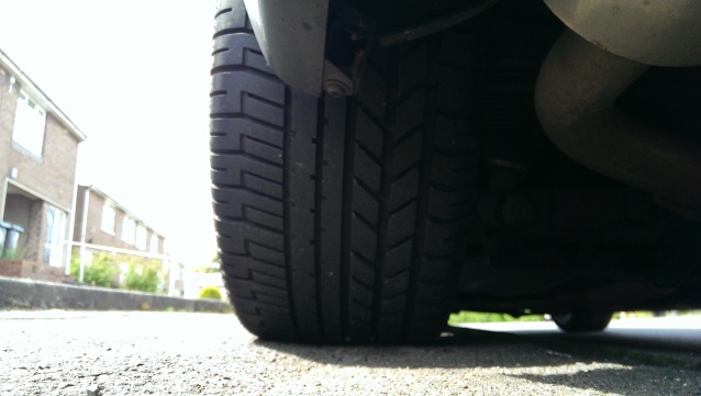

Couple of pics of the xjr with 285s on (please excuse the curbed alloys previous owner did them and they will be getting refurbed soon!)
With the amount of free space under there i would imagine a 295 would go on too as it would only be an extra 5mm each side.

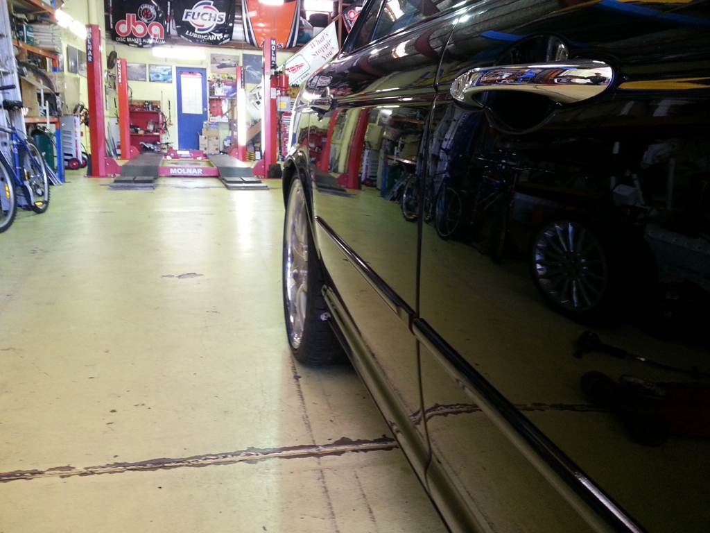

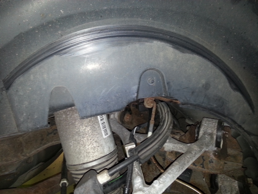

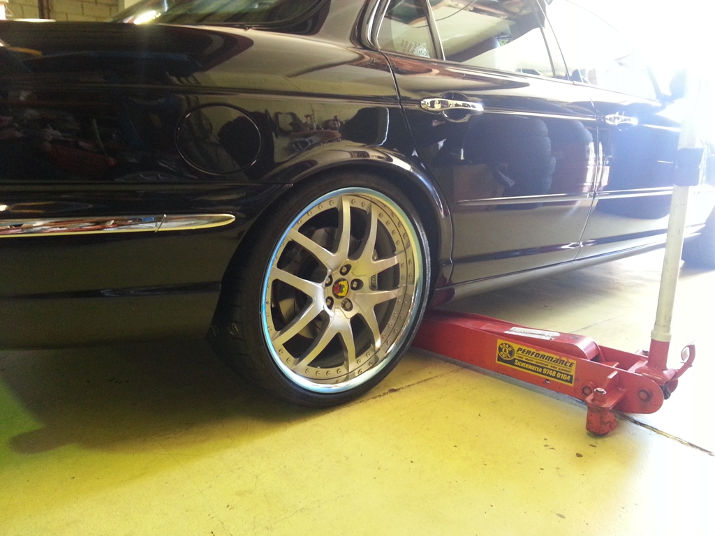

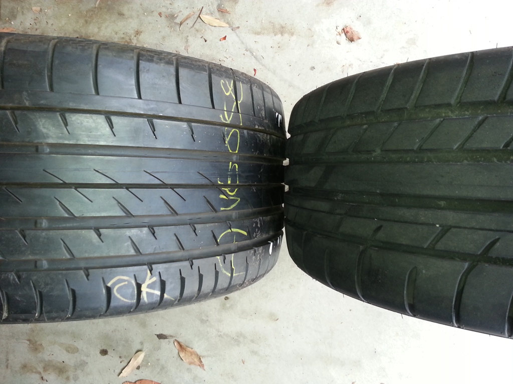

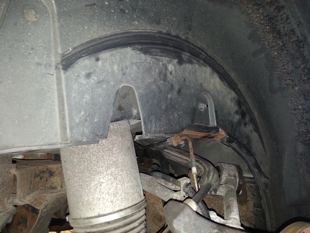

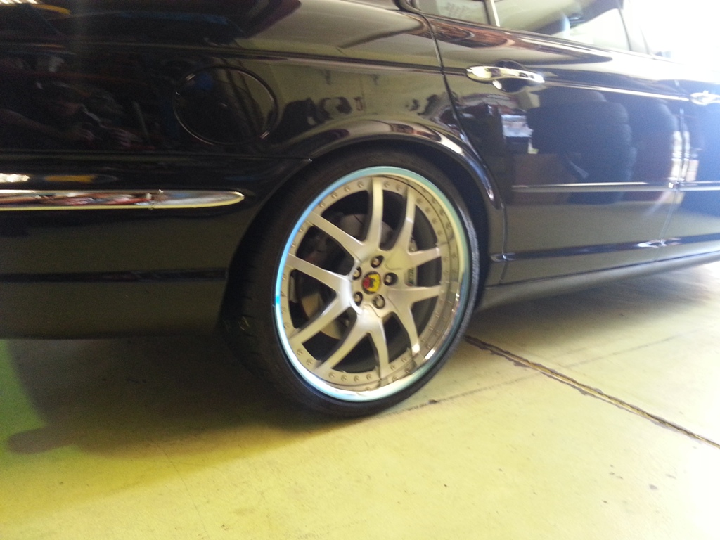

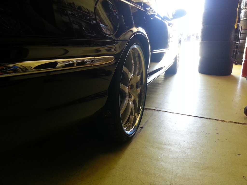

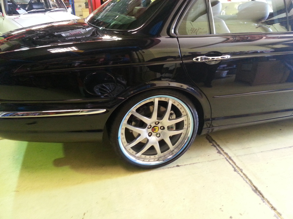

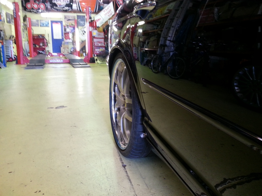

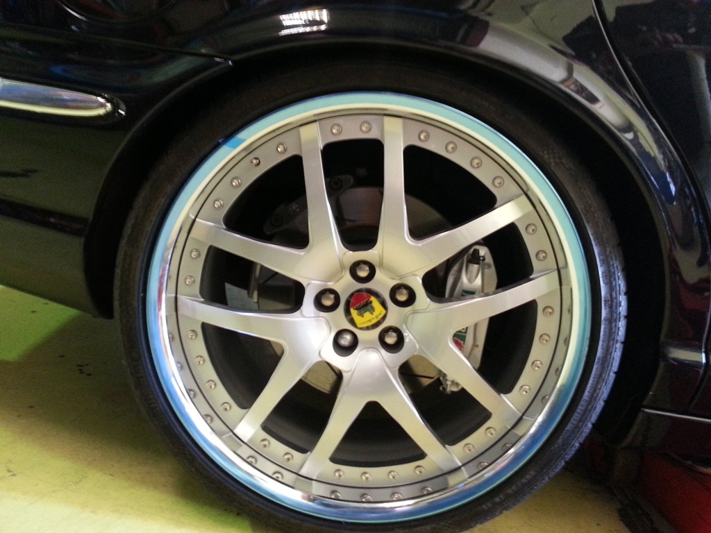

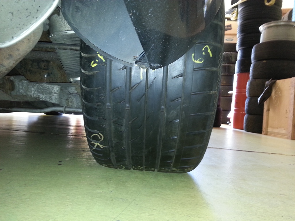

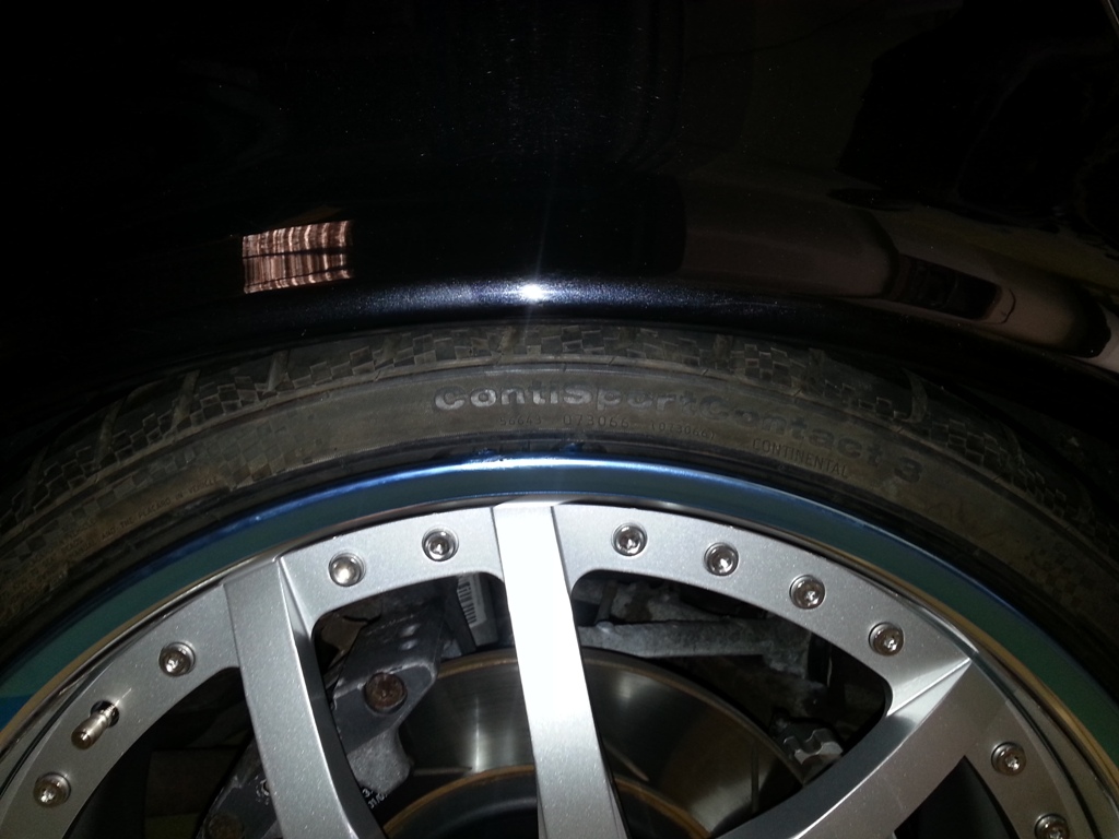

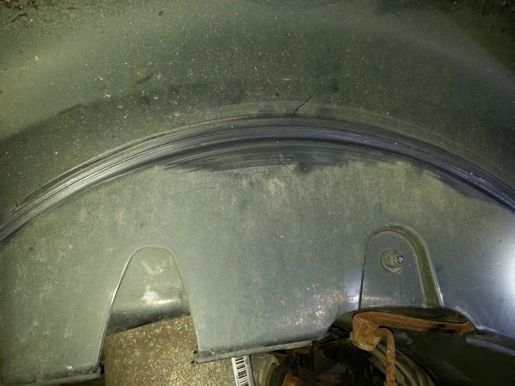

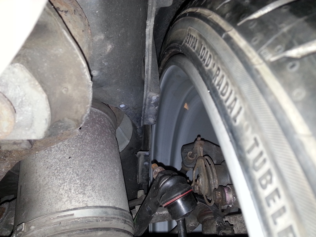

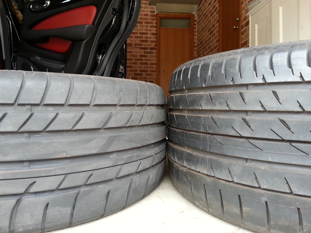

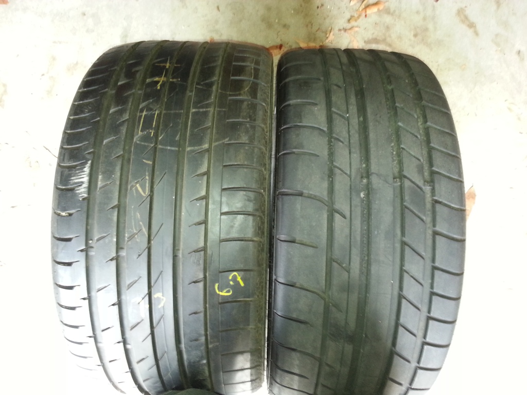

OK, so here it is. The answer is YES.
Arden 21x10 ET50 rim, fitted with Continental 295/25R21 tyre.
But a little modification to the inner wheel arch lining is needed....
Continental 295/25R21 compared to Mickey Thompson 255/35R20
No problem with the outer wheel arch, and doesn't it look spectacular!
However it ever so slightly fouls the inner wheel arch, BUT only by a few mm...

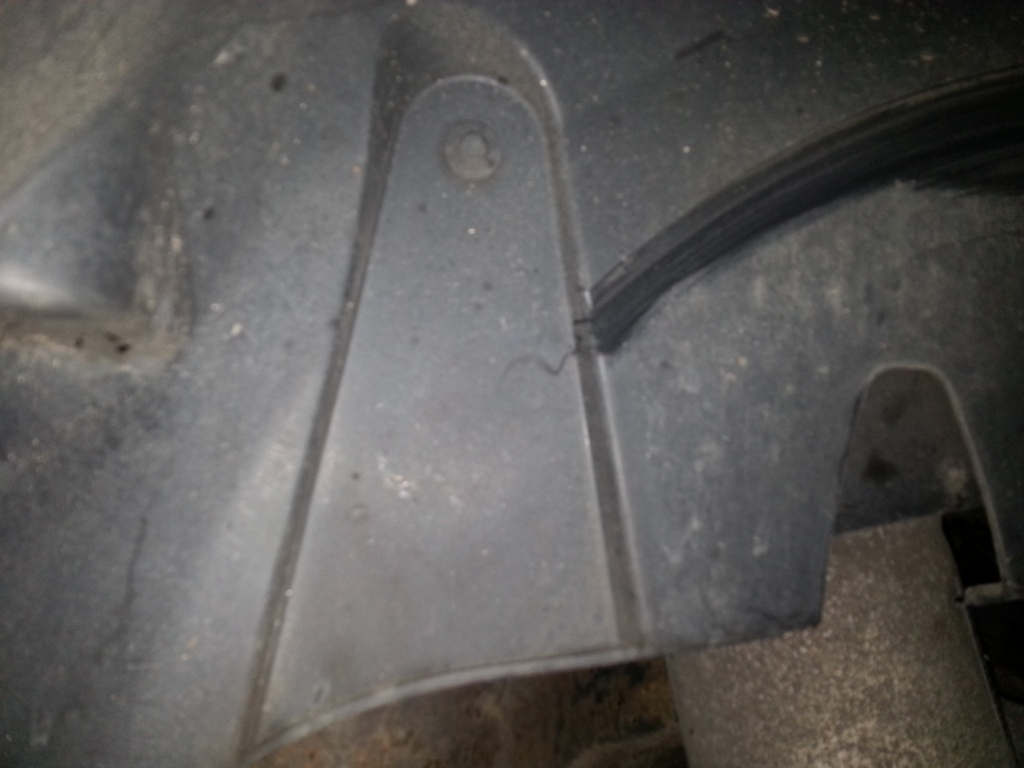

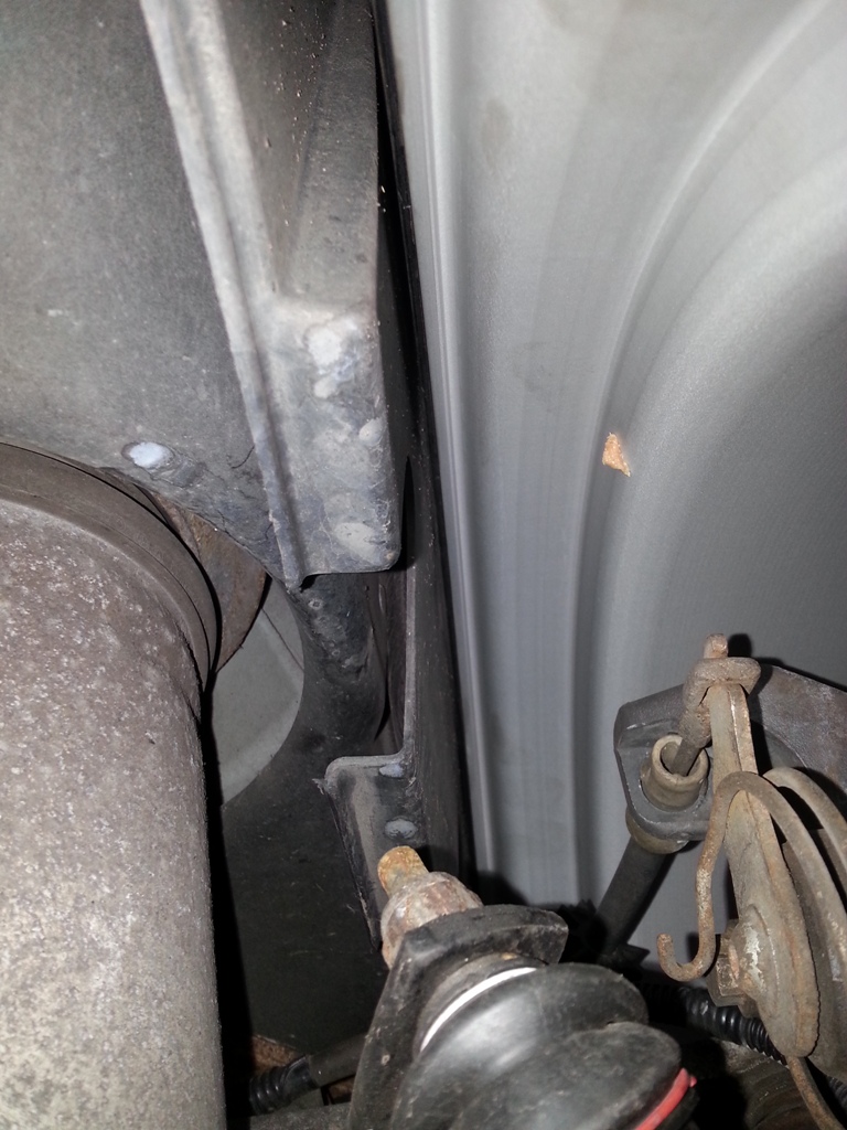

And here you can see the result of the rubbing
See that 2nd pic of the wheel arch liner? You can see how thick & raised up it is.
All you have to do is trim the plastic lining away, there is a good 10-15mm clearance when you take the liner away.
10" wide ET50 with 295's, no problem.
And if you want to go back to stock, the liners are still available to buy from Jag for £63 each.
I guess with a 9" wheel a 285/295 tyre is not so wide, actually it was only the protruding "rim protector" of the tyre that was rubbing.
It can be done
