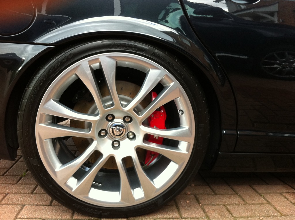

Thread resurrection and all that but I've fitted the below to my xjr, as above I trimmed the wheel arch liner for some additional clearance.

Simon, I am liking the stance of that, are they xk offset wheels? As they seem to fill the arches better .

Thanks guys, yes they're XKR-S Vulcan wheels, 9J ET49 on the front as standard fitment, with 10.5J ET52 rears with 295 30 Pirelli Corsa tyres. They're forged like the Vortex wheels and they certainly didn't feel any heaver than the BBS Cremonas on previously, not the cheapest wheels to get though! The tyres might suit Oz better than Scotland but when they've got some temperature in them it grips like it should.
Matches the Alcons nicely I think!
