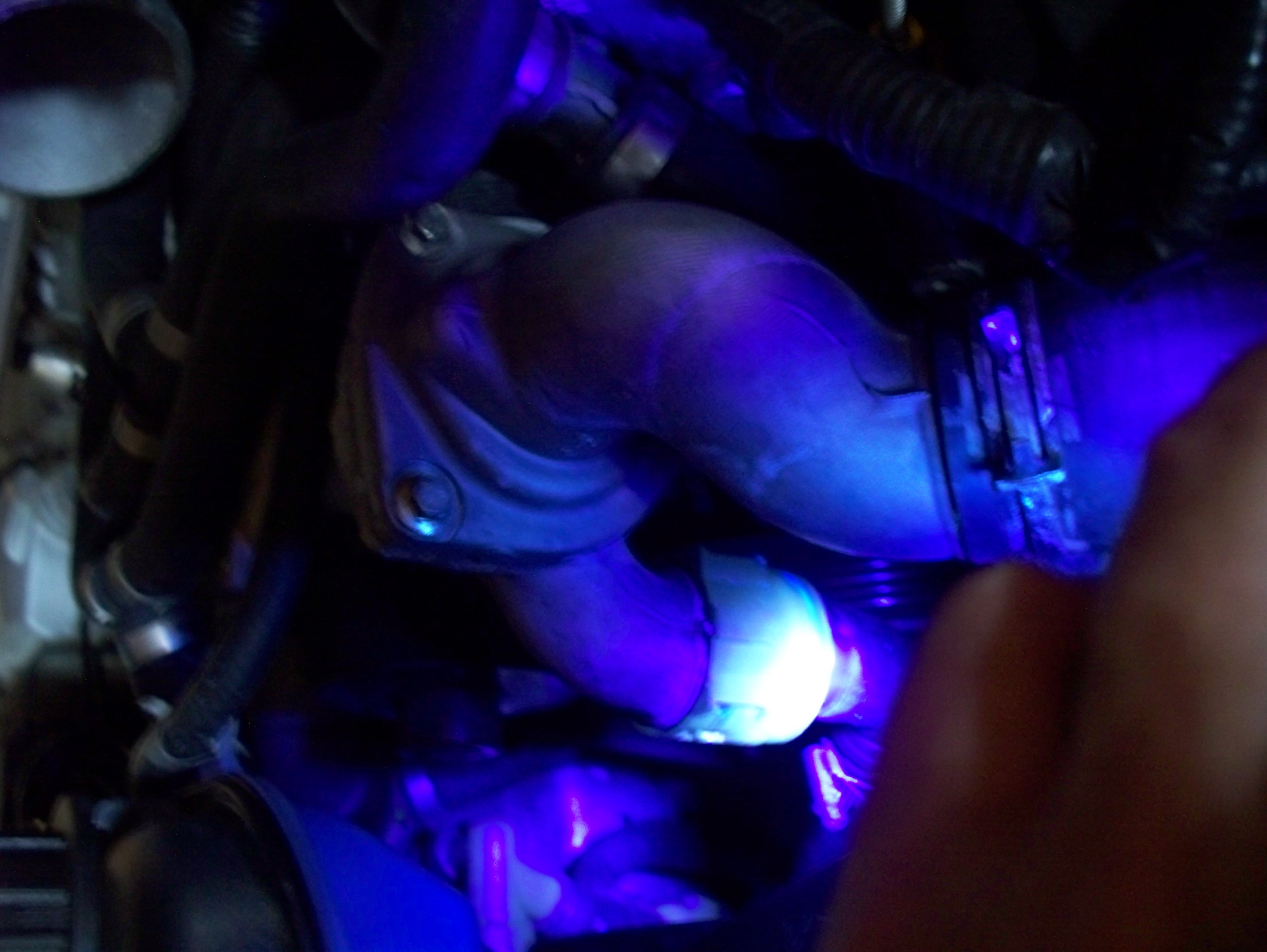

The hose I mentioned comes off the bottom of the thermostat housing and runs diagonally behind the radiator to the auxiliary pump. This may not be an original hose; many of the hoses look like they have been cobbled together from hose bends with straight pipes running between them and this one has a larger hose that was split and wrapped around it and is wire tied to the back side of the fan housing.
Not sure why I was so hesitant to drain the radiator except fear of old plastic parts coming apart and replacements not being available, but the radiator drain opened OK and it is draining now. I'll just have to wire tie the under cowl back again when I put it back on, but I have the Jag in the garage so I can work on the auxiliary pump even if it storms all day tomorrow.

Ok that does not look like an original hose to me Phil. That hose looks very suspect in several places to me.
Mine has the Jaguar pressure clip type clamp where the hose attaches to the T housing.

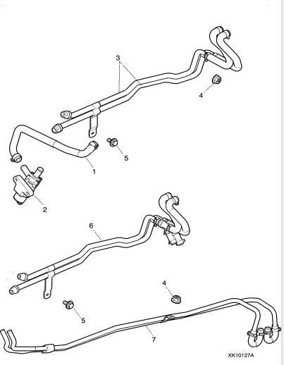

The EPC doesn't show that connector either, but then the thermostat housing it shows for a supercharged V8 doesn't quite look like mine either. It does show the two bend radiator hose with the pipe between so I guess that is original. I can't quite imagine a shade tree mechanic adding that type of connector rather than just a hose and hose clamp, though. It seems an odd choice if it was not OEM.
Attached Thumbnails can I run engine without the MAF connected?-epc-thermostat-temp-sensor.jpg   can I run engine without the MAF connected?-epc-radiator-hoses.jpg   can I run engine without the MAF connected?-epc-aux-pump-hoses.jpg

Your thermostat housing does look different as compared to mine. The aluminum outlet to the long hose looks longer on your unit than mine.
Maybe a difference between 2005 and 2006 model years. Mine is a late 2004 build.

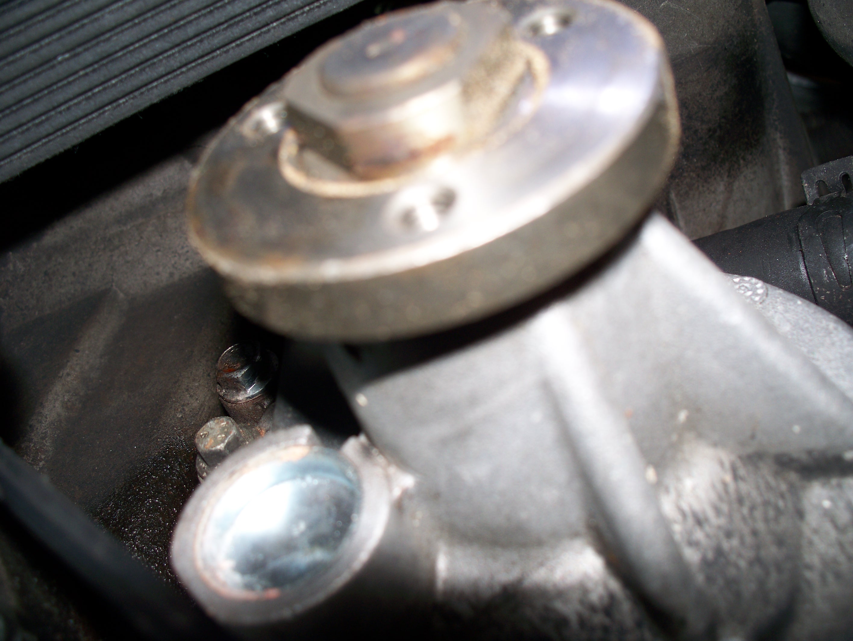

Yeah, it looks different than the EPC drawings too. I took the reservoir off this morning and released that plastic connector from the thermostat housing and it looks pretty groady inside. I'll clean it up and see if there is an O ring to replace. It may be the leak I was chasing.
I got the WP pulley off and didn't see any evidence of a leak on the bottom of the pump or on the inside of the pulley, and the pump feels smooth turning it by hand and I can feel no play in the shaft, but as long as I am this far into it I might as well change the pump just for insurance. Ordered one from O'Reillys for $45 plus tax that will be here Tuesday.
I got the auxiliary pump out and checked it for continuity. On the continuity setting my meter didn't beep, and on the ohms setting it read 4 to 8 Meg ohms - apparently that is too much for it to see continuity. Guess I'll take the pump motor apart and see if a brush change might be possible. It looks like the original Bosch pump.

You probably have noticed but just in case note the slots in pic #4 at 10 o'clock and 4 o'clock in the outer rim of the female plastic connector.
Very important for lining up the male and female connectors.
I missed these the first time!
My water pump seemed to be just fine at 103,000 but since I was in there I replaced it. The original had a plastic impeller and the new one metal.
