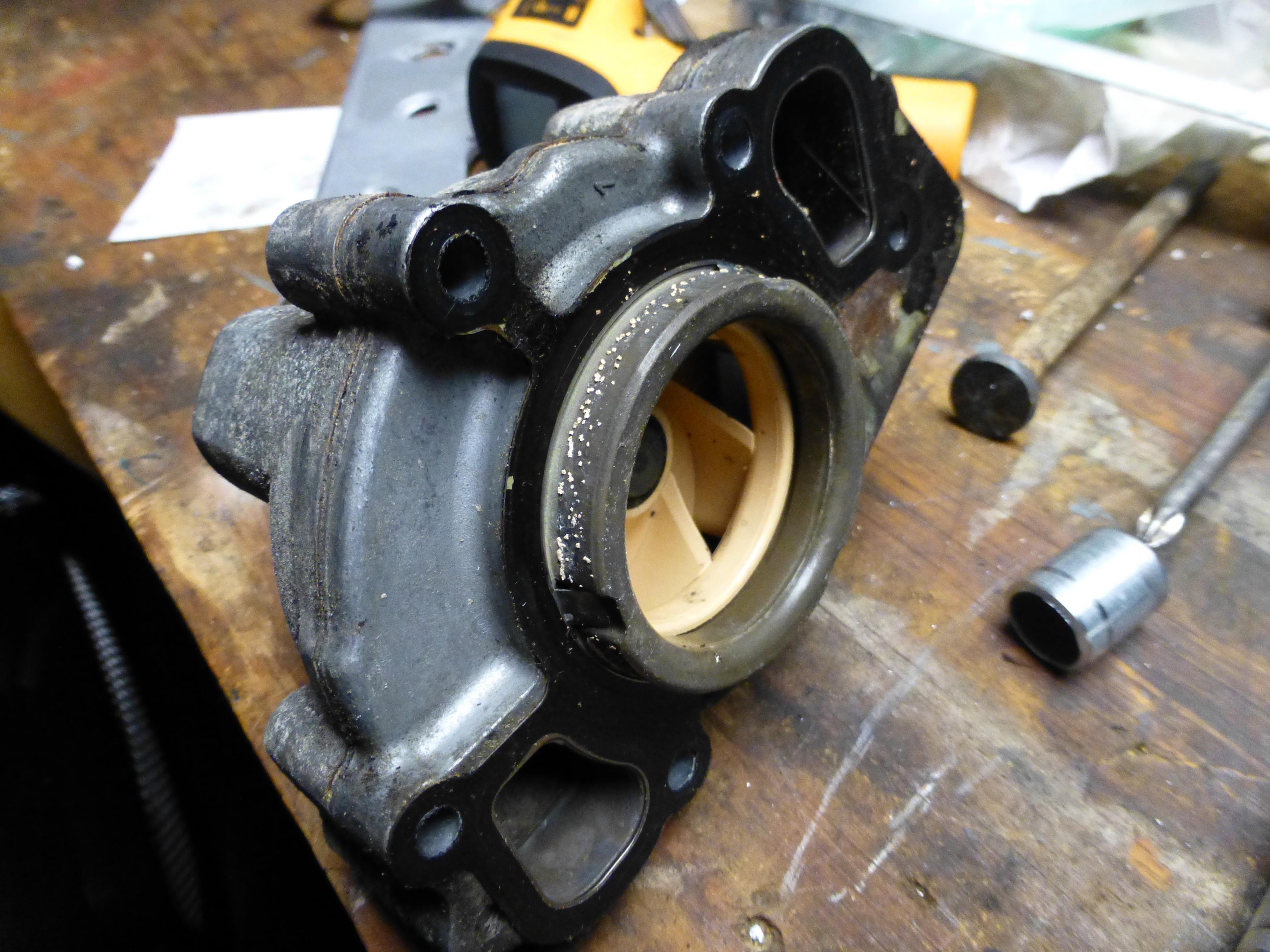

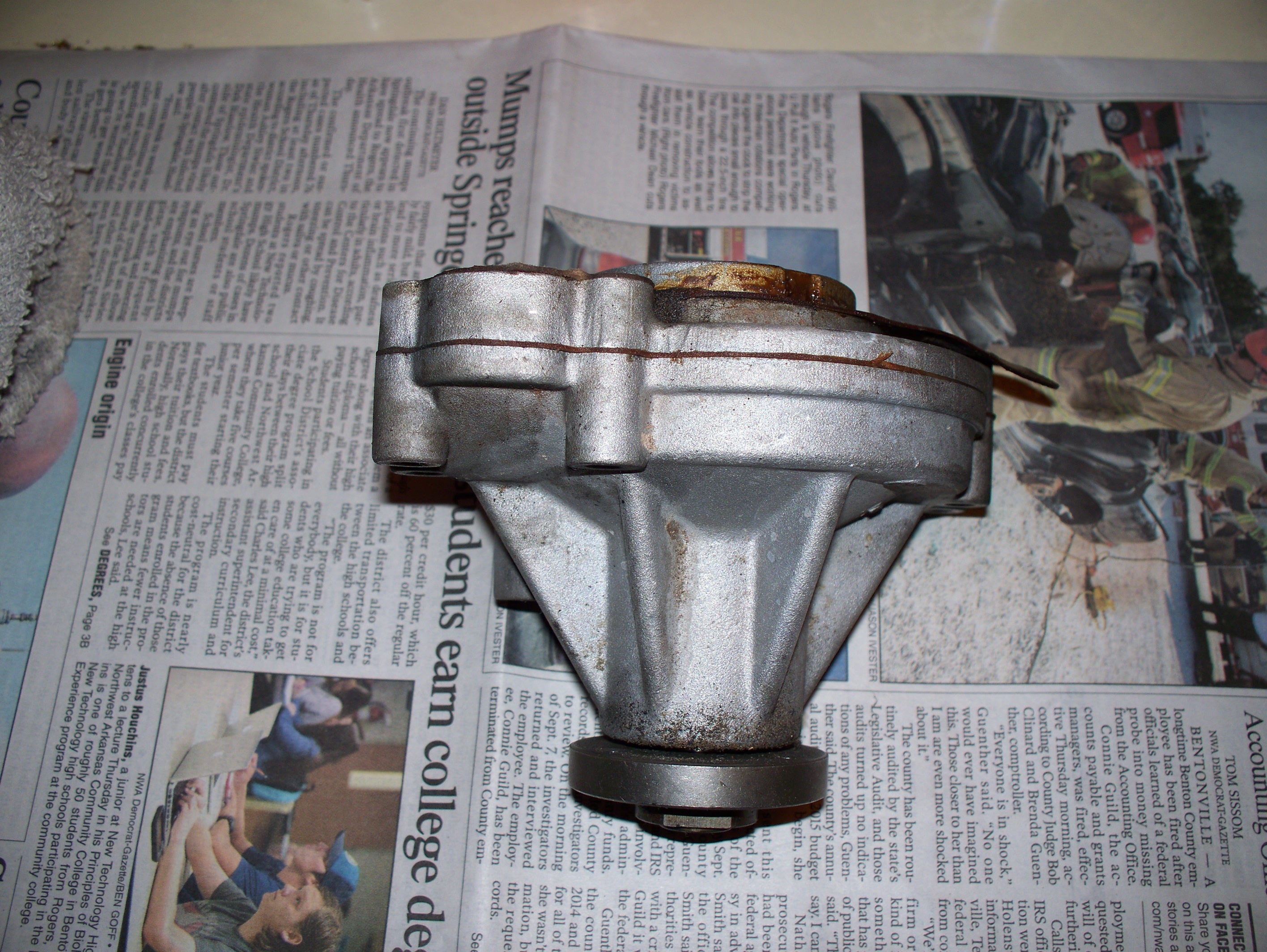

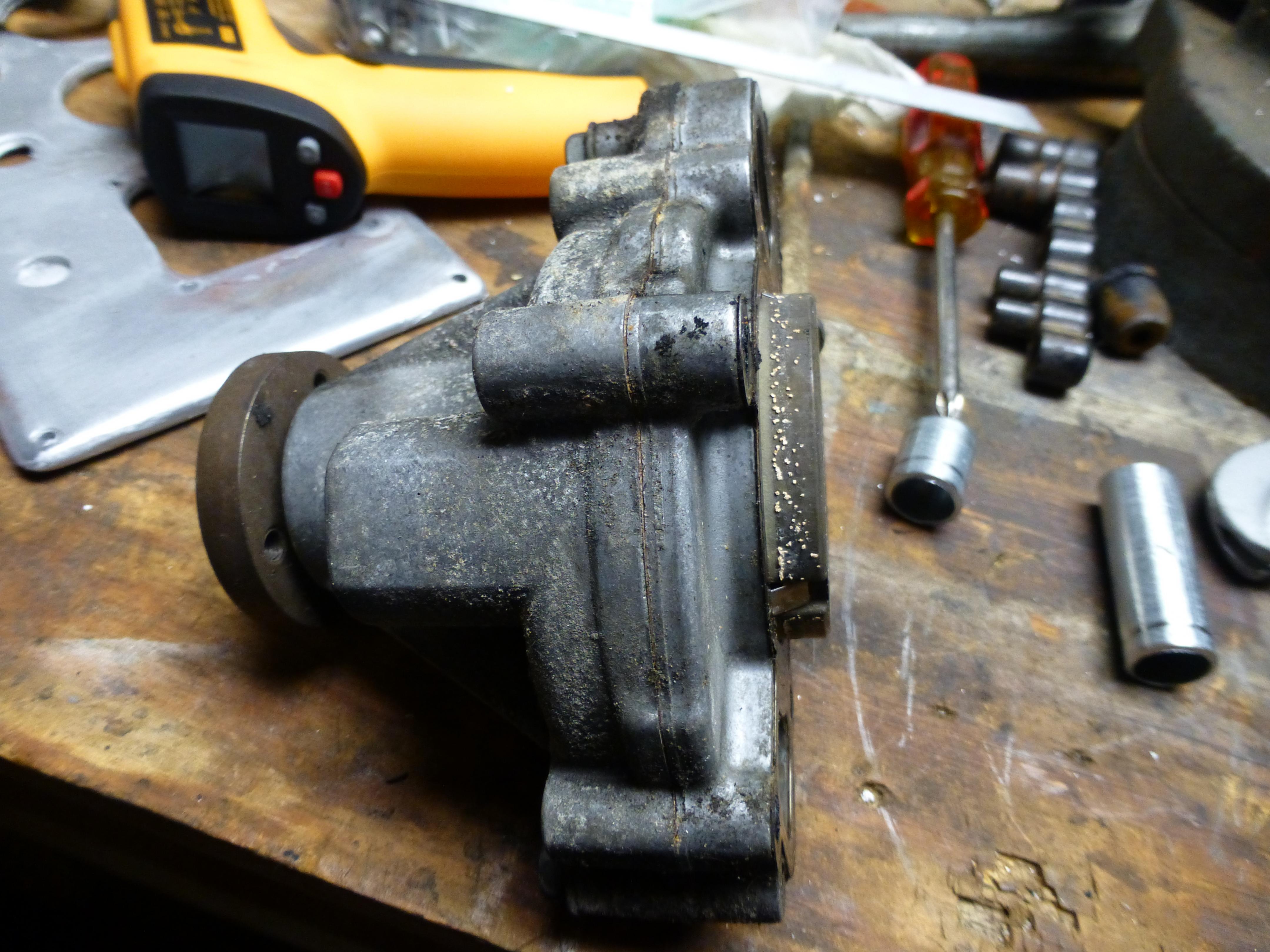

I got the water pump off and it came off as two pieces together and I had to take the Super Charger belt off to get it out. Is this the normal way to change the water pump? Do you split it and put the new pump on the old housing? The one I ordered, (MasterPro Water Pump - Water Pump Line: MWP | Part # 58-612 for $44.99) says it comes with a gasket but did not say two gaskets. Do you normally get both?
The impeller in this pump is plastic, but a hand engraved number on the face of the hub makes me think it is a rebuilt pump. It doesn't appear to have been leaking and the weep hole was on the top, not the bottom, and didn't have any coolant in it.
