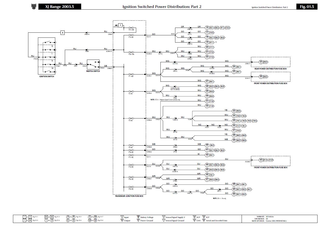

Originally Posted by Box
One, the inertia switch only removes fuel, and does not prohibit the engine from turning over, or unable to get the vehicle out of Park, or release of the EPB.
Not True
As you can see from 01.5 the inertia switch disables a bunch of systems
The Most important of which are in the passenger fuse box
F2 - ECU
F3 - Park Brake
F4 - Instrument Cluster
F19 - ECU, Front Ign Relay, Rear Ign Relay
F33 - TCM, JGATE
Id suggest you check the above fuses have power with the key in Ign II
Without these you wont start, get it out of park or operate park brake
Also the starter relay is controlled by the ECU, without the above it will not crank either
The above is from the MY03.5 onwards. Models before that can be found on page 02.1
For these it disables circuits 6 through 11 which includes the ECU, Gear shift interlock
34by151

Originally Posted by 34by151
Not True
F2 - ECU
F3 - Park Brake
F33 - TCM, JGATE
34by151
I didn't review the wiring diagram, but simply what the Owners Handbook stated. Obviously, it does effect more than just fuel. Good catch 34by151

Remove those fuses I listed and put the key in position II
Check for power at each fuse the fuse box
This will verify the inertia switch is OK
34by151
