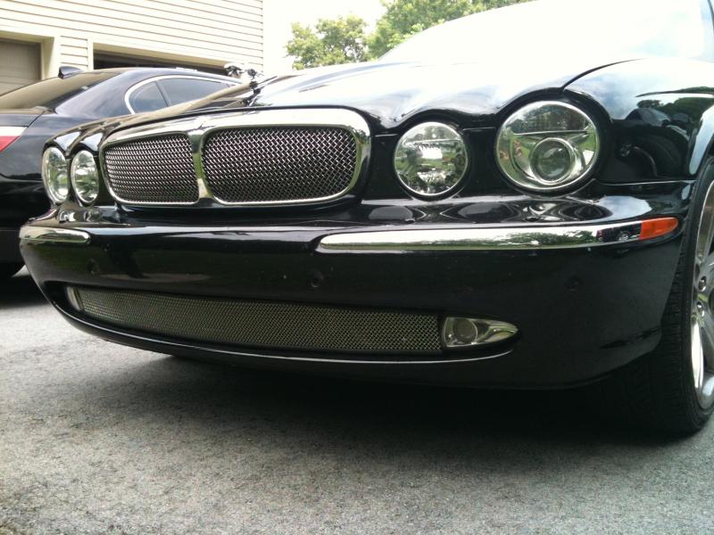

Thanks for the responses guys. Unfortunately, the front driver’s side bag is now leaking. I can hear the air escaping when I shut the car off. Looks like I will be placing another order with arnott. I'm guessing the cold weather has exacerbated the condition. I am now getting the “car too low” and “air suspension fault” messages. Hoping changing out the drivers side will be the end of my front end rattle issues. Here are some pics of the car for those who have asked.
