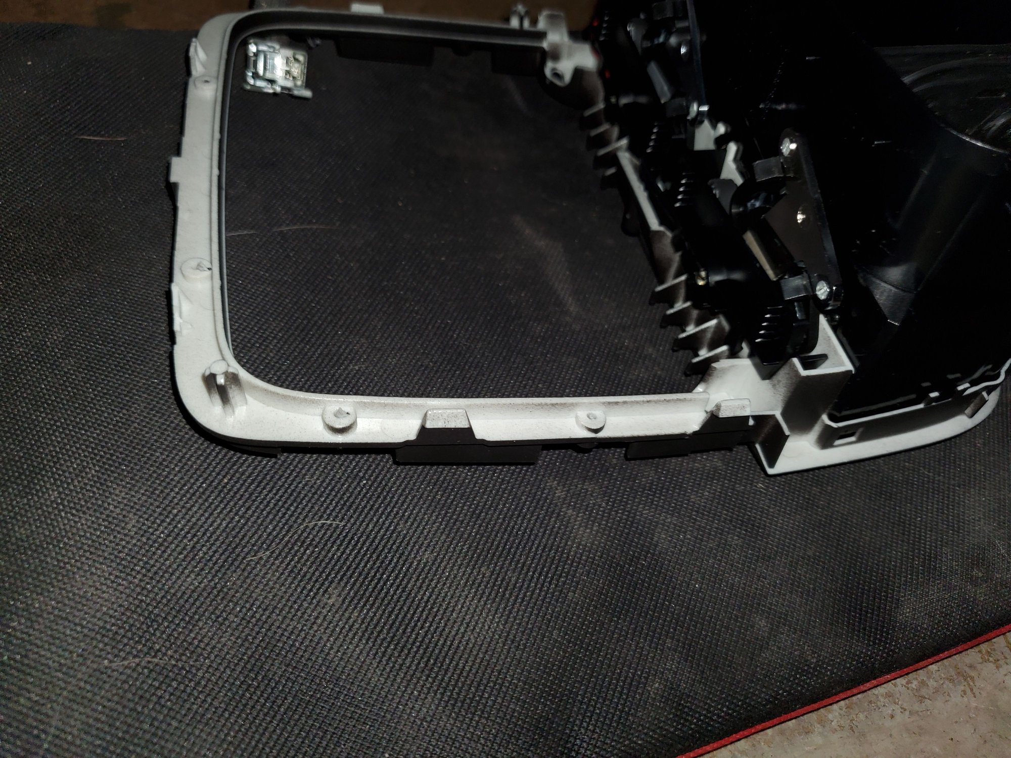

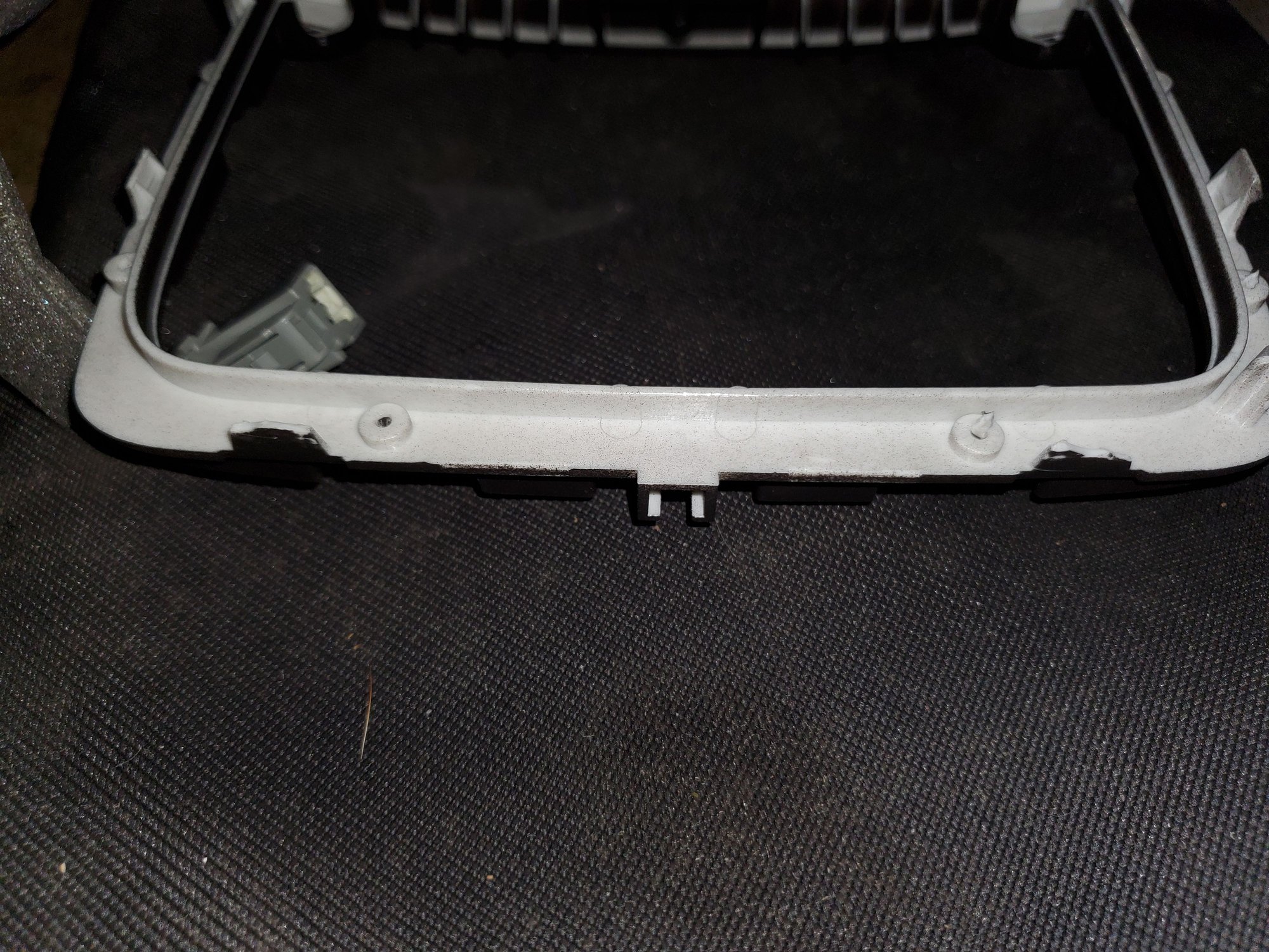

Some may already be familiar with this, but I wanted to pass along a tip regarding removing the floor console with the rear climate control. The correct way to remove it is full disassembly, and not to just pry it off like the instructions say for vehicles without rear climate control. Even with full disassembly, use caution to gently release the locating tabs on the bottom and sides. If these break, the register will not be held in properly. Mine was broken upon purchase. When looking for a replacement, I noticed all of the used ones on eBay and such also had broken tabs. I ended up gritting my teeth and getting a new one. Hopefully this will save others the same expense.

Jeff,
The ACM install pdf stored here has the information needed.
https://www.jaguarforums.com/forum/a...cm-install.pdf
Once the HVAC controls and power outlets are removed, you can reach through the opening and release the tabs.
