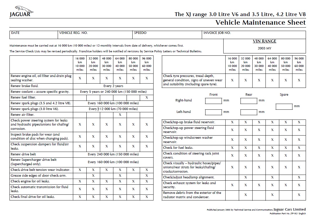

Originally Posted by Sonic
........ I have to change spark plugs due to misfiring. Mileage on my car is 39k kms. My mechanic said its better to change both plugs n coils at the same time. Is it true? ....................
This depends on whether your mechanic has positively identified a misfire on one or more cylinders attributed to a failed or failing coil. Changing Coils is not a regular maintenance item.
Here is the Jaguar Maintenance Schedule for your vehicle:
You will see Spark Plugs are listed for change at 70K/100K miles depending on engine type. Coils are not mentioned anywhere as they are only changed if they fail.
