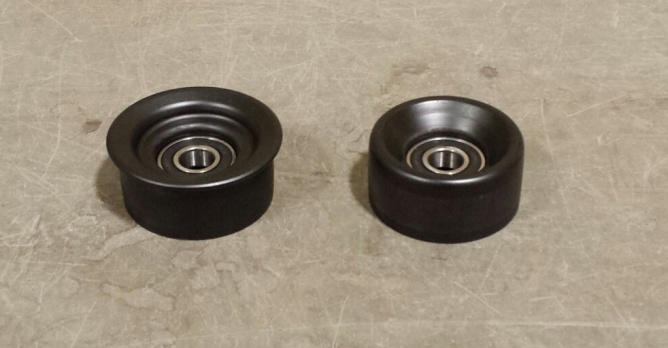

Removed both the Tensioner Pulley and the Idler Pulley, found evidence of a past belt breakup wrapped behind the Idler Pulley.
Old Mar 19, 2014 | 09:13 AM
reyesl's Avatar
Joined: Nov 2011
Posts: 817
Likes: 258
From: Saint Robert, MO
Purchased 2 pulleys and 2 bearings from the local O'Rielly Auto Parts Store at a very reasonable price.
(Purchased the 2 bearings to replace the worn units and will use those as backups if needed.)
Replaced the 2 bearings, looks good as new..
