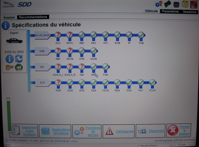

Hello
finally my mongoose works with an old V128 software
I only begin to travel through the main menues ( needs a minimum of practise I think ! ) , and I wonder if someone know what module must be green on the pict screen join ?
Thanks for your help
Philippe
Philippe

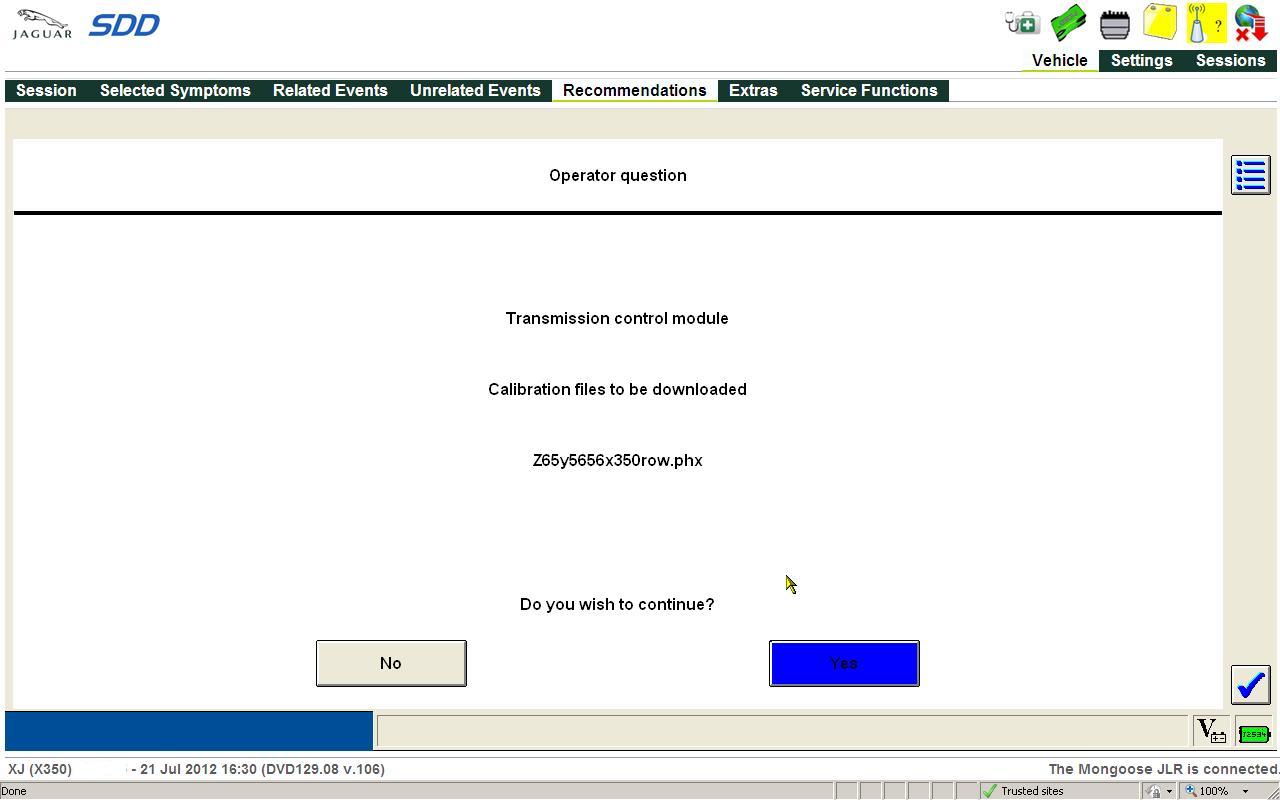

Don't worry about that main screen, it shows up identical for my XJR.
So to get you started:
Open a "Diagnostic Session" 2nd button from bottom right.
The SDD will scan the car, and ask you some questions.
Once that's done, go to the Symptoms Tab top left, and select your symptoms; Powertrain, Engine or Transmission (or both).
It will show you "Related Symptoms" as Trouble Codes, as well as all the codes in "Unrelated Symptoms"
You can see the suggestion actions in the "Recommendations" Tab.
In the related symptoms tab if you see any codes with 100% or a green bar then click on them for more information.
Have a play around with different symptoms, you will possibly get some different suggested actions. I'm curious as to what they might be right now. Most likely "Reprogram Generic Electronic Module" which will probably also incorporate reprogramming the ECU, Drivers Door Module, Instrument Cluster (i.e. security, so have all keys for the car available).
Or you will just get error messages saying "cannot communicate with so & so module" this happens a lot, is pretty much means the car needs a full reflash. I did this once on an X350 but it was more luck in finding the right symptom to kick off the complete process. I don't remember the details as I was freaking out at the time.
If you try this then be very careful, if the software crashes in the middle of reflashing a major module, the car can be completely immobilised (which is what happened to me, hence the freaking out).
Good luck with it. Maybe report back with screenshots of the trouble codes before you plunge in further.
I made a diag session , and with the related symphoms , it gives me the fault code I already knew
when I clic on the P0610 DTC , the suggestion is reflash TCM
I try to open a service function session in order to reflash the TCM
but the service session don't show the "selected systemes" as expected , but a "recommendations" ( same as diag session ) , when clicking on , the programm is stuck and nothing happen ( see attached files )
I don"t think it is related to the mongoose , but maybe from the software
I was thinking to be very near the solution to go back on the road , but not yet !
As long as I can't use the service session , I will not be able to go further

You reflash the TCM from the Diagnostic session, after selecting your transmission symptoms (and the SDD scanning the car) the Recommendations tab will have the option to either program a new module, or reprogram an existing module.
EDIT
I just had a look through some of my old screenshots, yes it's definitely in a Diagnostic Session. If you have selected the transmission symptoms, then the step to reflash the TCM is under the Recommendations tab.
You have to do a Diagnostic session.
EDIT
