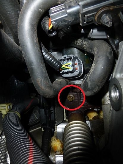

Just a note on EGR removal?
First the bolts and nuts will be rusty from heat and age. Be sure and use a 6 point socket ONLY! People have got into this and those EGR bolts are sometimes known as the "Evil EGR" bolts! Be sure and get straight on the bolts before trying to loosen them. If you round the heads off (and people have!) then it is a much bigger problem!
Here is a thread that I stole the above picture from that might help too.
Remove EGR

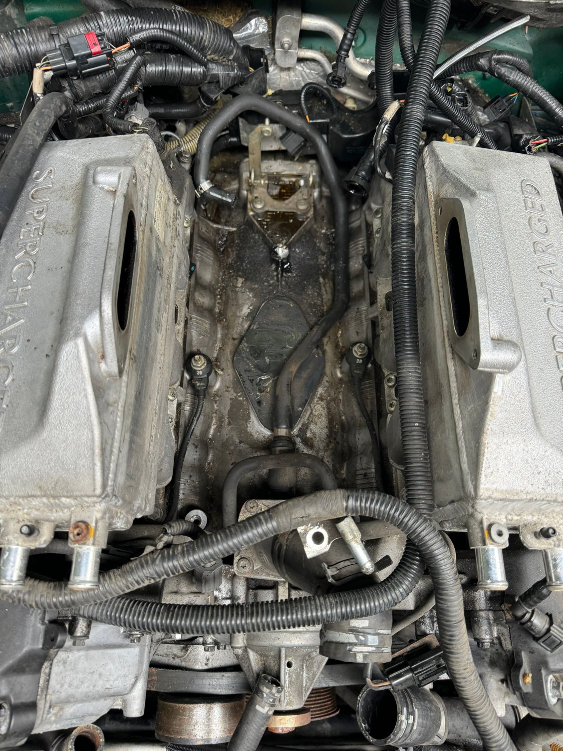

Well Crap!!!!!!
The supercharger is out, but.....
It's dry underneath. Nothing wrong with my valley hose.
Ignore the water at the top of the images. I'm doing this job on the driveway and it's been raining the last couple of days.
So now I'm sort of screwed. I guess I didn't need to take this out after all. I still don't know where the leak is coming from. I might just get this all back together only to have it still leaking.
I'm going to get back on the Harper Jag site and start figuring out which of the hoses I want to order as replacements. I'll change the valley hose for sure. And, I'm going to order a new water pump.

You are one of the few that the valley hose did not leak on? I wonder if it might have been replaced before you got the car? It's looks fine with no swelling where the large hose transitions to the small hose. That's where they all leak!
It's a well known failure so I think you are wise to just change it along with the rest of the repairs. The car is 20+ years old now.

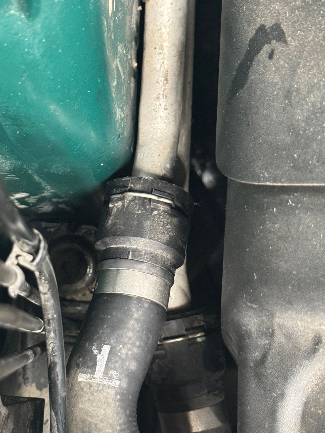

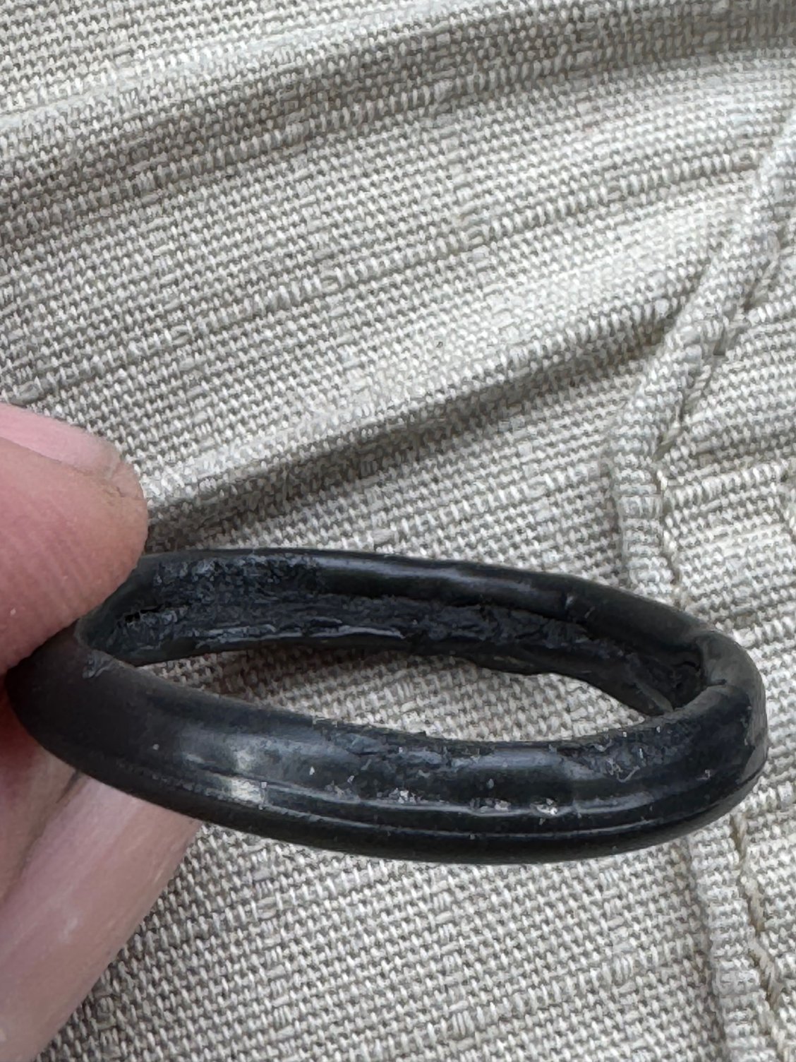

So.... I finished reassembling everything, double checked all my connections, and refilled the coolant system. I started the car and was pleasantly surprised to find that it started right up. However, coolant came pouring out of the car and all over the driveway. Now that I'm familiar with the system, it didn't take me too long to find the leak. If you are looking at the car from the front, on the left side of the engine, there are two rubber hoses that connect to metal pipes. Coolant was pouring out of the top connector. I pulled the metal clip to disconnect the connector and using a dental pick, removed the O-ring that was inside. The O-ring was gummy and the cause of the problem. Here's the connector in question:
And the O-ring:
I went to my local auto parts store and bought a replacement O-ring for $1.09. I could've done this whole job in about half an hour for a dollar instead of the $900 I've spent on parts so far. At least I know that the hoses I have replaced should never cause me any problems for as long as I own the car.
I have gotten a check engine light a few times. P1000 and P0322 are showing when I hook up the iCarsoft scanner. I've cleared the codes and they don't seem to be coming back. I think it probably needs a good long run.
But here's my really big problem. The front shocks are flat on the ground!!!! This was not an issue before I started the valley hose job. I have previously replaced both front air shocks and don't suspect them of being the problem. While working on the back side of the engine, I laid moving blankets along the fenders and over the shock towers to prevent scratching anything. It was hard to reach some things and I ended up laying on top of the shock towers quite a few times to reach the back. I'm worried that I have damaged the air lines somewhere. The front left shock deflates fastest (within an hour), but after a short while, both front shocks will be bottomed out. The rear doesn't seem to be affected. I have sprayed the top of the shocks (where the air lines come in) with soapy water, and don't see any bubbles. I also sprayed the spiderweb of metal tubes on the left side of the engine bay (think they are the air distribution lines) and no bubbles there either. After starting the car and waiting about 2 minutes, the car comes back to normal height, but there must be a significant leak somewhere.
Any suggestions as to how to track down my air leak?
