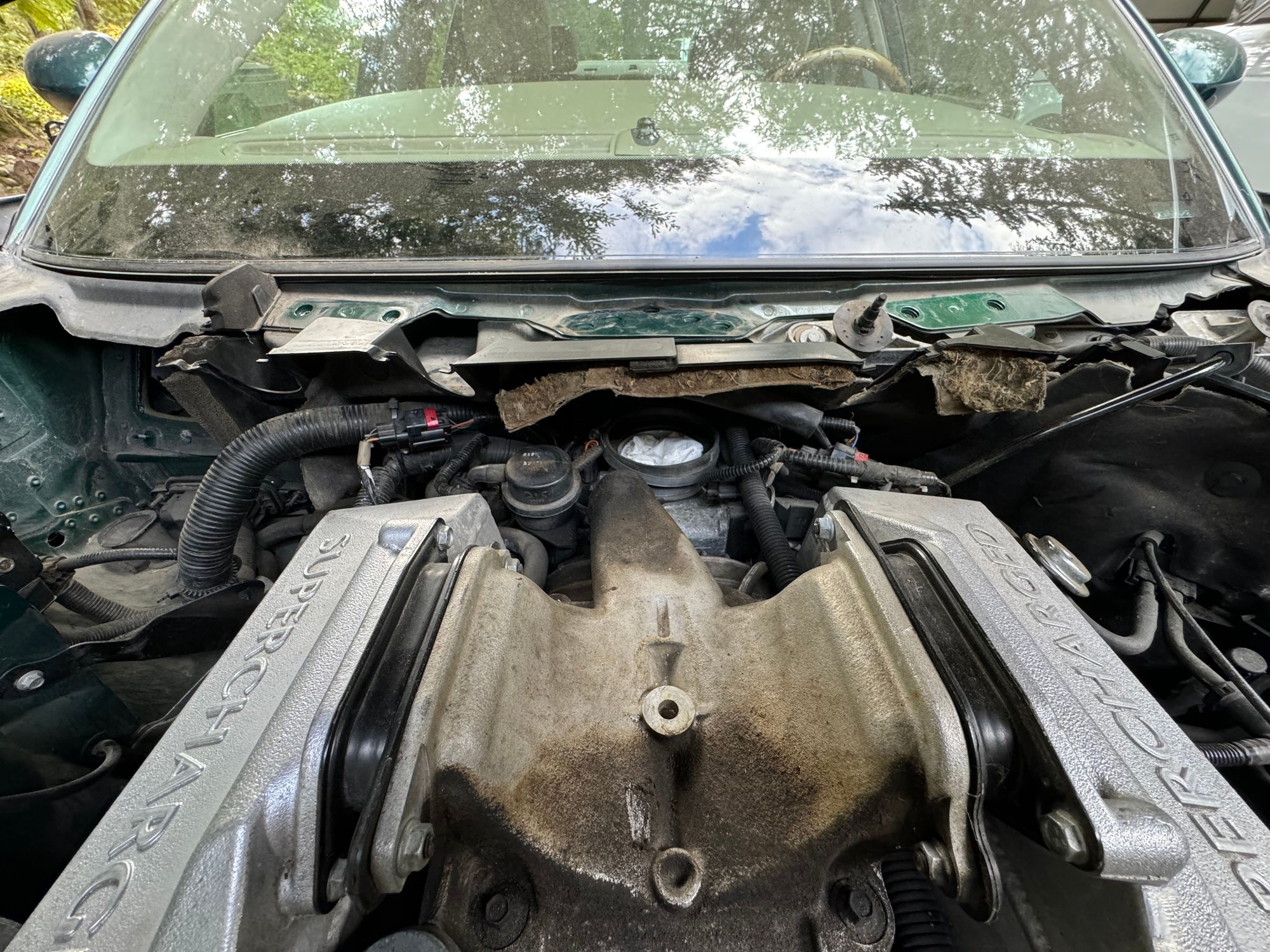

I'm stuck once again. I can't seem to get this false bulkhead out. I just can't figure out what's holding it in place. Also there are some really screwy metal fasteners that just push onto threaded studs. They only go one way and don't seem to come back off. How do you remove them without destroying them?
Do the hoses on the firewall have to be disconnected? I can't see them and can only feel them. I really dont want to disconnect them as I'm not sure I could re-connect them later.
Is it possible to do this job without removing the bulkhead? I was feeling pretty good about what I have done so far, but a feeling of unease is settling in. I think I've made a mistake tackling this, but there's no turning back at this point, I have to press on. I think this thing was designed by a real sadist.
The manual lists about 40 steps to remove the bulkhead and includes things like disconnecting fuel lines and A/C. I haven't heard anyone else mention that here. It also mentions a lot of parts that I don't know what it is referencing. The pictures done seem to match up with what I'm seeing either.
Sorry if I'm sounding negative, I'm just getting very frustrated.

Hi Mr White,
I feel your frustration! I had that as well. I wish I could give you some pictures of what I did, but my car is RHD, so the arrangements are slightly different. That said, the manual has a number of steps, and it covers all the variants, from the 3.0V6, the 2.7 diesel to the 4.2 NA and the 4.2 SC. If you do a search on the word 'supercharged', that word often appears before sections that cover the SC cars. What I did was print the whole section, and go through it carefully and cross out all the parts I knew didn't apply to my car (2008 SV8). I didn't evacuate the Aircon, as the pipes for it mounted to the bulkhead below the secondary plastic bulkhead.
The RHD cars have the heater hoses cross from right to left across the car (as always left and right as viewed from the driver's seat looking forward). The heater hoses come from the lower right side of the engiine bay and then move across the bulkhead. For LHD cars like yours, they only go a little way across then are fitted to the bulkhead. For RHD cars like mine, they go all the way across to the left side and are connected to the heater input stubs on the bulkhead.
I too was daunted by removing the heater hoses, which lead to me breaking some plastic hose parts as I heaved on the pipes. A very important tool is the remote hose clamp plier. This allows you to push the operating end onto a hose clamp that is buried behind other covers, and release it. It's essential for this job as there are a lot of hoses, and most of them are impossible to access without it.

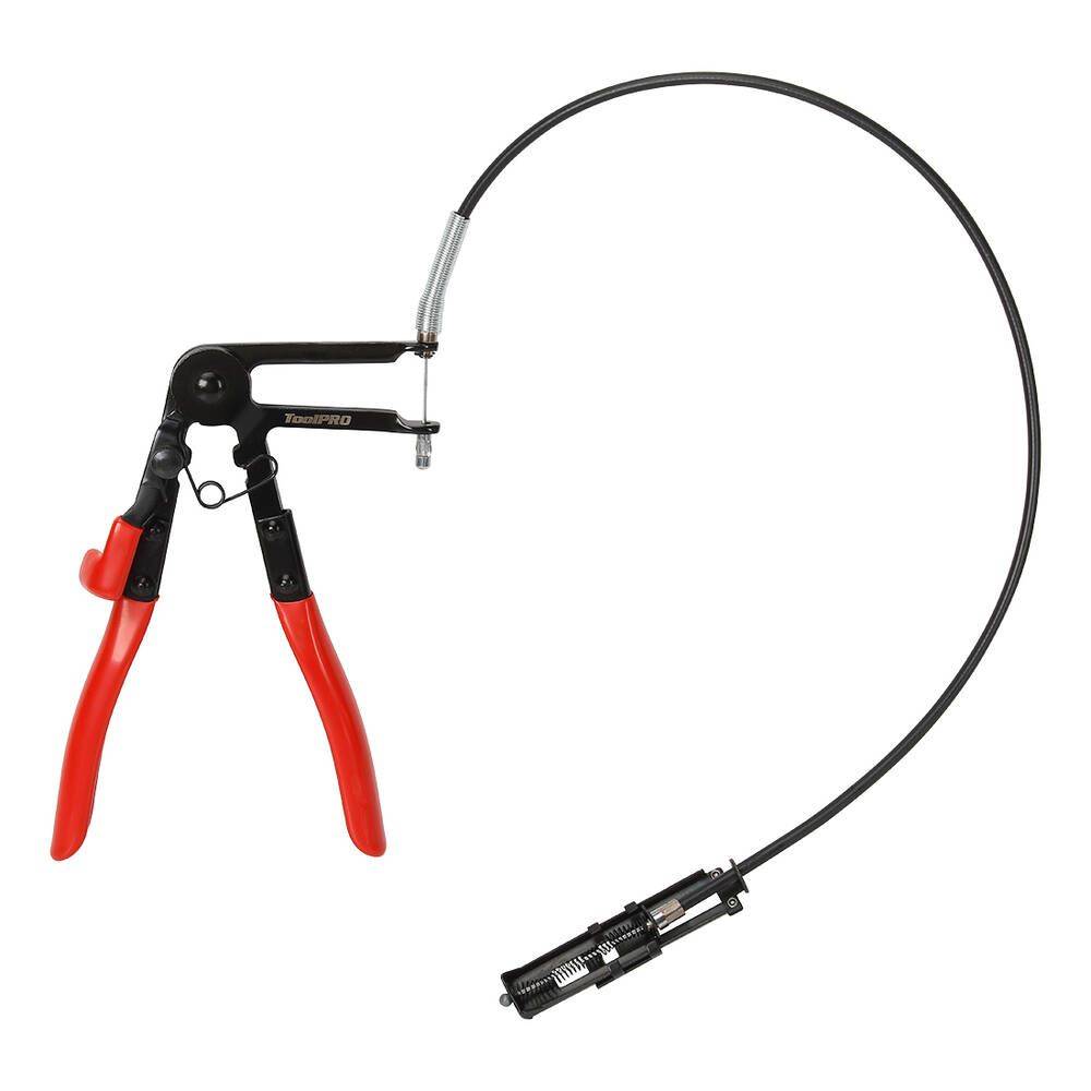

Remote hose clamp tool
If you remove the heater hoses that mount to the bulkhead, you should be able to push them away from in front of the secondary bulkhead you want to remove. It is also necessary to take off the center bracket between where the fender braces were. Do you have two fender braces or four? Early cars had four, but the two inner ones were later deleted. The bracket the inner ones mounted to has to come off as the secondary bulkhead mounts to it so prevents its removal.
The screwy metal fasteners should be able to just pull off with the assistance of a trim tool with a forked end. You push the tool in behind it and push it up a few threads. Then you should be able to unscrew it. A bit of panel beating and you can use it again. My car had plastic expanding rivets that I had to pull out the center piece to unlock.
You do need to unclip the rigid vacuum hose from the throttle body to the brake booster. There is a joiner in the middle that must be squeezed to release it. It looks like there are places to squeeze, but it's a trap. You have to squeeze at 90 degrees to those.
There is also a wiring loom behind the throttle body that has a plastic cover mounted to a bracket on the engine. Remove the small nut securing it and pull it toward the front of the engine. That will give you more space to move the secondary bulkhead.
Have you looked carefully through the 'into the valley' legendary post (thanks so much to that poster!) from some years ago?
It was for a LHD car so may be useful. I made it into an MS Word doc that I will attach.
I'm sorry if you've heard all this before, I lose track of those who are going through this.
Keep at it. If I can do it, anyone can.

Hi, Mr. White.
Pete M, Thomas S, & others similarly came to my rescue.
Those funny fastners just knockoff with a screw driver. If you find my thread on the subject, you will see I had all the questions you have except that I had found the busted hose when I removed the ICs.
If memory serves me, I only had to remove the 2 black soft heater hoses. The remote clamp remover is a must; once I became familiar with it, I was fascinated by it & was amazed by what it could do.
I, too, thought that I had to take things off that I didn't because I was reading about a different engine. I was so frustrated that I almost asked a young friend who heads up a significant part of AI for MSFT to task his AI tool with the job of writing a manual for what I was doing. He loves such challenges - he did a similar, but a bit more complex, project for teaching neurosurgeons! But, the wonderful guys on this forum saved the day!
My schedule is not my own today, but if I can get a few minutes, I will find my threads, very similar to yours, & send them along.
I would not fret over replacing the valley hose or any other hose for that matter. I should have photographed the hoses I removed before I tossed them. Many were on the verge of failing. Now that I have replaced them all, I have peace of mind...
Just drove her over 100 miles & won't mention at what speeds. I am so glad that, thanks to the help of the fellows on this forum, i persevered...
I still haven't replaced the wipers, the bottom cover, etc. Thankfully, we've had no rain in months & aren't expecting any. Hope to get back at it in a week or two.

I do have a set of the specialty hose clamp pliers. I ordered them before I started the job. They are invaluable.

I figured out how to remove the strange press on fasteners. I used a long handled screwdriver with a small flat tip. Put it into one of the gap/slots in the fastener and twist them off.
I have removed all of the fasteners that I can see. It should be loose at this point, but it isn't. I have not yet disconnected the hoses as I was waiting to do those last. The hoses that I can see are on the left in the below photo, just above the big wiring harness. I can understand why the plastic bulkhead wouldn't be loose on the passenger side if the hoses are keeping it in place, but it should be completely loose on the drivers side. I've removed all the fasteners, but it is solidly held in place. It's not budging at all, it's like it's screwed in place from behind. At this point, I think im going to go to harbor freight to buy some trim removal tools and try prying it out.
I don't know yet how I will get to anything behind this massive electrical harness, but that is a problem for future me. (once I figure out this bulkhead)

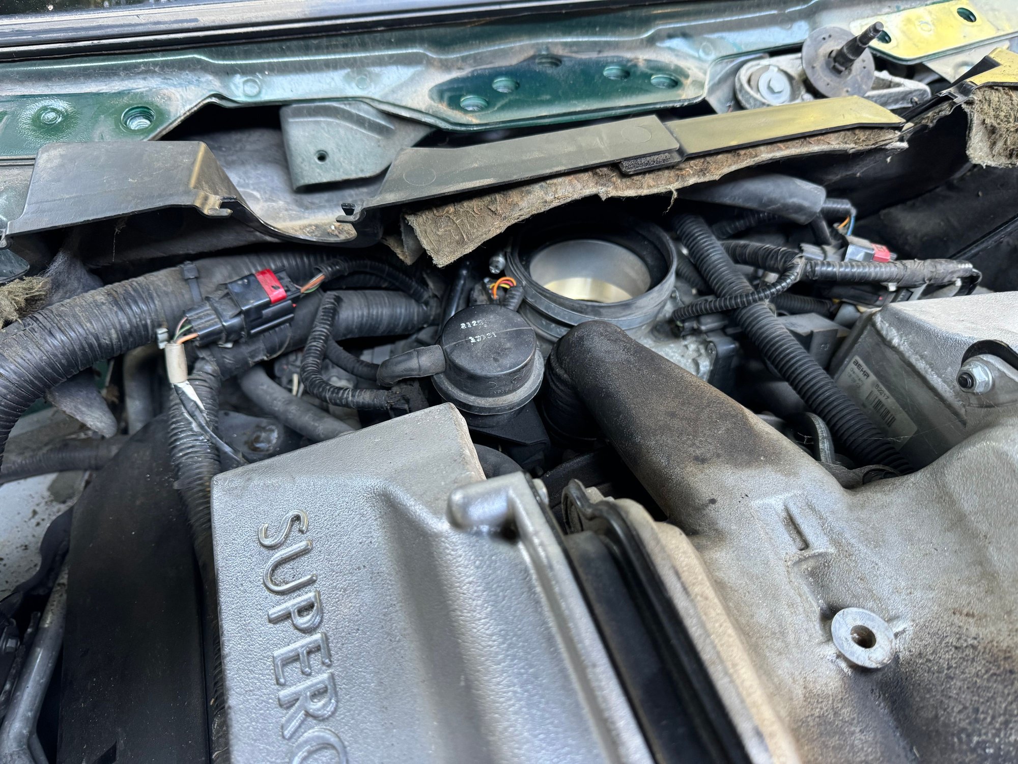

I removed the insulation from the bulkhead. Can't recall if this revealed more fastenings.

Ding, Ding, Ding, Ding.. Winner Winner!!!!!
I had really been trying to keep the car as original as possible. But with all this tugging and pulling the insulation was really starting to disintegrate. I finally decided to rip out the insulation and found about 5 more fasteners. I now have the bulkhead out.

Hi Mr White,
That's great news! You could probably glue the insulation back onto the bulkhead. The extra room really helps when removing the intake elbow and the EGR valve.
That bulkhead was one of the most difficult parts for me. I'm sure you will find the rest of the process straightforward.
NB, take lots of progress photos, it's amazing how quickly we forget how it went together.

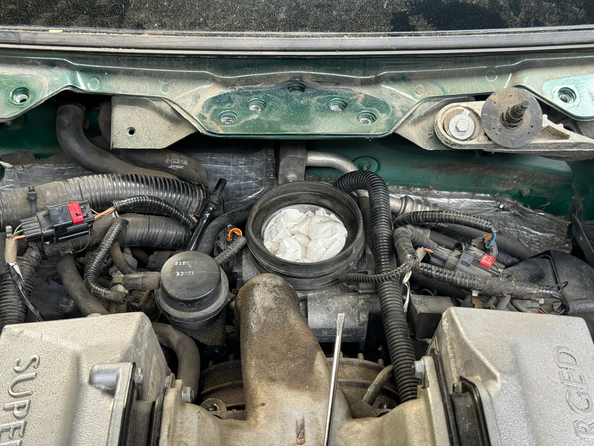

Guys, sorry for going silent for a few days. I've been very busy at work and haven't had time to touch the car since Saturday.
I have the throttle body out, so the next thing is the EGR. It's hidden below a bunch of wiring, so that should be fun. But... I feel as though there is light at the end of the tunnel. By the way, I did not have to disconnect any coolant hoses to get the plastic false bulkhead out. It is notched around the hoses.
I am going away for a few weeks, and had really hoped to have it all taken apart so that I can figure out what parts I need to order before I leave. Hopefully I can get this done in the next two days. I will of course then have the fun job of trying to put everything back together a month after taking it apart. I'll try to update tomorrow with my progress.
