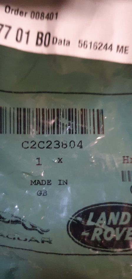

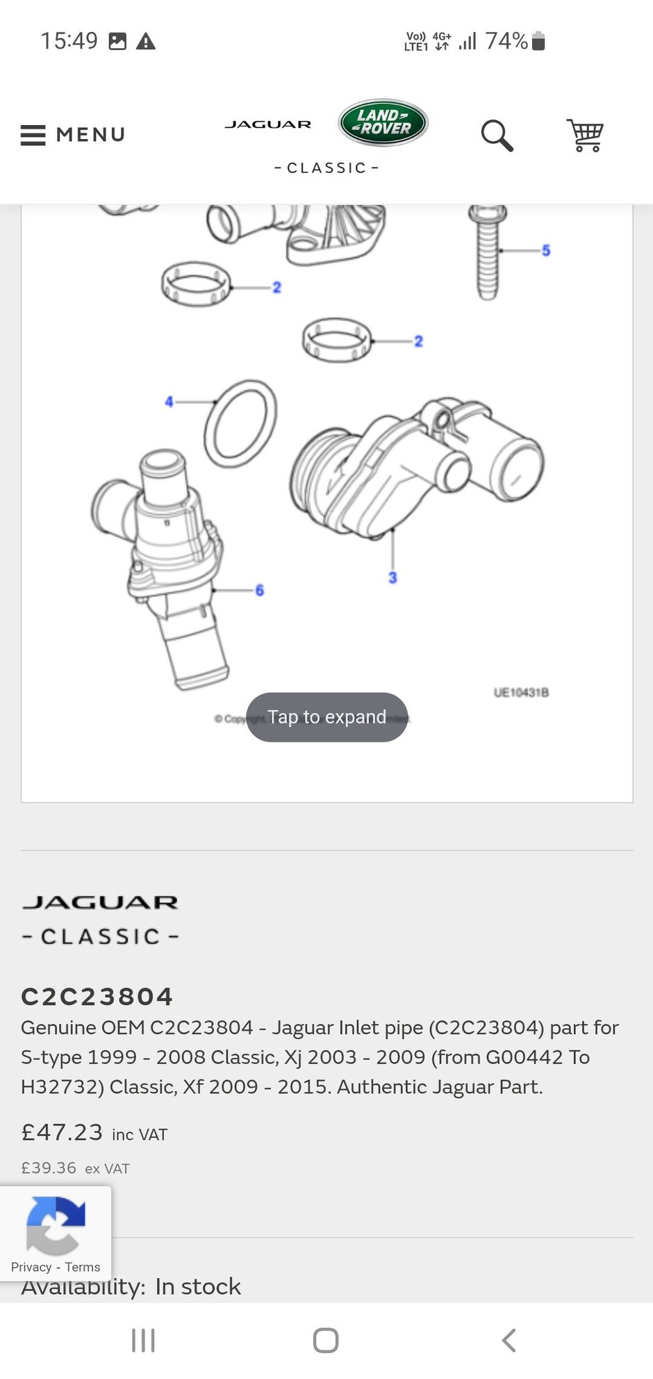

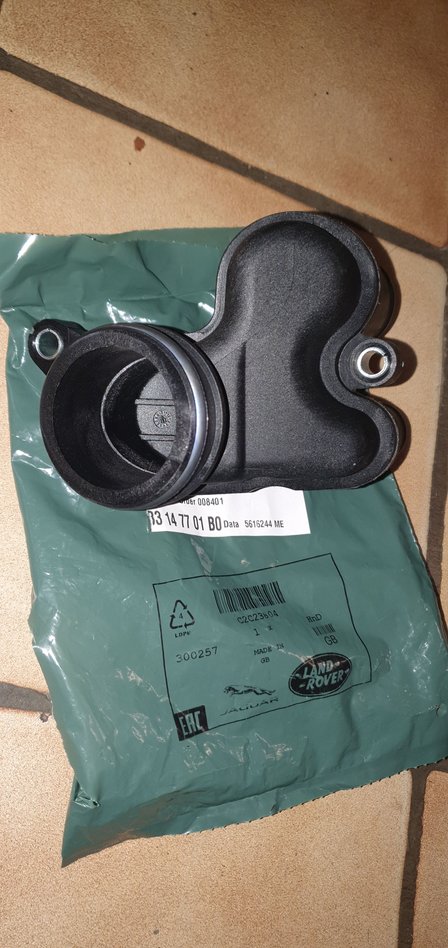

Known place where these engines leak towads the rear left side of engine especially when warm and down the hoses towards auto tranny .
just behind servo oilpump and climate pump in the front is the coolant inlet to the engine. Crap piece of plastic with one bigger O ring just held by two screws . Left side of engine.
You will not be able to see it without camera.
I will post a picture if I find it
